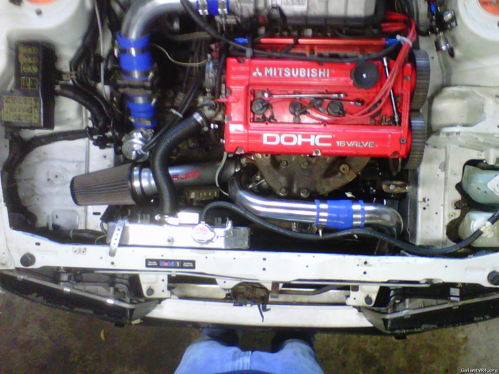

I have an ETS kit on my car, This is a decent picture to show the room you have to play with.

Tre3zy, the manifold to turbo bolts are visible in the pic, if the tubular mani projects farther out than the bolts do, I'm not sure if it will fit.

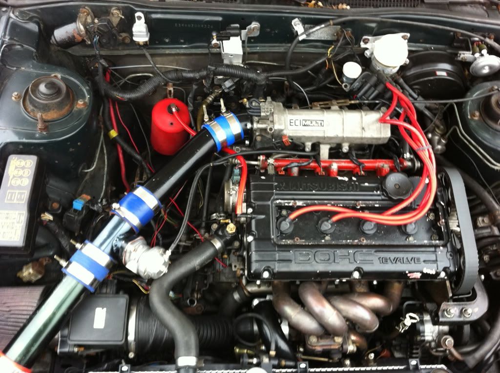

I have a tubular mani, I dont like it. I want to get an FP for mine. Ill put a pic so you can see the difference.
PS - I know the engine bay looks like sh*t. Its how I bought it and is a work in progress to clean up the nightmare.
