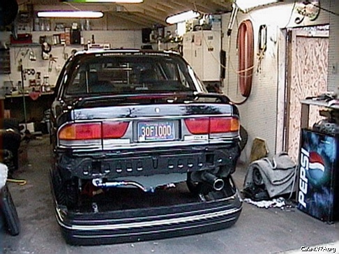

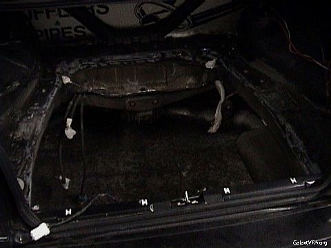

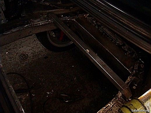

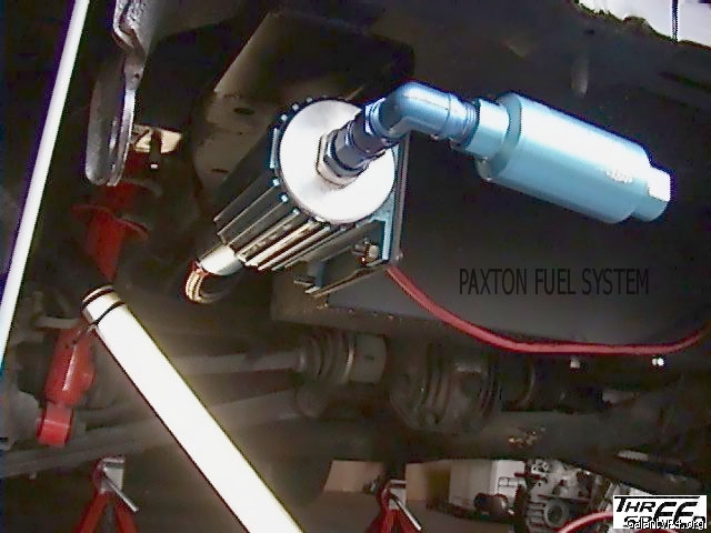

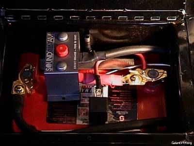

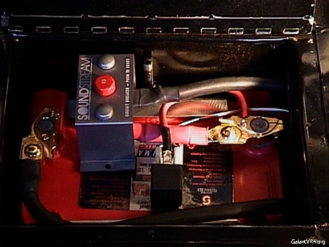

It has been a while but I am pretty damn sure the gas tank follows the hump in the trunk floor. So cutting just the floor hump will not gain you much.

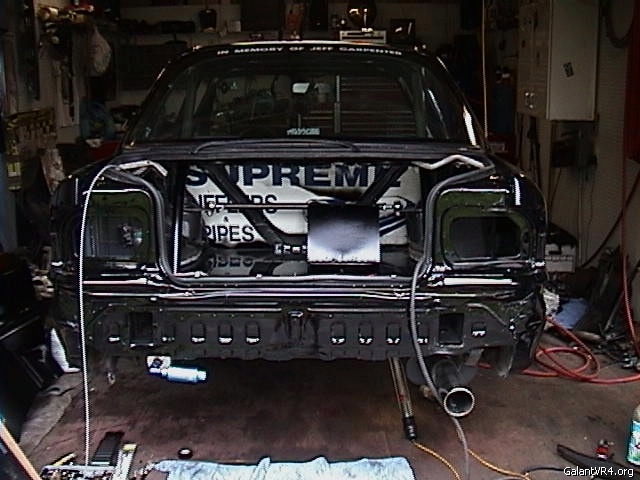

Forgive the quality of the pictures. They are going on 4 years old and good digital camera were unheard of or very expensive.
My first time using a plasma cutter.
Added metal back (boxed in) to the rear structure (above the diff) I was using the square stock to check eveness and for reference points it is not part of the trunk
Ralph O'neil the guy who welds the mounting tabs to my SSSS' did the awesome welding/bending work.
Added square chromoly stock to create frames to add stiffness and mounting points for the two storage containers, fuel cell and of course the new flooring.
Here is the battery compartment.
Here is the custom made 14 gallon fuel cell I designed just for number3 including a OEM sender.
Here is my custom fuel pump mount and you can see the 2 storage compartments (the fuel cell is removed in this shot) that hold my battery, my helmet bag, a CD changer, and a can of fix a flat.
This shows the lack of the fuel door thanks to the days of work by my friend and bodyman Bob Brown.
I hope that was helpful. I can let my imagination get wild sometimes but in the end it was worth it I think.
