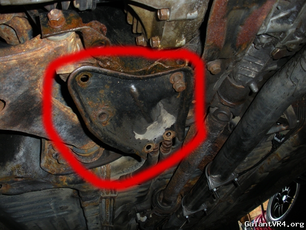

triangular black gusset plate.. leave it off?
So im just wondering how many of you actually replace the gusset plate after installing your trans or new pass axle? Ive always replaced it on customers cars just because i would hate for something stupid to happen. I just dont see the point of putting it back on unless it does something significant.. Here at my home i dont have air tools so its a major pita to sit there and crank them out and in and i just had my trans off again and i figured id post this up to see how many of you run without the plate. I also attached a picture of it for refrance. Thanks in advance

Keep it! They were installed from the factory for a reason and are there so the subframe doesn't crack under load. Ask me how I know
sounds good lol i was looking while it was off and realized it looked like under a launch or something the subframe may try to flex without it. Thanks guys /ubbthreads/images/graemlins/wink.gif

The control arm takes it's hardest stresses under braking and cornering so that's where it would suffer most from lack of support. The only reason to leave it off would be weight gains and it's just not worth it for a few ounces.

:Mines been sitting on a shelf in my garage since I owned the car. When I got it, that piece along with the tranny was in the trunk, and I never had the correct bolts for it. Never had any issues. /ubbthreads/images/graemlins/dunno.gif

I don't know if amount of millage has anything to do with it. But that plate is very important definitely don't drive without it.
Quoting bustedsm:
+1 Ask me how I know. Or well just click
