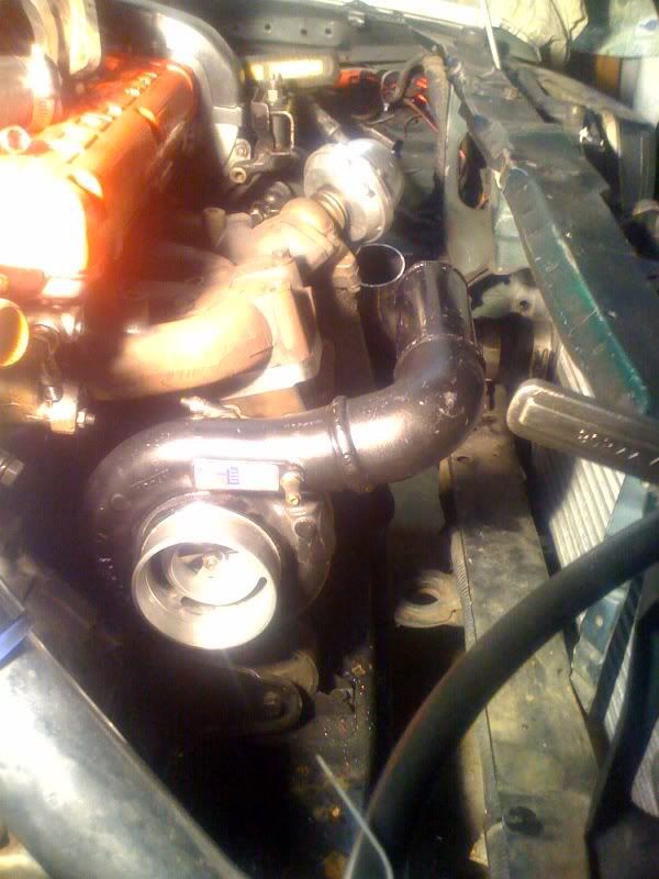

Heres a pics on my hx35 that im still trying to set up.
Its almost impossible to run full core radiator but its doable. Im runnung a 1g mishimoto radiator that tucks under the support. Might be a little different since your going with the T3 but its just an example.

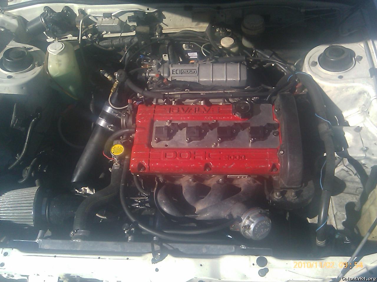

i have used a similar style manifold, bought mine off slow boy racing but the same, you can keep the ac but will have to push your condenser in and also your radiator and the wastegate is gonna be almost touching the radiator, i was running a t3 gt3076r turbo but was down firing not over the top like yours with a ets vr4 intercooler setup, your will have to run good aftermarket fans not cheap sh*t as it will overheat, i ran spals
