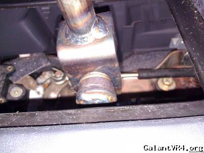

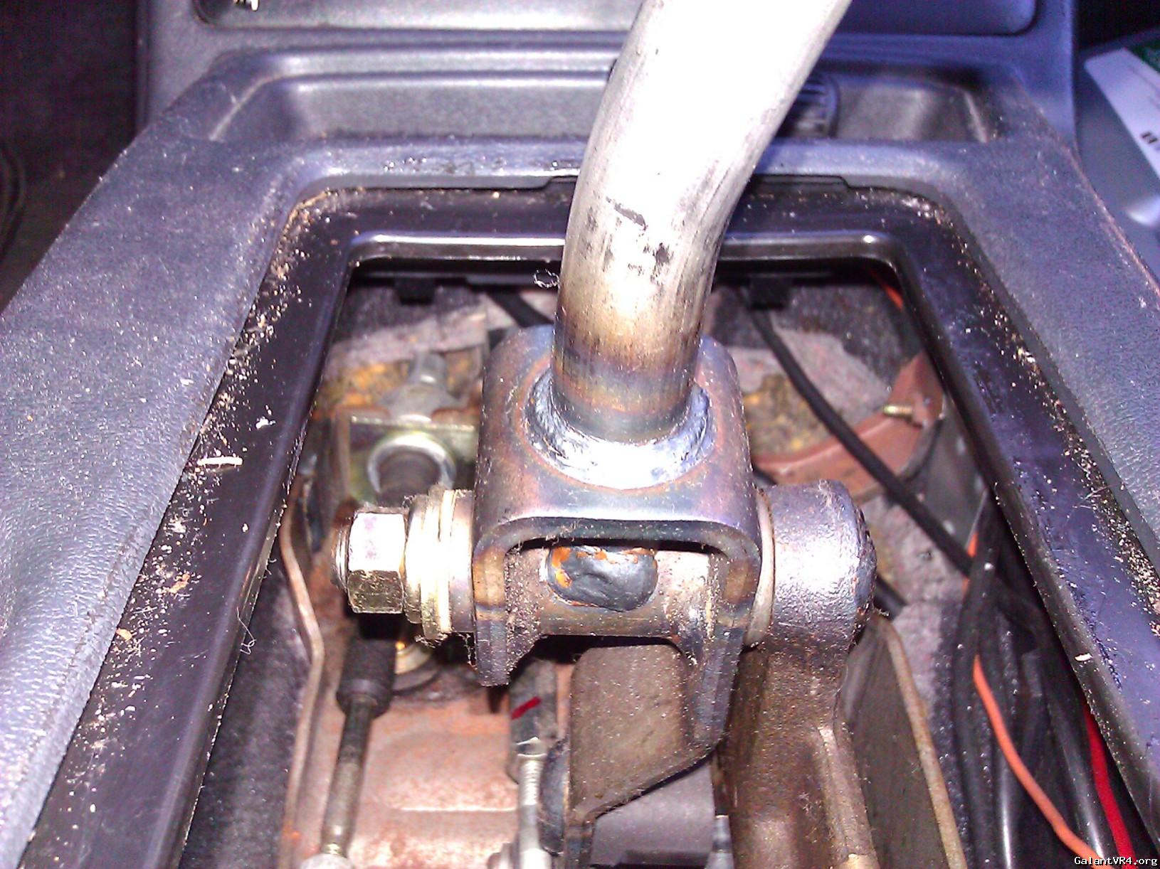

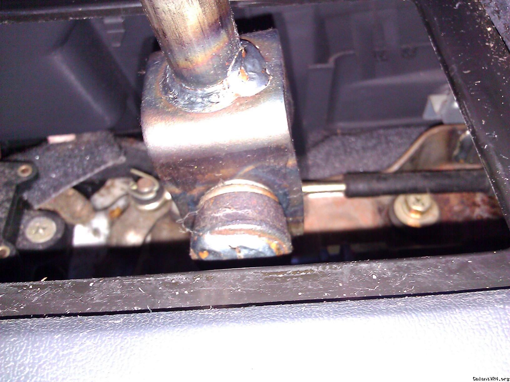

im posting a picture of my shifter it looks to be...different. hard to explain.

Any chance you have a 90 tranny?!? The linkage arms on the tranny are different from the 91-94 boxes.
Can't remember off the top of my head but your symptoms seem to be related to the item above. Check the VFAQ and maybe a search here for more.
EDIT, I found the link: click
