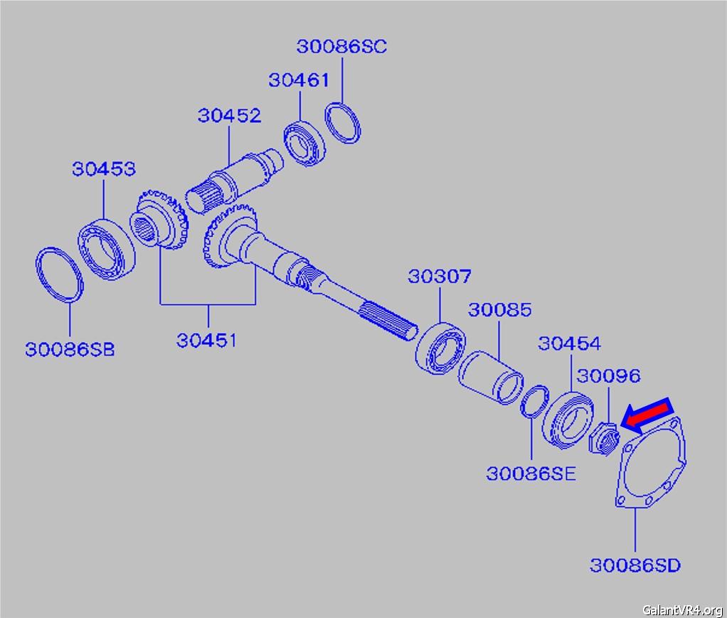

I searched "Transfer Case + Recall" and got pages of everything but. I looked in CAPS but it doesn't show the kit. I posted in the For Sale section, WTB and got no responses. I looked in the Part Numbers section, but it isn't listed, so does anyone remember the part number for the recall kit, as I guess I am going to have to buy a new yoke to use for my fixture to remove the nut on the main shaft of the transfer case.

Thanks guys! I just need the yoke. I need the yoke to put in a vise to hold the main shaft to remove the nut. I want to rebuild the transfer case and I need to remove the nut, so I can change the bearings. There is no way to hold the shaft. I thought if I had the yoke in a vise, I could keep it from turning. I have already ordered all of the bearings and seals from JNZ

I hide them in bags of ice cubes in the back of the freezer. /ubbthreads/images/graemlins/blush.gif It is the toaster oven she got upset about. She won't use it any more, so it is permanently in the garage now, so I won that small battle. I am hoping with the yoke, I can hold the shaft well enough to get the nut off without stripping the splines off the shaft. After I get it off, I have no idea what is next as far as disassembly. It is all housed in the intermediate housing and I can't see anything. But hopefully, I will be able to get that all apart and then I can start the toaster oven/freezer process and get it all back together.
