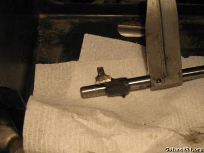

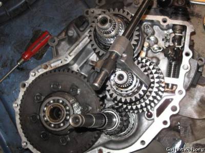

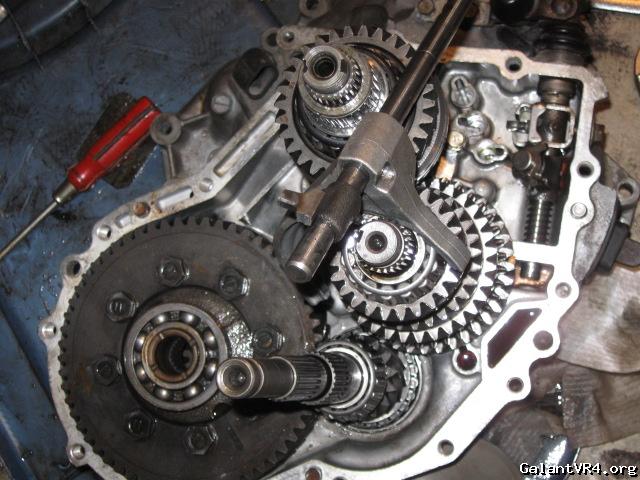

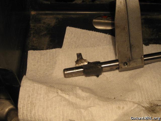

So I pulled the trans apart tonight and found the shift rail end was my problem.
No real carnage to speak of, the trans is pretty damn clean.
Im sure this looks pretty familiar... /ubbthreads/images/graemlins/hsugh.gif
