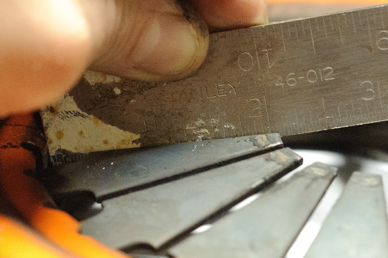

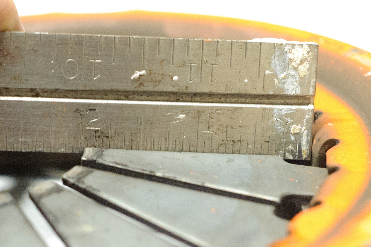

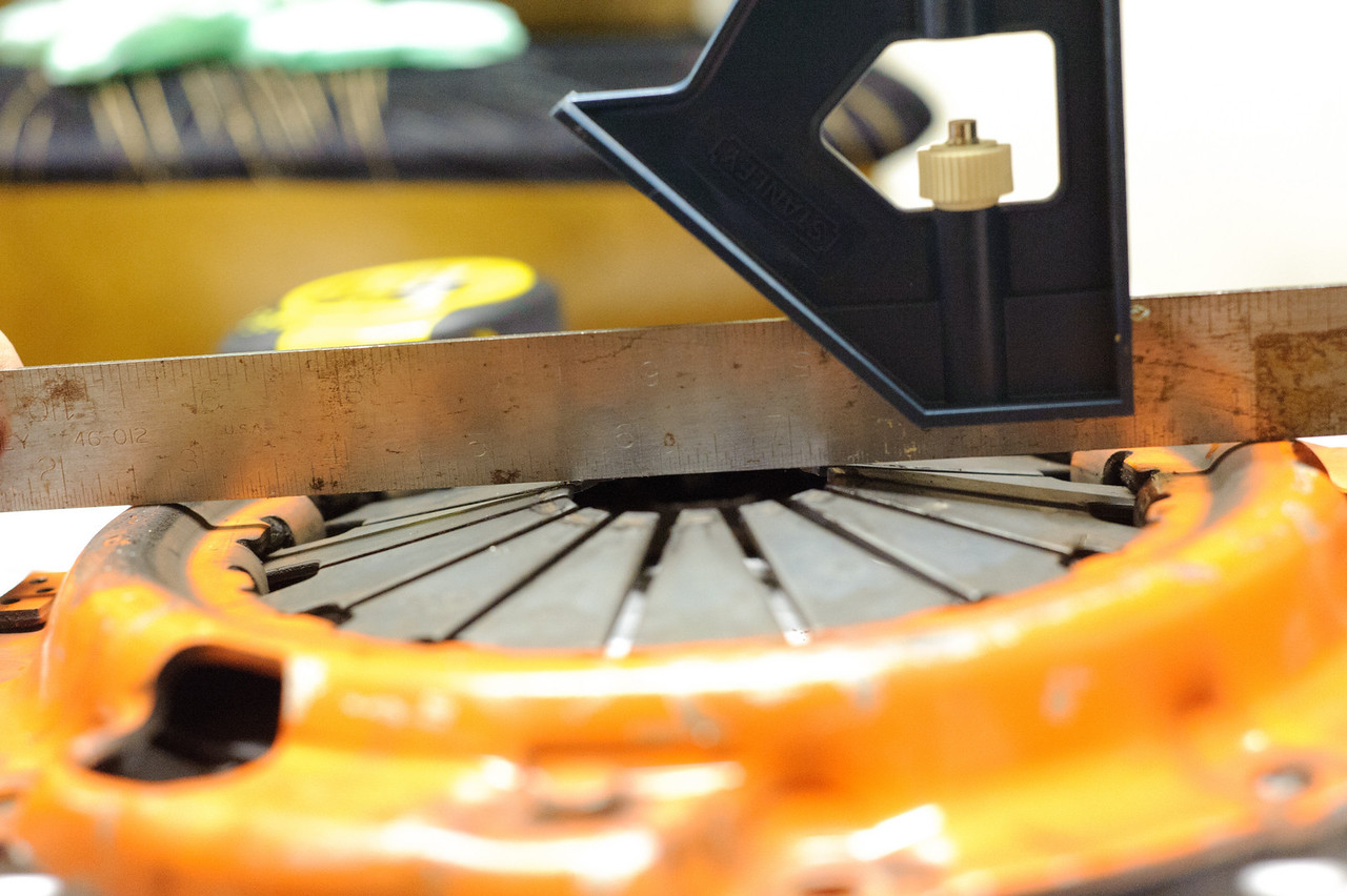

Found the problem,
I have never, ever, ever heard of this before. Add it to some kind of list!
15841299_Qfs64
gtluke
Sep 16, 2001
4,210
dirty jersey

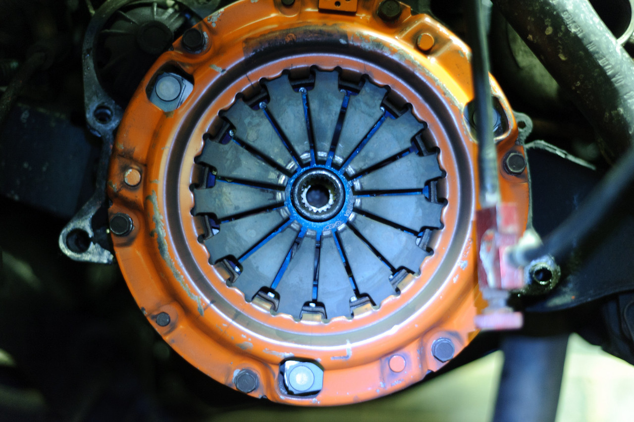

Quoting BarnesMobile:
I feel stupid. What is wrong?
That shot of the clutch on the trans is shot from dead center, look at the bore and the splines. But look how off the fingers are. The throw out bearing hardly even hits the one side of the clutch!
Barnes
Feb 9, 2003
6,249
Richland, WA
WTF?!?! That is a MAJOR manufacture defect. /ubbthreads/images/graemlins/frown.gif That is messed up.
