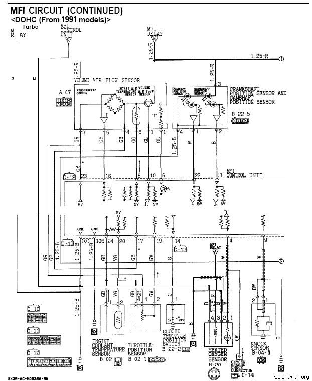

Okey, I have figured out that the TPS has no ground, but the wires to the ECU are good because I can read the TPS resistance from the plug on the ECU. So, the TPS grounds thru the ECU, correct? Can I check the ECU to see if the ground path is bad? Are there resistors, caps, or diodes on the ECU that may have gone bad? Thanks for your help.
There is a track on the circuit board which blows if there's a short somewhere. (you may have accidentally shorted something while doing your other work - it only takes a momentary slip).
Open up the ECU and, using a multimeter or other continuity tester, check for continuity from pin 24 through to pin 101 or 106. If it is not continuous, solder a small wire between 24 and either one of those pins under the board in the ECU to repair that burnt track. That is all you should have to do. Use insulated wire so it can't short to anything else and take care while soldering, specially if soldering isn't something you're very familiar with. If that track is blown, according to my diagram you should also be seeing an incorrect coolant temperature reading.

Thanks man. I figured it was the ground because I am seeing -75 deg. coolant temps. I noticed they both use the same ground. I will check the board today and probably be doing some soldering latter. Good thing I have some high quality, small gauge, wire laying around.

Well I check the ECU and sure enough the ground track from pins 24/17 to pin 101/106 is open. So I guess I will be doing some soldering at work tonight. We have some nice soldering stations there that are better then what I have at home.
Thanks for the the help with this. I hope to have her back on the road this week. Pending my original O2 voltage problems.
I just did a search and I have this exact same problem. I read this thread and I just figured out my ECU ground circuit is blown after checking for continuity, found none, alligator clipped from the 106 to 24 terminal on the board, came up with 0.5. Then tried plugging the ecu back into the car with the aligator clips still hooked up, TPS reads normal on my AFC, no more sputtering or black smoke, no more CEL. Ok so my question now is this, I dont really trust myself too much soldering the board, so is it possible to solder a jumper wire from the 24 to 106 terminal on the HARNESS and NOT the board? Or will this not work properly or cause some other type of problem? Just wondering if its necessary to mess with the actual circuit board and if the ground must jump through the ECU or not, thanks for any help.

I think as long as the TPS sees a ground it will be fine. I soldered a 26AWG wire between the pins on the ECU so my ground doesn't actually go thru the board. It all works good for me.
