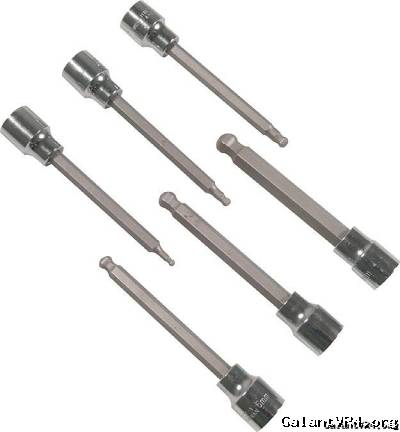

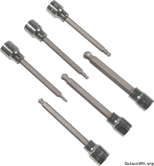

FlyingEagle
Mar 5, 2005
1,635
THE Ottawa
I installed hex socket head bolts in those tps spots. Then use a long set of extended ball socket hex bits to access the bolts from just above the rocker cover.
Like these:
