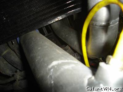

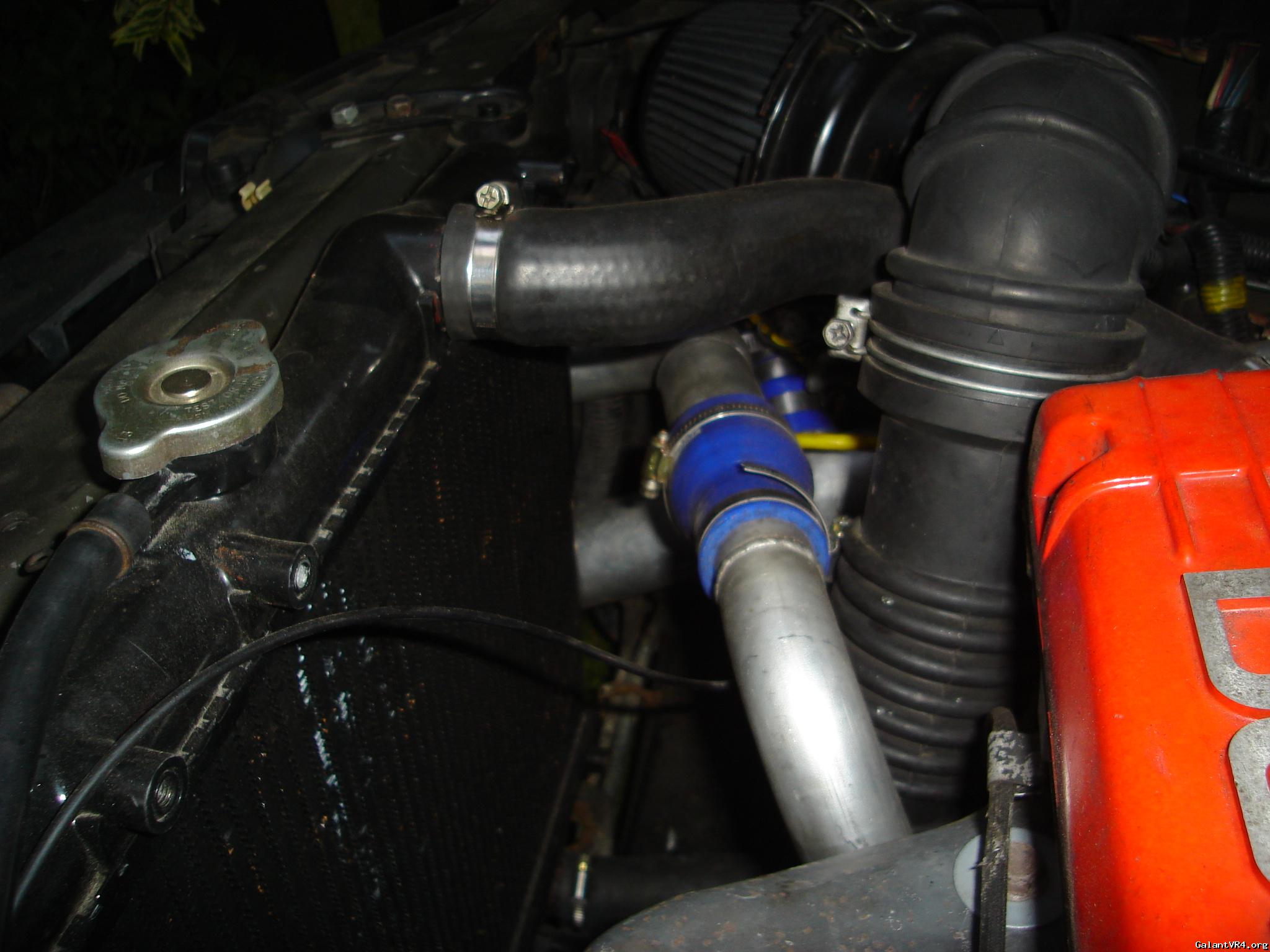

I had one a while back. 2" pipes, shifted the radiator all the way to the cam gear side and ran both the pipes around on the gearbox side. I can't say it really made any noticeable difference on the 14B /ubbthreads/images/graemlins/dunno.gif Might have some photos on the other computer.

This must have been when I removed the intercooler to go to the larger one I currently have. Oh the memories... /ubbthreads/images/graemlins/grin.gif

Thanks for the pics man, that gives me a little better idea of what to expect. Did you move the radiator in order to avoid cutting the core support, or was there simply not enough room? Also, did you have to trim the bumper beam?

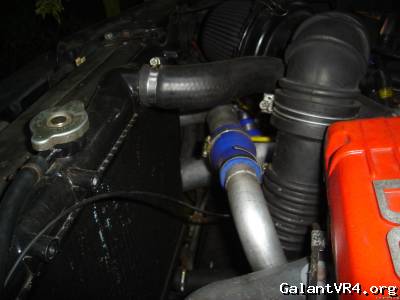

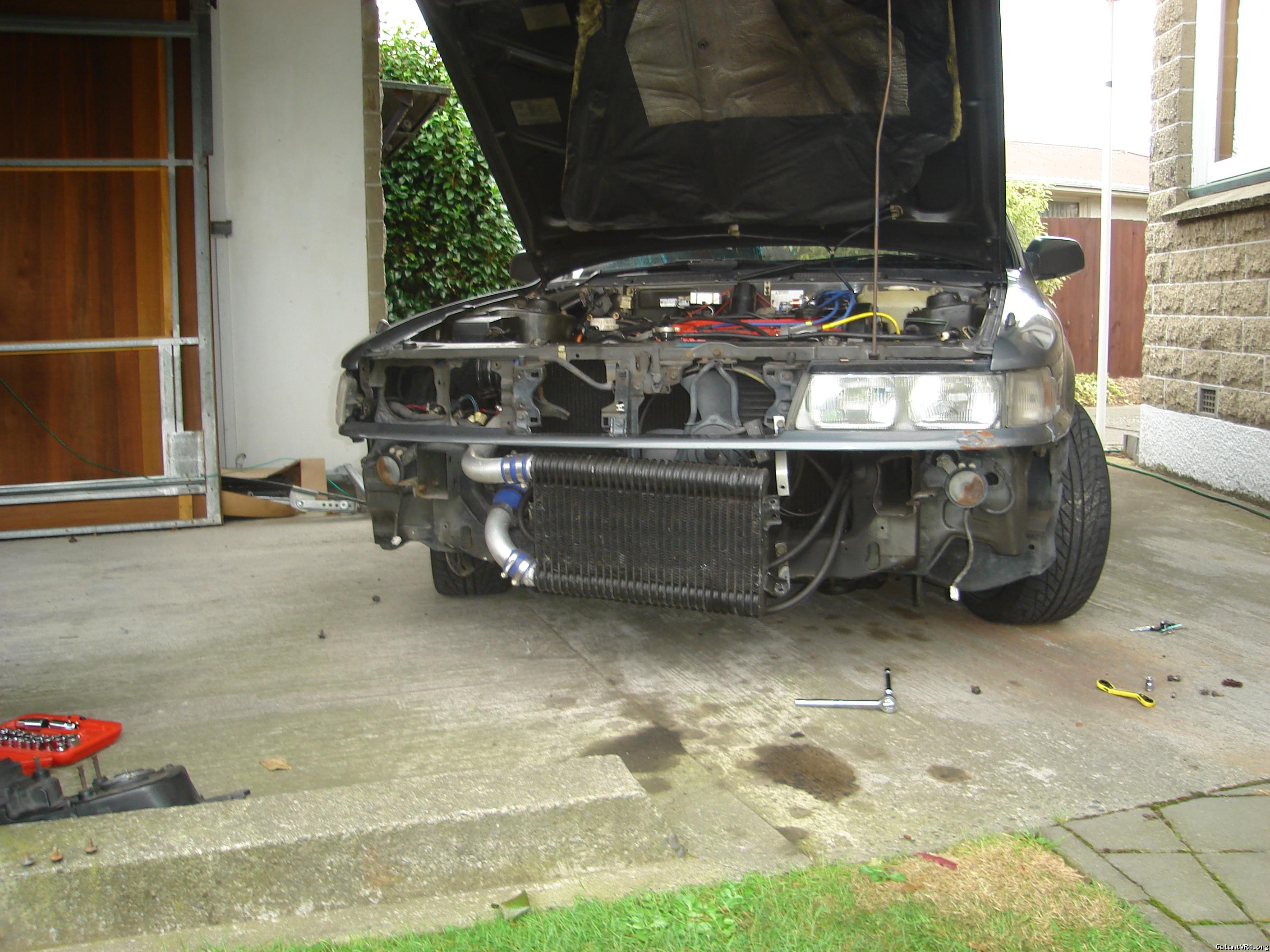

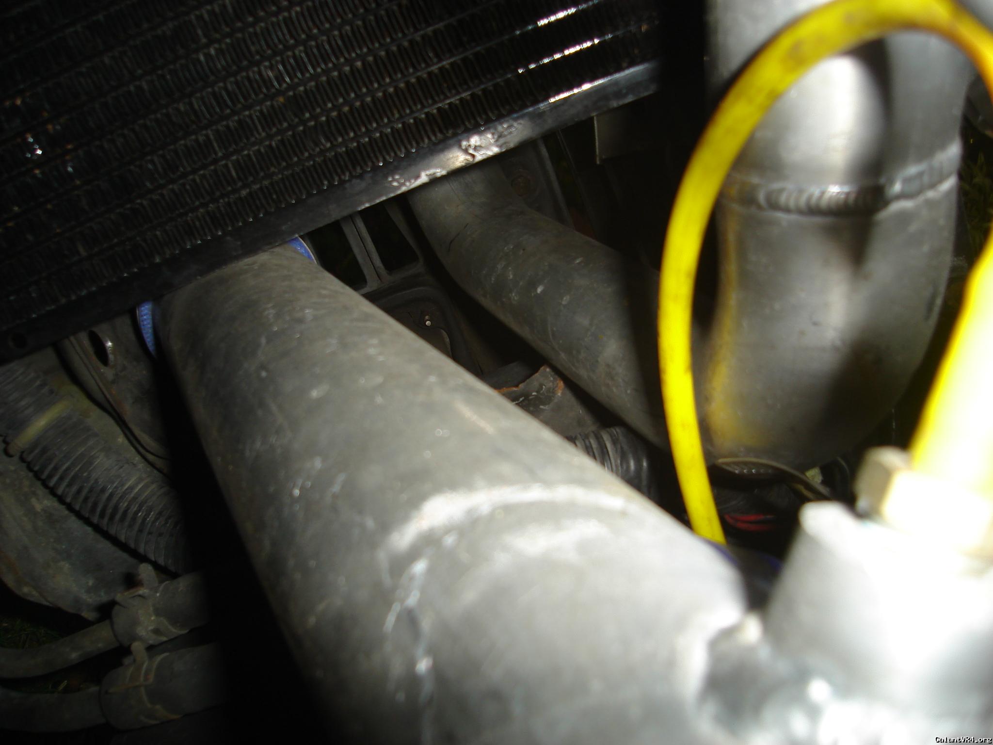

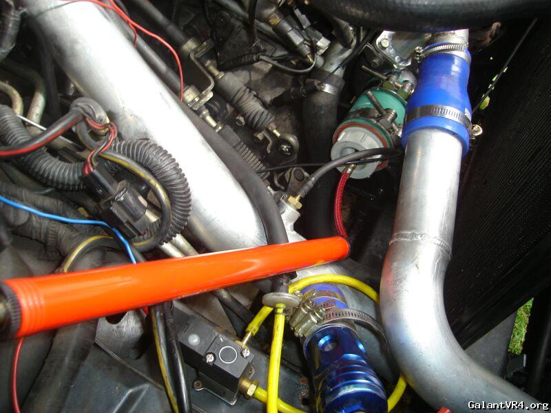

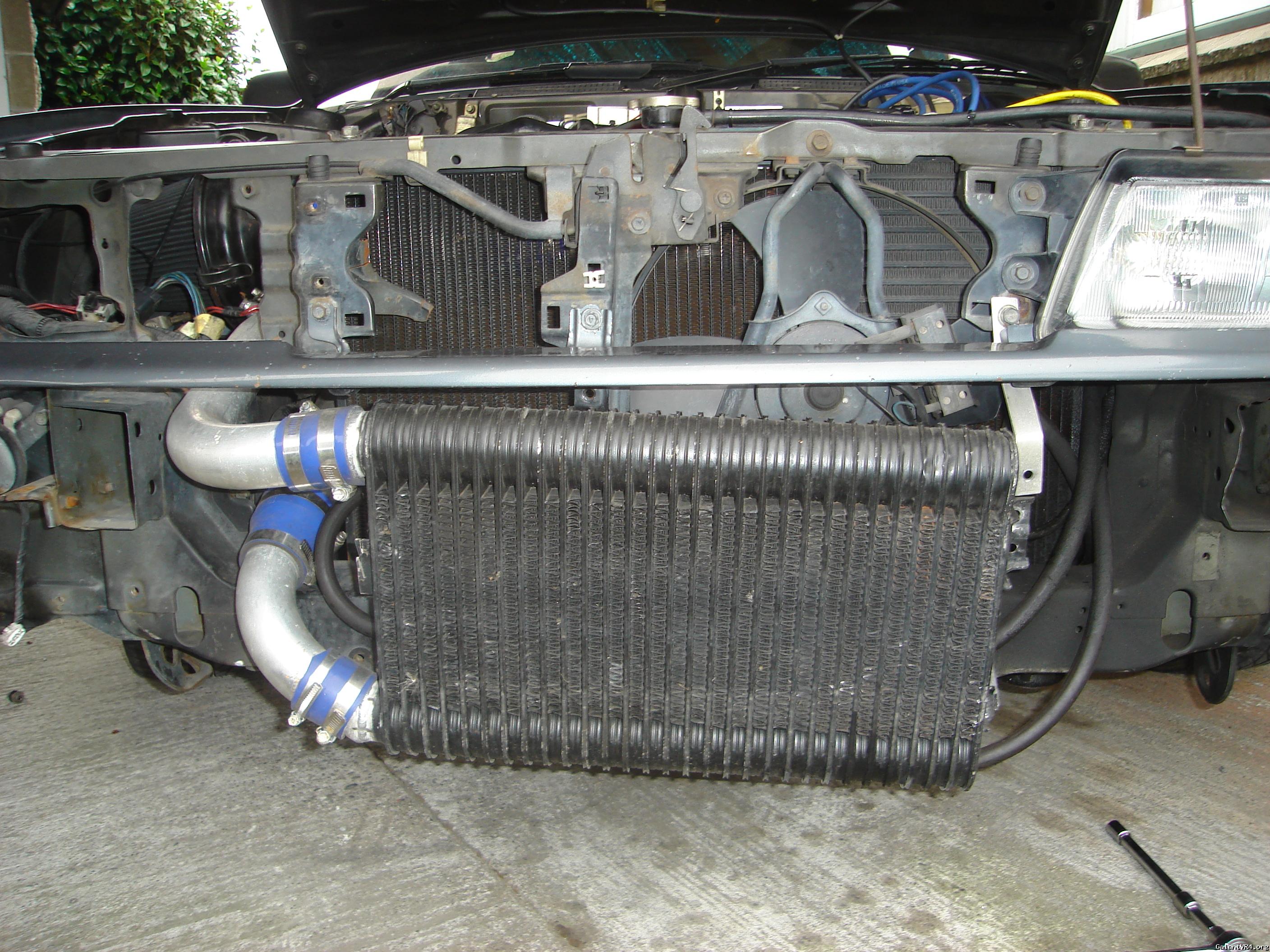

Thinking about it again I actually had a 2.5" pipe almost all the way from the cold side to the throttle. The radiator had to shift for the pipe to clear between the frame and the radiator. There may have been some issues with the support for the headlight but I think that can be avoided second time around.
I had to relocate the factory oil cooler and remove its mounting bracket & The JDM bumper had to have a little strip trimmed out of the support frame, but that could have been avoided.
Redtwo and Luke, thanks for the pics, I think I have a much better idea of how it's going to work now. I'll have to get this bumper off and really start taking some measurements. I have to get the front end off to install this b&m oil cooler I have laying around, anyways! =)
