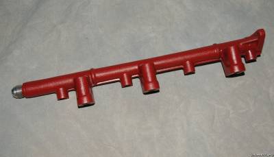

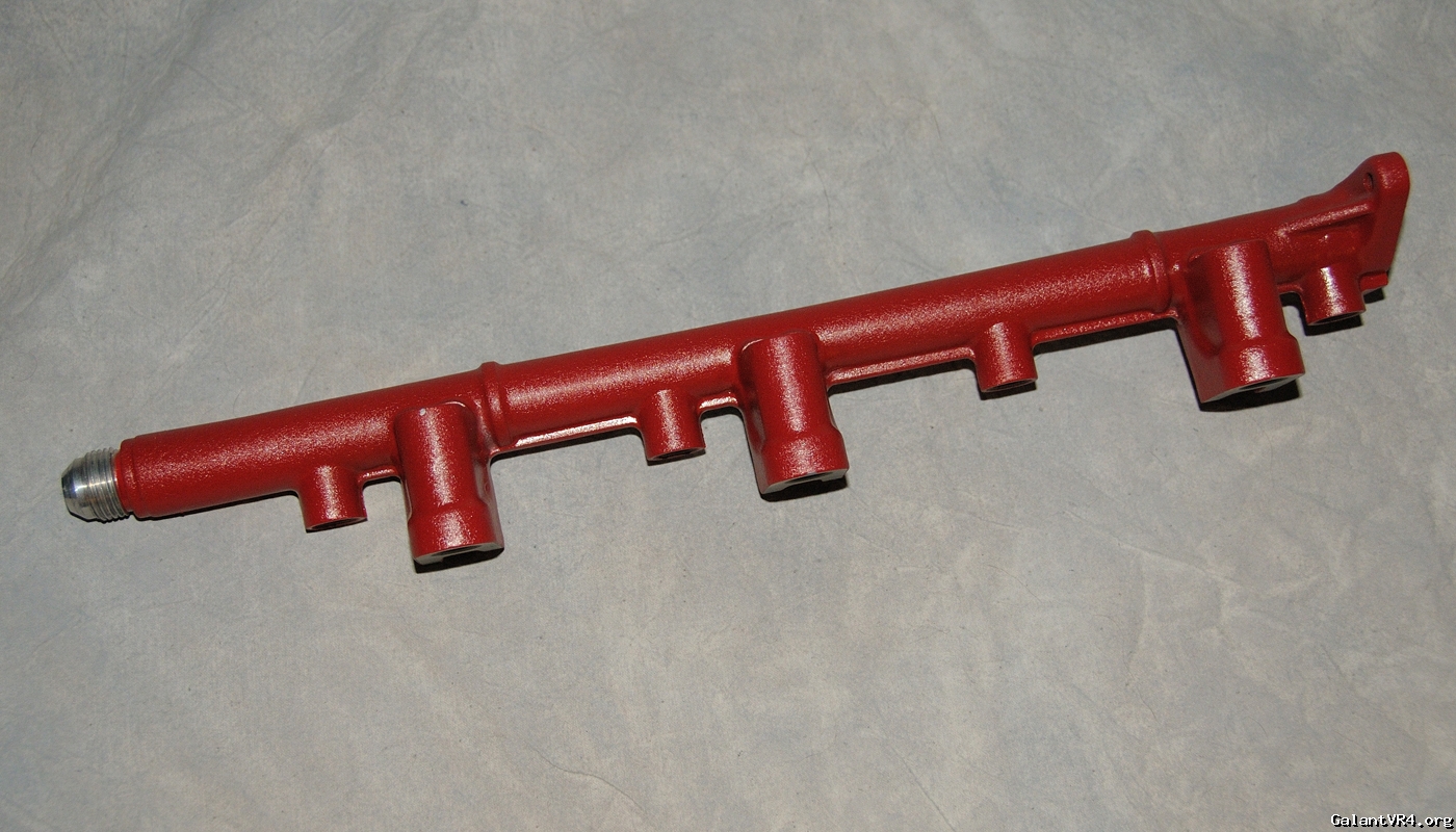

I'm doing a bunch of powder coating tomorrow. Of some very cool stuff. I'll see if the owner will let me post some photo's. /ubbthreads/images/graemlins/devil.gif By the way the owner is on here and makes some VERY cool stuff. /ubbthreads/images/graemlins/cool.gif

I'm guessing a newer member who makes his own FPR mounting blocks?
If one in the same we gotta make him churn out more of those beauties....

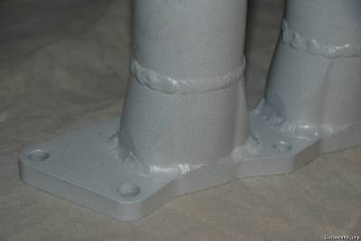

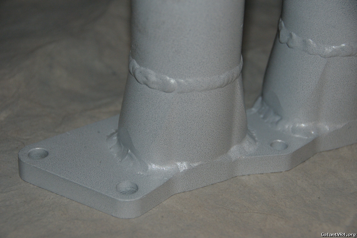

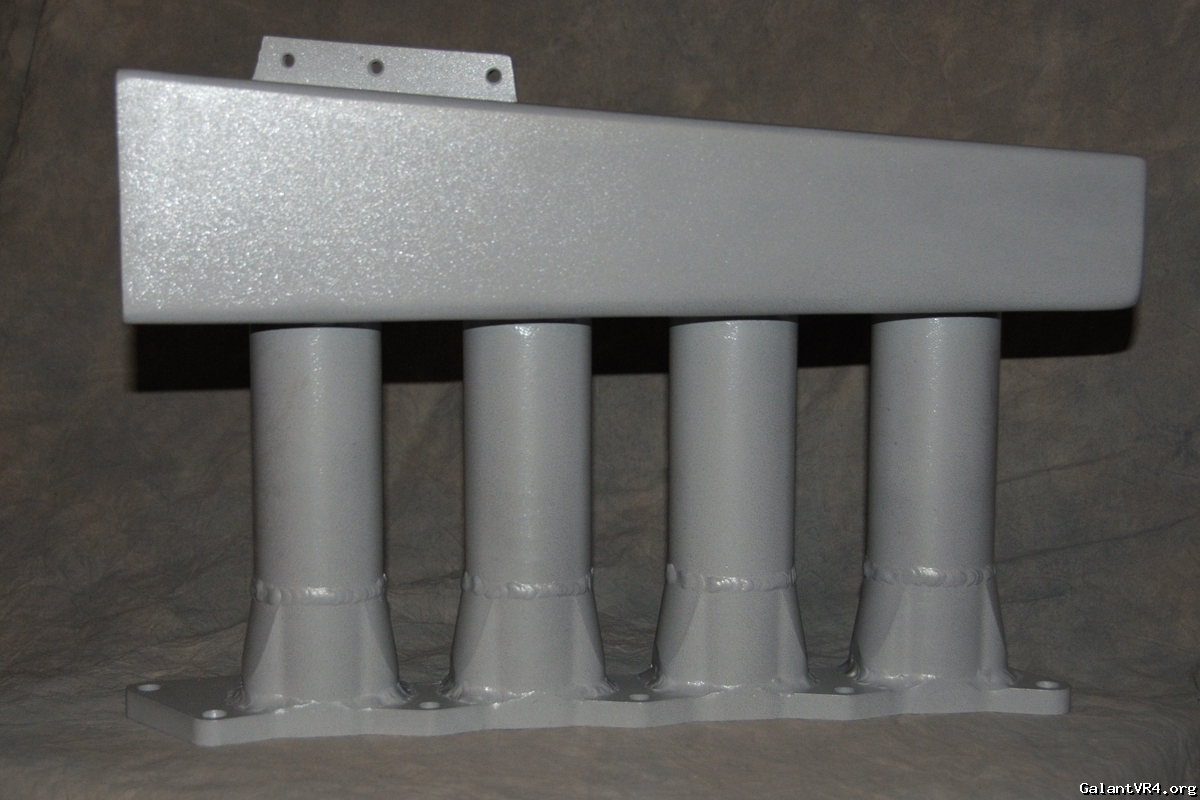

Now for the cool thing. Most of us buy an intake when me want one. Billy decided to build his himself.
The runners were made as long as he could to get some more torque.

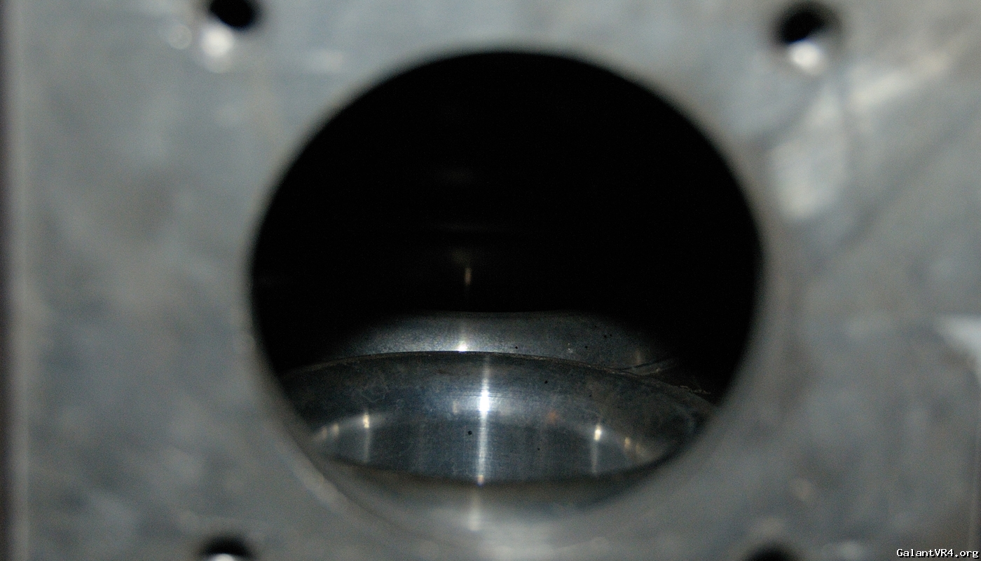

It's hard to get a good photo of the inside but he made velicity stacks for each runner.

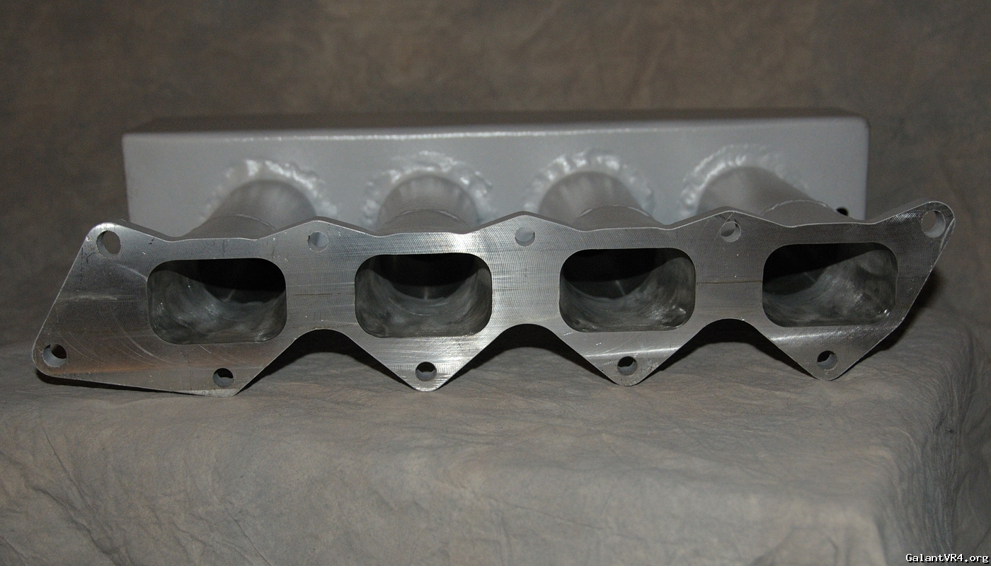

Instead of just beating the runners to make them square. He machined them to go from square to round then weld them on the the round tubes. /ubbthreads/images/graemlins/ooo.gif
Then he made his own flange and port the crap put of the opening to make them smooth as hell.

Your pieces look sharp. I like the IM's runner lengths...a dyno with new parts will definitely make me want you to make me one /ubbthreads/images/graemlins/smile.gif hint hint I'm curious where the torque will increase on the RPMs?!

Great parts! You should know that there is a little more to selecting runner lengths than long or short. you need to make your selections based on which pressure wave you are aiming for. Research Helmholtz wave tuning. Some very interesting stuff. Not trying to take any wind out of sails. great craftsmanship and products.

I had some professional input on the development of this piece. Sure I didn't spend weeks on the flow bench, but I did a bit of homework as I did not want to build something that would work against me /ubbthreads/images/graemlins/grin.gif
