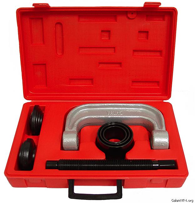

I would like to --PURCHASE-- the tools necessary to do this, because I will be doing not only this car but #441 as well in the short term. Taking a ball joint installation tool as an example, I notice they come with a variety of different sized [insert name of the piece that goes over the joint that looks like a socket here], what sizes should the one I buy come with? .. This is the kind of info I'm looking for...

I borrowed a ball joint press from dog bone (auto-zone). It consists of a hunky-ass "C" clamp and a few sleeves of different sizes. Here's what I borrowed. I found a few on the web for about $65.
