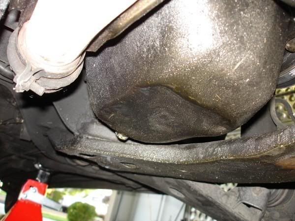

Background: the car was a 1 owner car until about a month before I got it. The guy I bought the car from knew the previous owner (his friend's dad) and finally talked him into selling it after watching the car sit in a garage the last ~3 years. Trying to do the right thing he took the car directly to a shop to get a t-belt and water pump done. Well, the shop was a bunch of hacks and completely botched the job. Thus far I've found they:[*]Had both cams off a tooth or two[*]F'ed the oil pan[*]Probably are responsible for the smashed up IC, but at best they failed to diagnosis it.[/list]Of course, the good news about them botching the job so bad was the previous owner sold it to me way too cheap. :naughty:;)

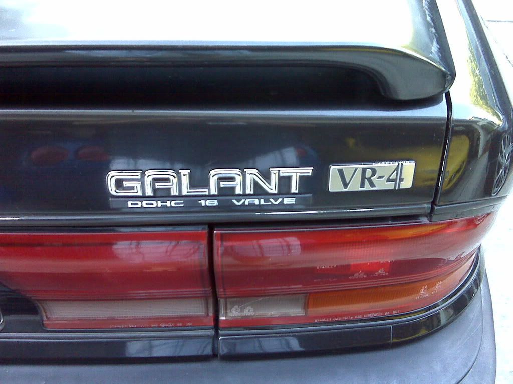

So, here it is, a 1991 Mitsubishi Galant VR4 with 107k original miles on it:

F'ed up oil pan:

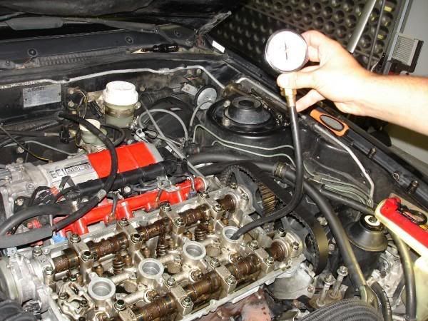

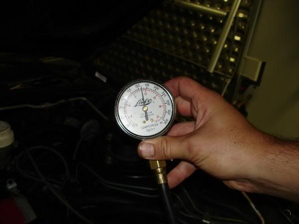

Compression checks:

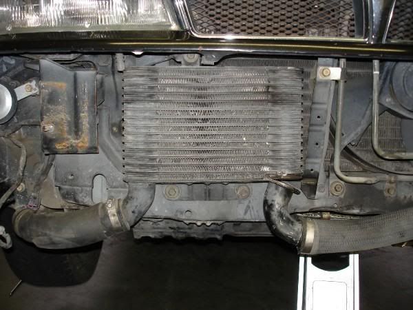

Blown-out IC:

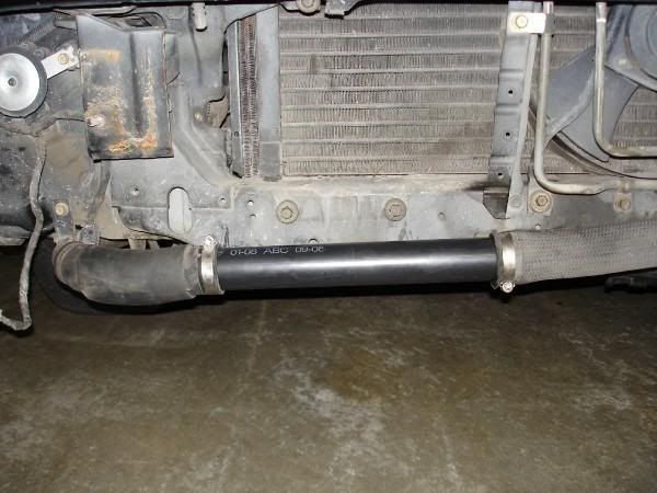

In the gheeeeeeto, in the ghhhhhhhhhhhhhheeetoooo:
(don't worry I didn't drive much or put it into boost w/ no IC, just for idle/light test drive purposes)

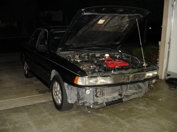

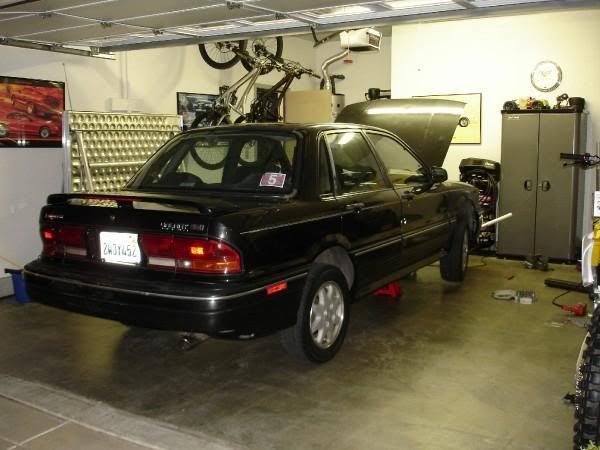

Current state:
So, now that it's running good it's time to get to modding!

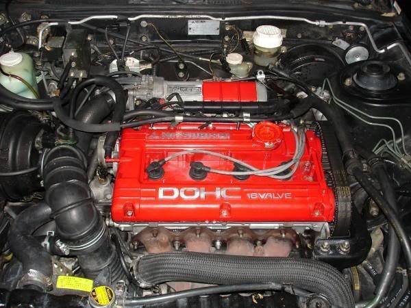

Overall from the pics..the GVR4 actually looks like its in good shape. Since the stock i/c is messed up...gives you a great reason to upgrade to a bigger more efficient FMIC, probably a Evo 8/9 FMIC...which is probably good for what you want out of the car. There are some great members here that can give you some great advice and help with these GVR4's...alot of what I have done to my car is from information on this board.
Looks like that GVR4 has some nice cars as company. /ubbthreads/images/graemlins/cool.gif
Whats with the partial red intake manifold and red fuel rail? /ubbthreads/images/graemlins/confused.gif
Not sure about the intake/fuel rail.
And only the Z06, IS250 and GVR4 are mine. The FD is a housemate's.
-TJ

The stock intercooler is such a joke, that piece of pipe is probably just as good. /ubbthreads/images/graemlins/rofl.gif

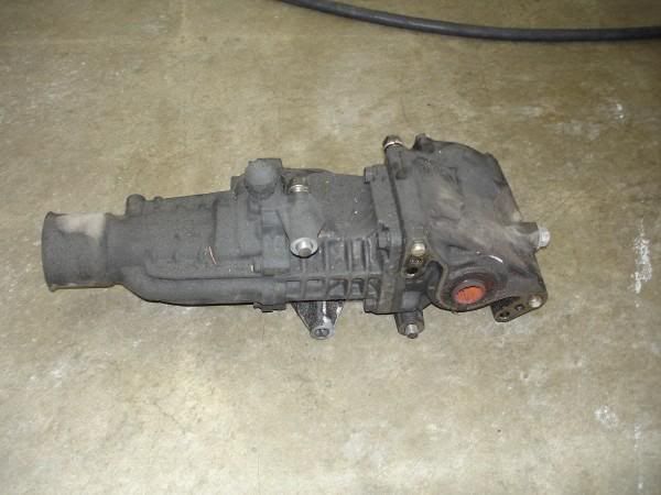

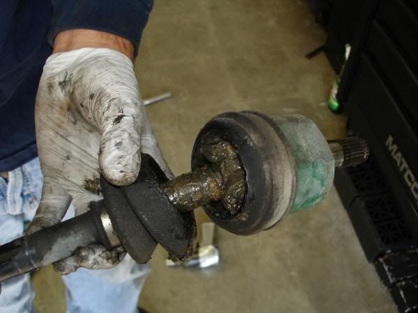

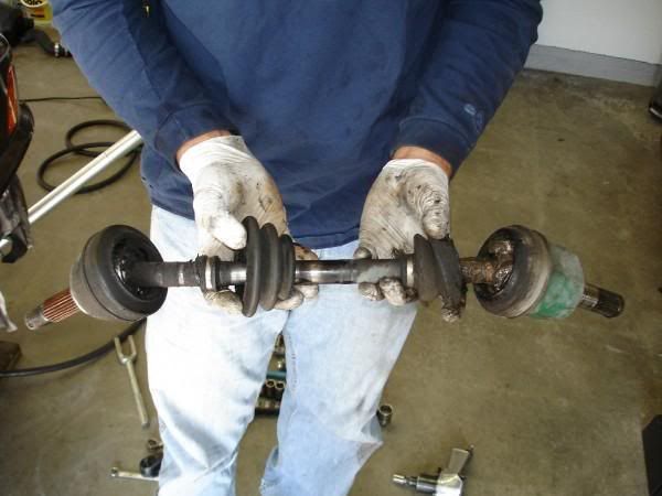

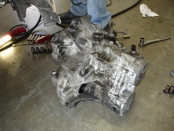

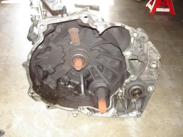

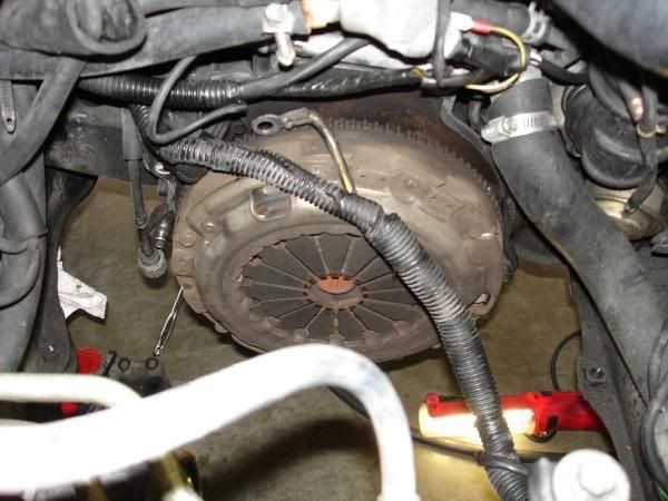

More progress, and more broken stuff and evidence of previous shitty work. Got the trans out, half-shafts look pretty toasted, and the bracket on the driver's side half-shaft had one of it's two mounting bolts broken off. Oil pressure sending unit is leaking too. Anyway, pictars:
