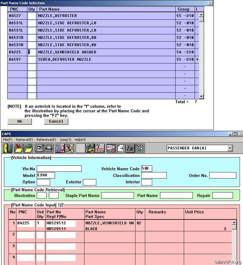

When I select a quantity of 1 in CAPS, it adds two part numbers to my list.
When you see that, it means that the lower number is the new good part number, the old is superceded. See in the heading for that area where it says:
"Part No" and below it says "Repl P/No".
