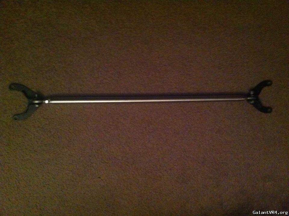

Hello, i need some suggestions on how i should trim the trunk side covers to install my new rear stut bar for my GVR4
any clever idea is much appriecated, Thanks

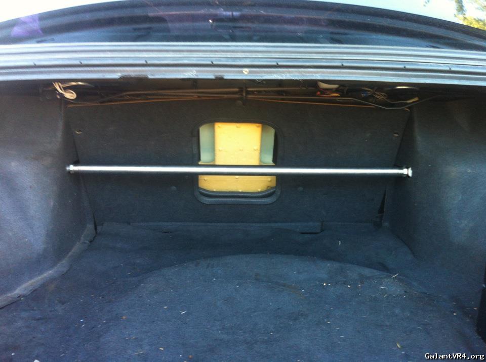

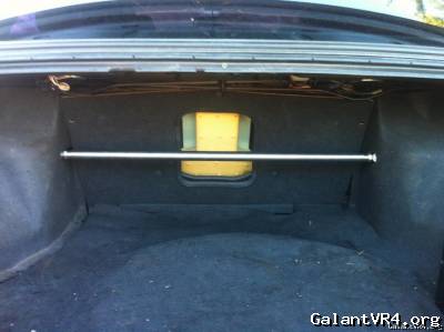

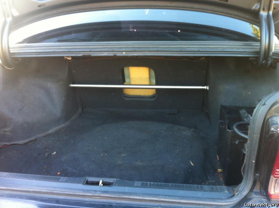

ok so i installed the new rear strut bar in #1380 aka Sleepy
heres how it turned out... it was really really easy to cut that cardboard.

For a fancy finish get some channelled rubber trim to run around the circumference of the hole (same idea as the hard plastic trim that runs around the circumference of the trunk pass-through). Should be able to find something passable in the weather stripping section of your home-improvement store.
