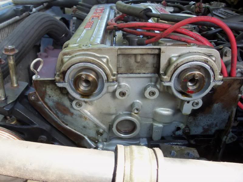

The cam seals weren't worn out, they were missing:
Keep in mind, this is the first time I have ever run this motor. I replaced a lot of parts, but had never taken the cam gears off.
When I took the cam gears off the seals didn't fall to the ground or come off with the cam gears...so I guess someone forgot them. Which is weird because I was told that the engine had 20k on a rebuild when I got it.

Was the car running when you got it from the PO?
I wonder if they swapped out the cams and went back to stock, leaving the seals on the old cams.
Either way, good to see the problem was readily apparent.

No, I bought the engine separately from the car, so I had never seen it run. I probably put 100 miles on it with no cam seals though because I had to move it.
