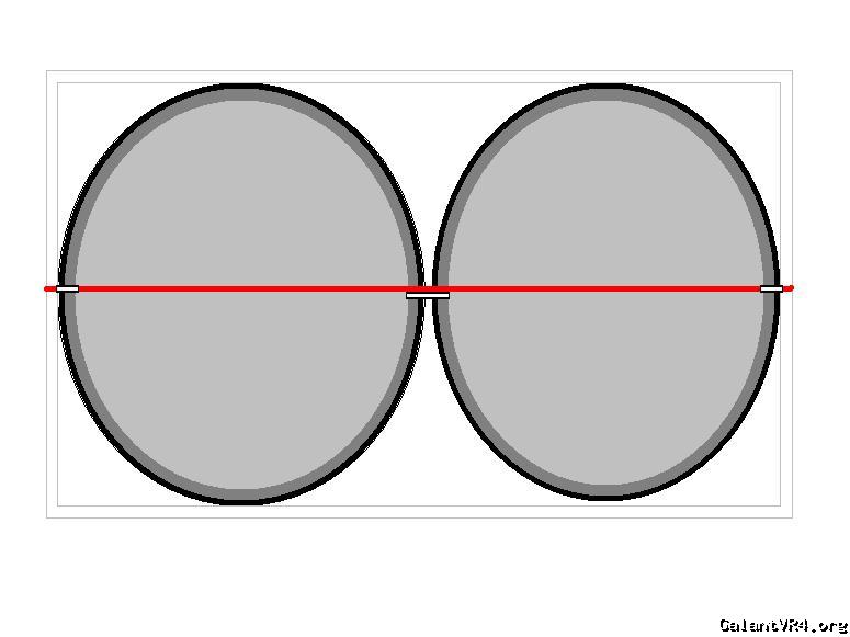

Do Not roll it over if you belive you have a tooth or so off.
Make sure that your lines are at the propper positions.
I use a 12" steel ruler as a straight edge to line the marks up from outter edge to outer edge.
Below is a pic that shows you how the inner marks will actually sit below the outer marks by roughly 1/2 tooth.
