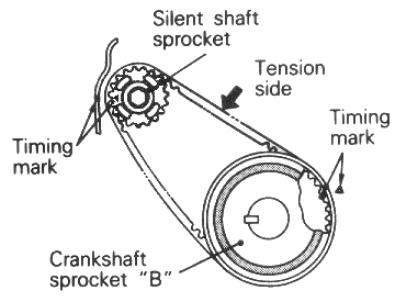

Ok got the oil leak fixed and the car back together. But now there is an engine vibration if ai rev above 3k. I have checked and reinstaled the belt to many tines to count. I even had my friend come put it on once but nothing helps.

did you put the screwdriver in the block at the back to line up the marks for the oil pump? They line up twice, but only once will the screwdriver go in. this is the correct timing. (with the screwdriver in)
Sounds like time to pull the belt off again.
Rich
the front balance shaft is easy, line up the mark & go. the rear one driven by the primary belt is a little trickier, it actually spins three times to line up once.
the way I do em' is to just rotate the ballance shaft gear utill it falls into position. it will do this three times . one of those three will line up the mark, within a tooth or two. when you get to that point line it up exactly & put the belt on.
to check your marks, rotate the engine six times & all marks, front ballance shaft included, will line up.
I need to get it to NOT line up pull the belt then line it up and it will be in the right place. Is that right?
line up cams & crank then pull the belt & don't even sweat where that pully is sitting beforehand. then rotate it, yo will feel what I'm talking about. spin it a few times & it will want to fall into one of three positions. when it falls withthe mark closest to lined up it is right.
Once you feel it & see what I'm talking about, it will make sense.
Oh, if you ment the front one & don't want to dick with it yes, rotate the whole assy untill the cams crank & front ballance shafts all line up then redo the back one.
If you are referring to the balance shaft belt, yes. It should be 1 tooth off and upwards. Once you install the tensioner pulley, and tighten it, this will put the mark on the balance shaft pulley back inline with the mark on the plate.
