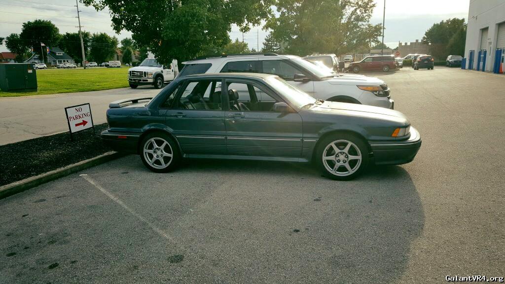

I still need to look into the throttle-body, it is sticky and causing a 1500 idle at times. But, I juiced up the drivetrain and took her for a drive around the block. She is ready for a trip to the Ford stealership where two of my sons work to get her new tires mounted and get her aligned for the shootout. Then install the exhaust and enjoy it!! Here she is parked nose-in in the driveway for the first time, and parked under her own power for the first time since 2010ish.

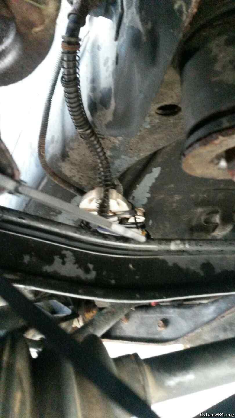

4. The random clicking identified itself on the drive home. Just as we hit Fort Wayne, I lost brakes midway while stopping. Pulled over and found the clicking was the brake line bouncing on the inside of the rim. So, we Vise-Gripped the rubber line shut, zip-tied the vise-grips closed and zip-tied them to the metal brake lines and drove the final 90 miles to home.

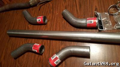

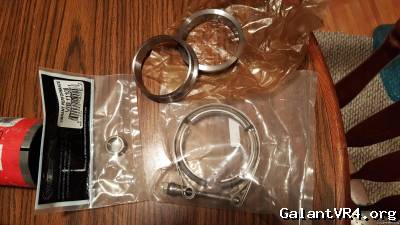

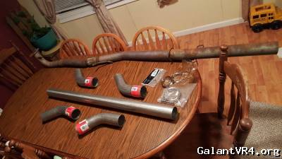

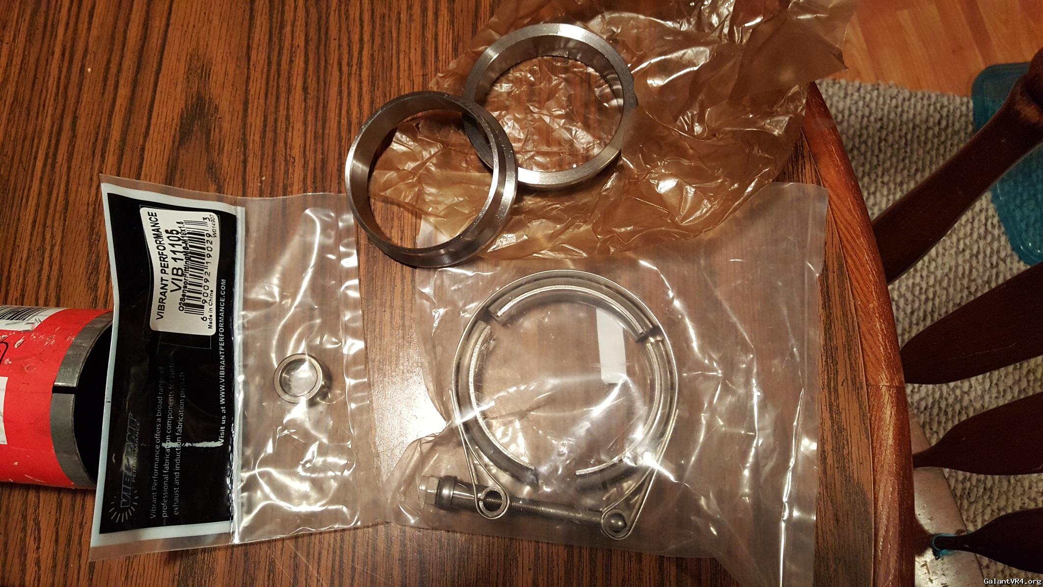

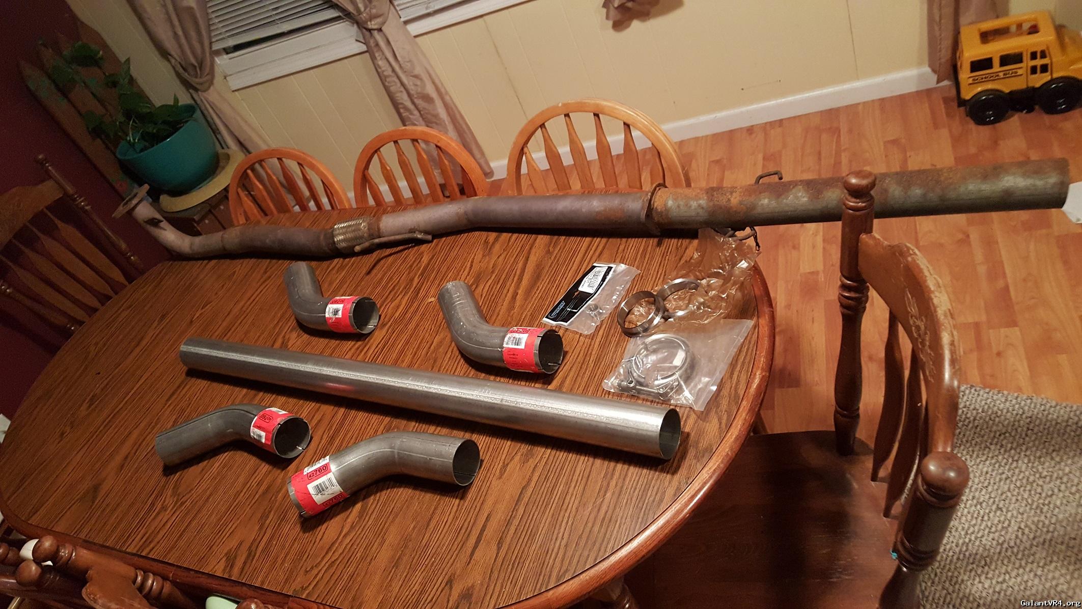

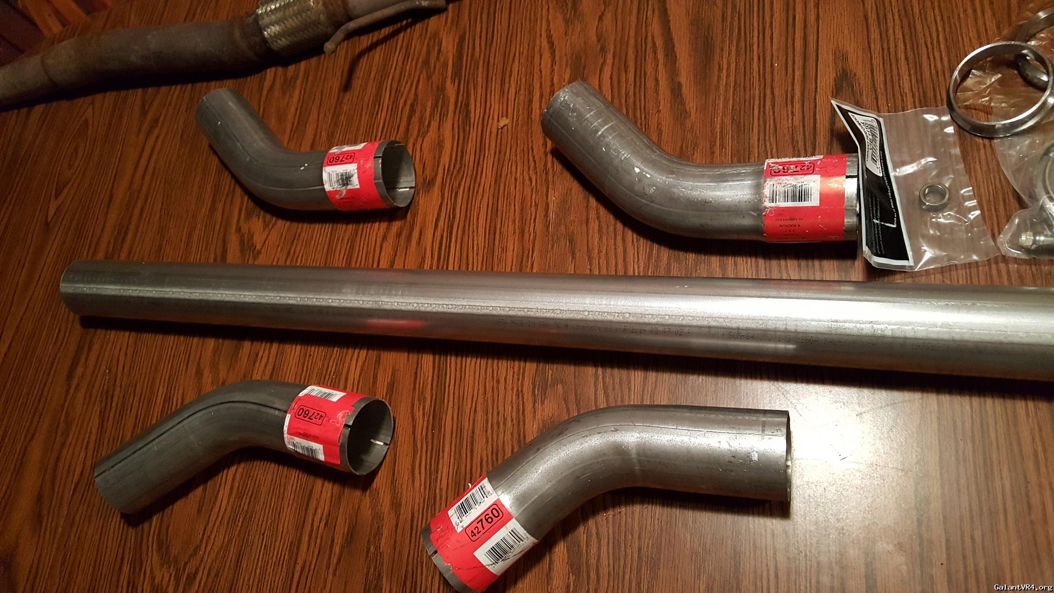

I have had it with what I thought was a stock turbo exhaust (with a 3 " downpipe). Did some measuring and found it was actually a stock NA exhaust. Ordered some 3" pipe, an o2 bung and a v-band set to get my spare Apexi downpipe connected. Time for some welding...

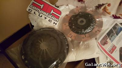

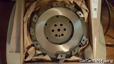

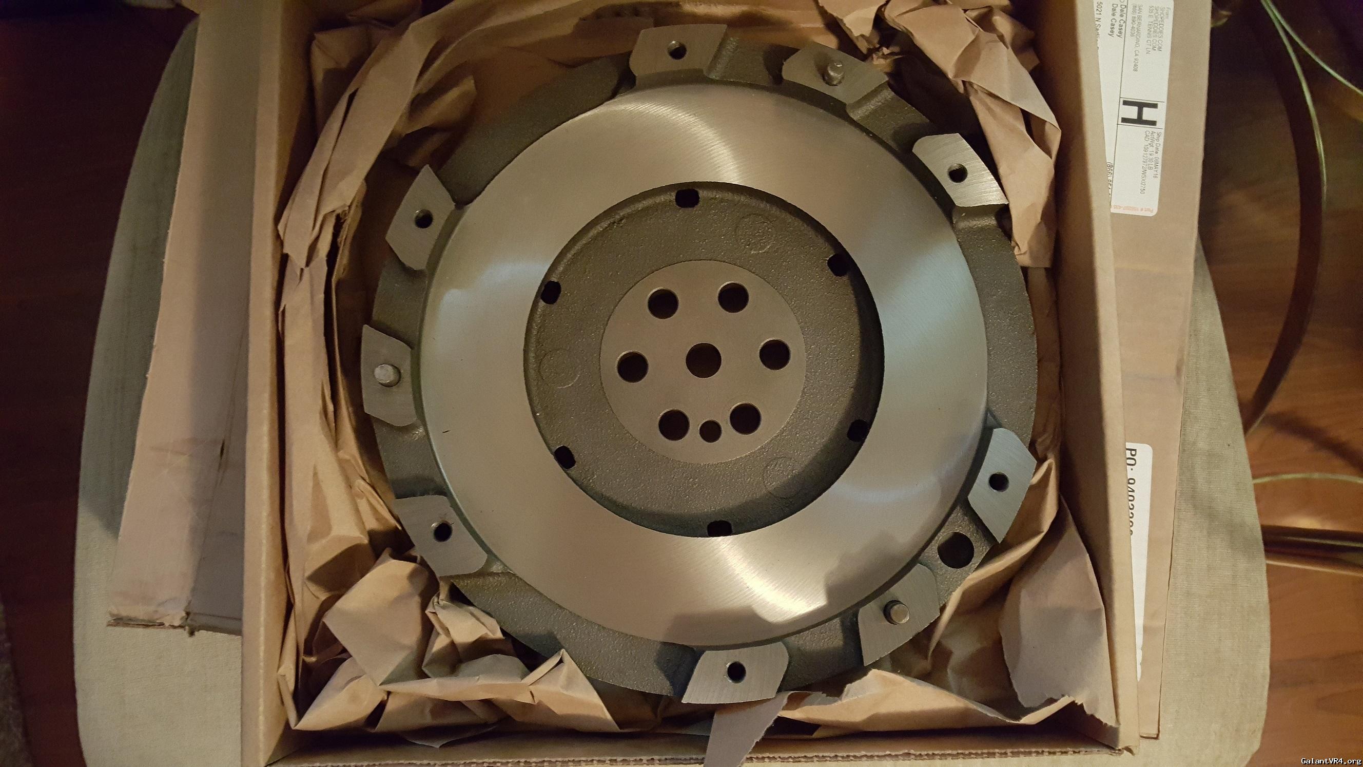

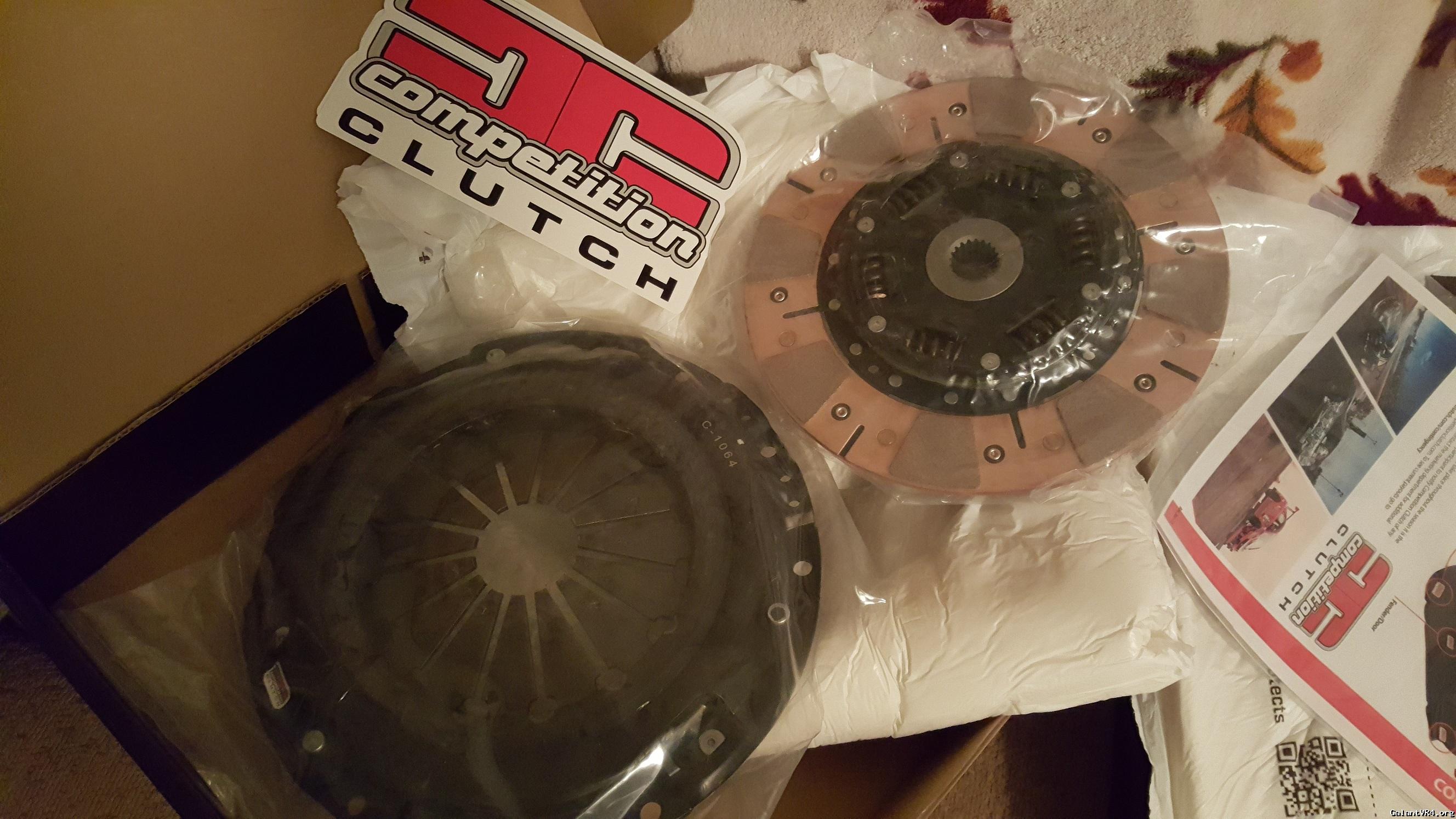

Got my new "stocker" flywheel and my Competition Clutch Stage 3 - Street/Strip Series 2600 Clutch Kit. in the mail on Friday. Looking forward to better than 15psi in the ol' girl.

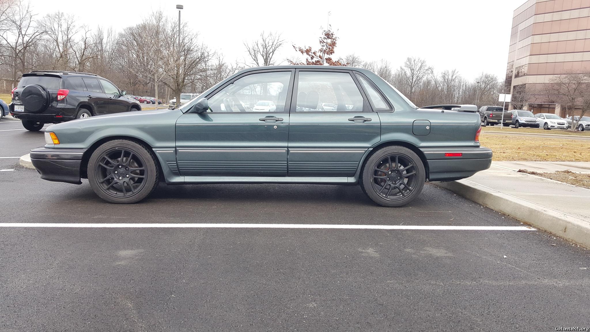

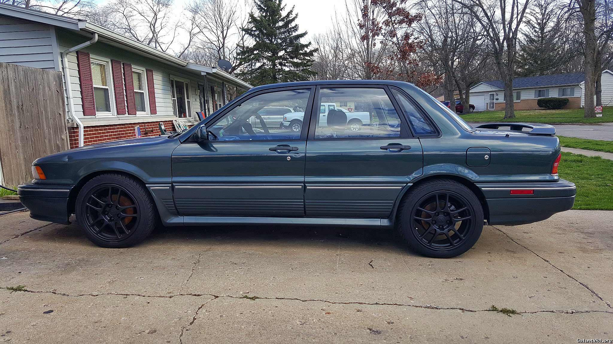

Picked up a real nice set of EVO VIII Enkie's with BFG Road Race slicks for $300 at the shootout. So, last night I did a thing and swapped the tires on them (saving the tires for my son to run Max Effort with them next year in his VR4. The wife is hapier too as she hates black rims, so approval all round. The EVO IX Enkie's went to my son to put on 543/2000. Two of them have a slight lip bend, but are much nicer than his old Enkie RSF-2's that have the wrong off-set, one had a crack and were just plain ugly.

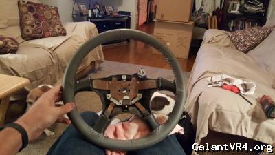

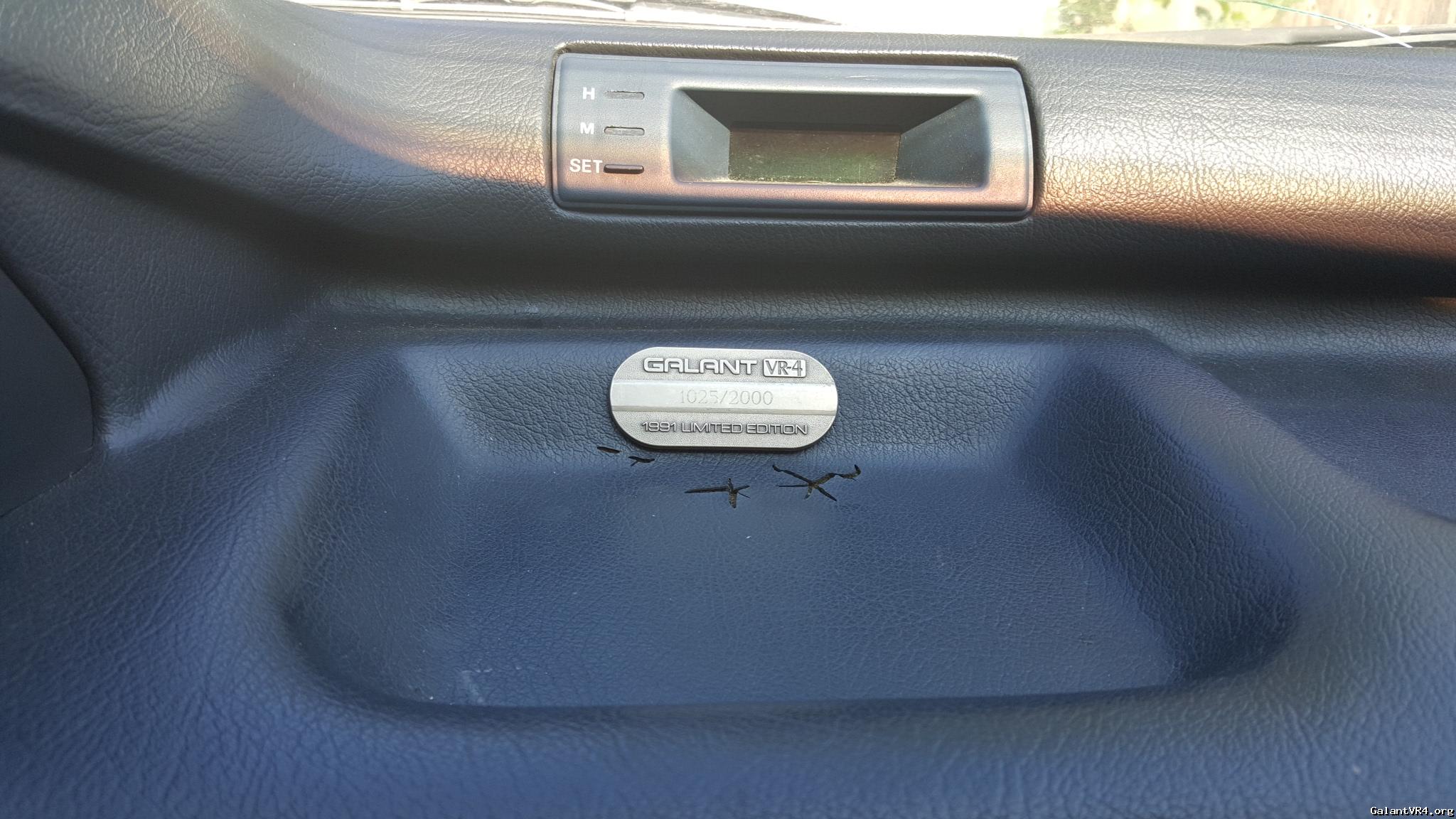

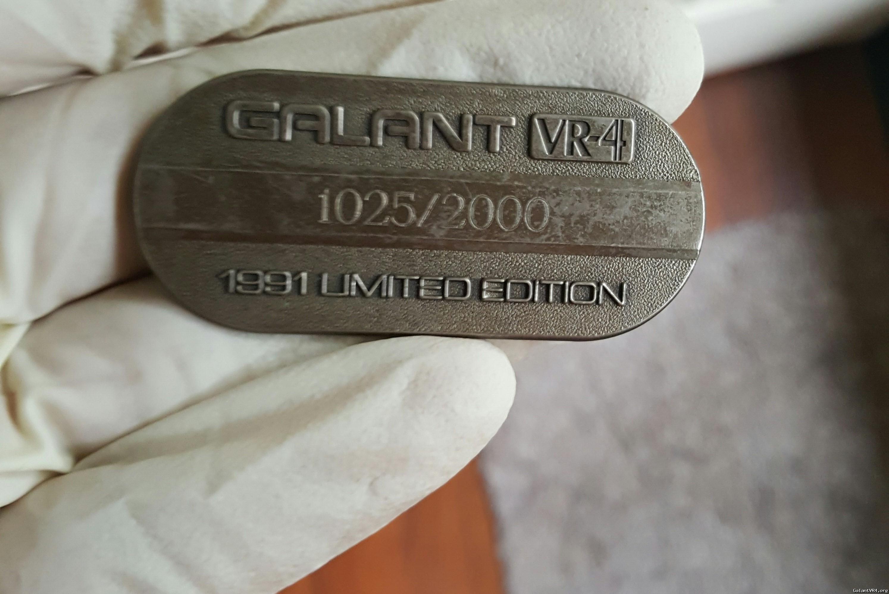

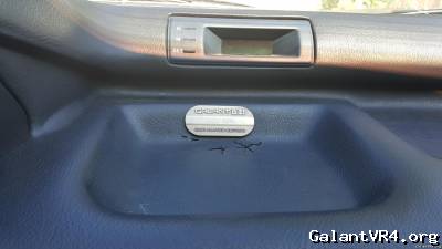

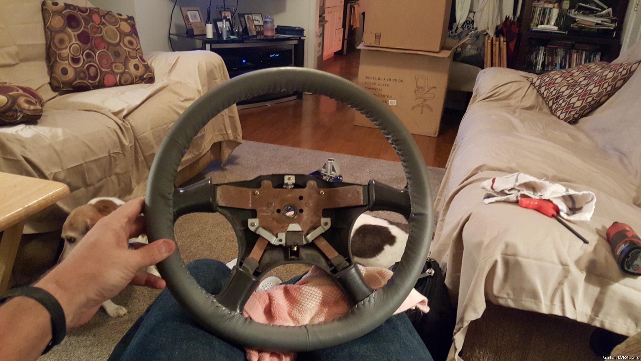

Completed a few more "to-do" items. I spent way too many hours (almost 4) stitching a new leather cover on the factory steering wheel. It was very difficult to find one that was not too large for the wheel itself, so I glued some strips of micro-fiber cloth around the steering wheel to make it thicker. It feels GREAT!!! Now I can buy the Hella horns so people will know when I am there. Also, I was finally able to get with the last known owner to have this car that cared for it. He had the dash plaque. He sold it to me and now it is home where ti belongs. It is no longer a mystery.
11,009
Hey Thom, good news. Maybe you did this already, but please send me the VIN of 1025 so I can correlate it in my list.
Thanks.

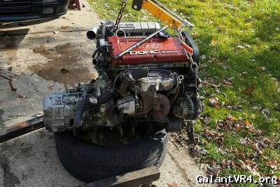

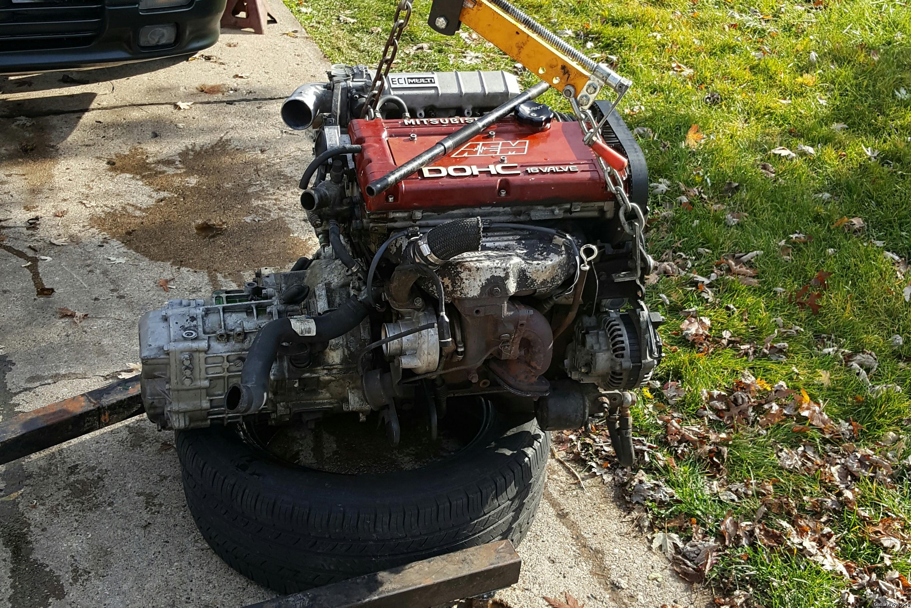

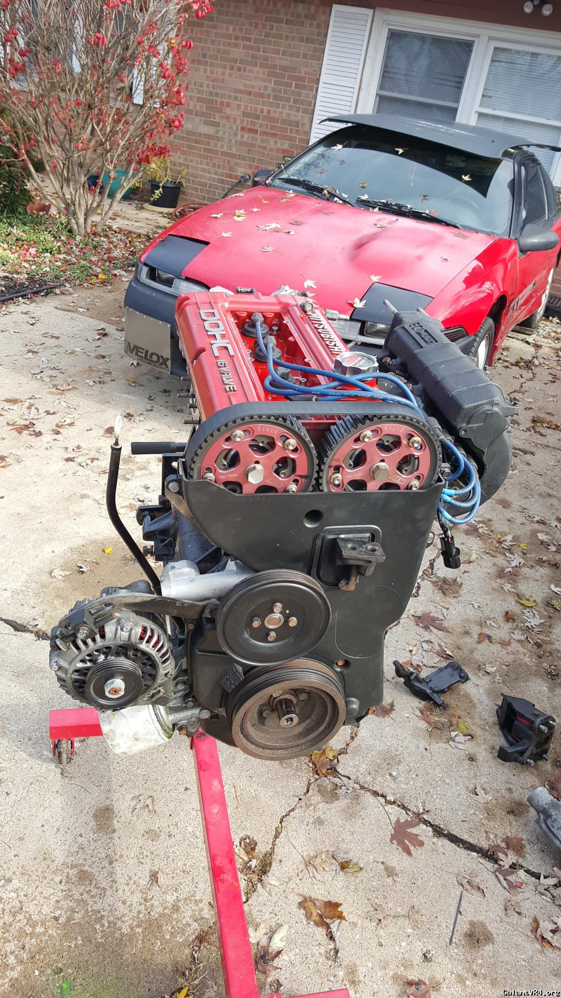

Replaced my 9.0:1 comp motor with a fresh 8.5:1 motor with 272's and a knife edged crank. Also upgraded the EVO IX 560's to PTE 680's and also upgraded my v2.5 DSMLink to V3 full with the MAF cable. While getting it up to temp I discovered there is a small coolant leak either at the thermostat housing or one of the heater core lines, so gotta fix that. Also, while the tranny was out, I finally got around to replacing my seized VC and installed a good unit. Was pretty nice to have the car not stop rolling on me while I was turning the car around. Should have did it long ago as it was much easier than expected.
Just need to get the idle up above 500rpm and set the timing and she can be tuned.
Old motor removed (Going into 543/2000 along with a PTE 6262)
New motor
A little 272 idle. Motor is still cold, when warmed up idle dropped to 500.
cold idle

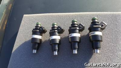

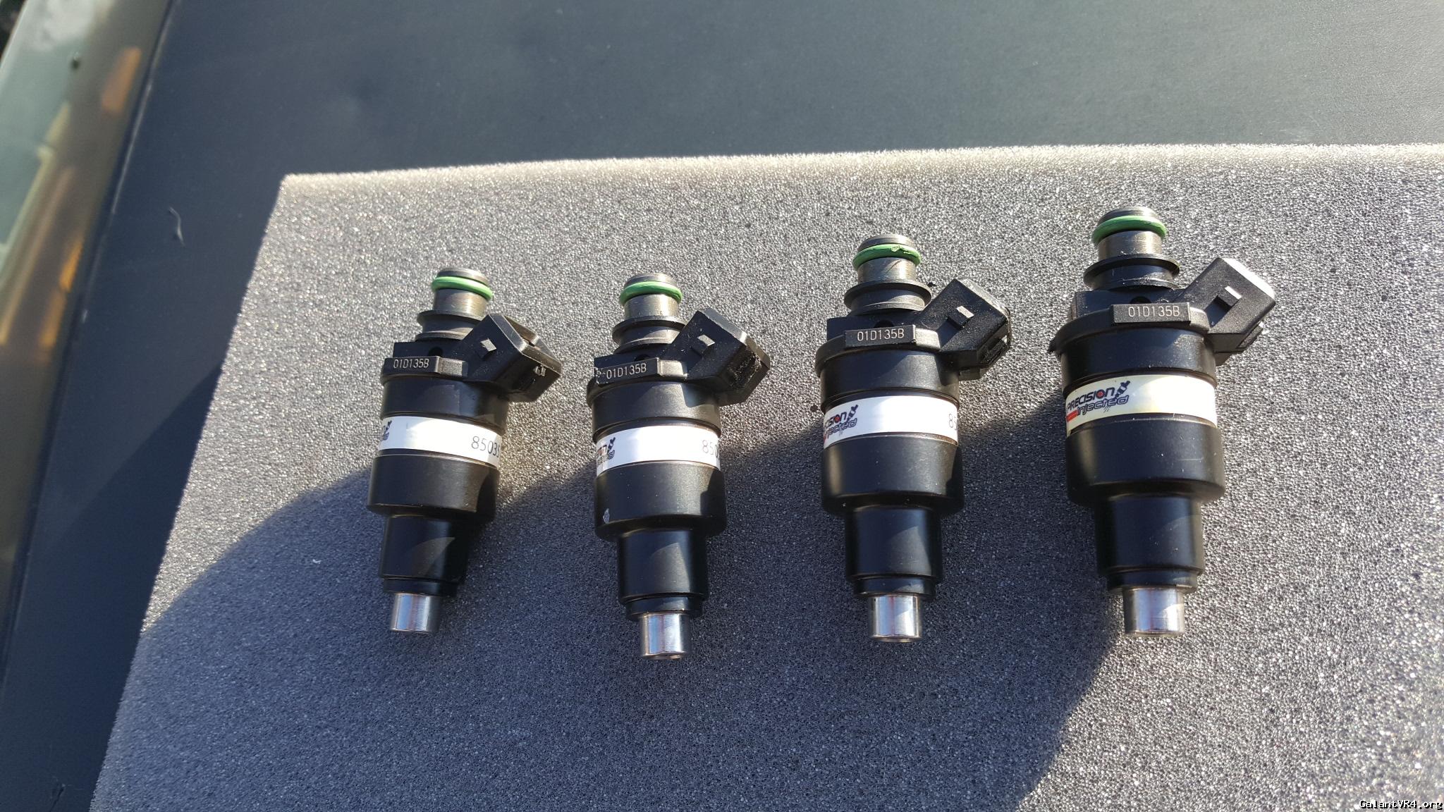

Picked up a BNIB TiAL Q 50mm and PTE 1200cc injectors for $300 total!!! Got them all installed, not to get a cruise tune on the new injectors.
