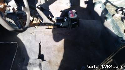

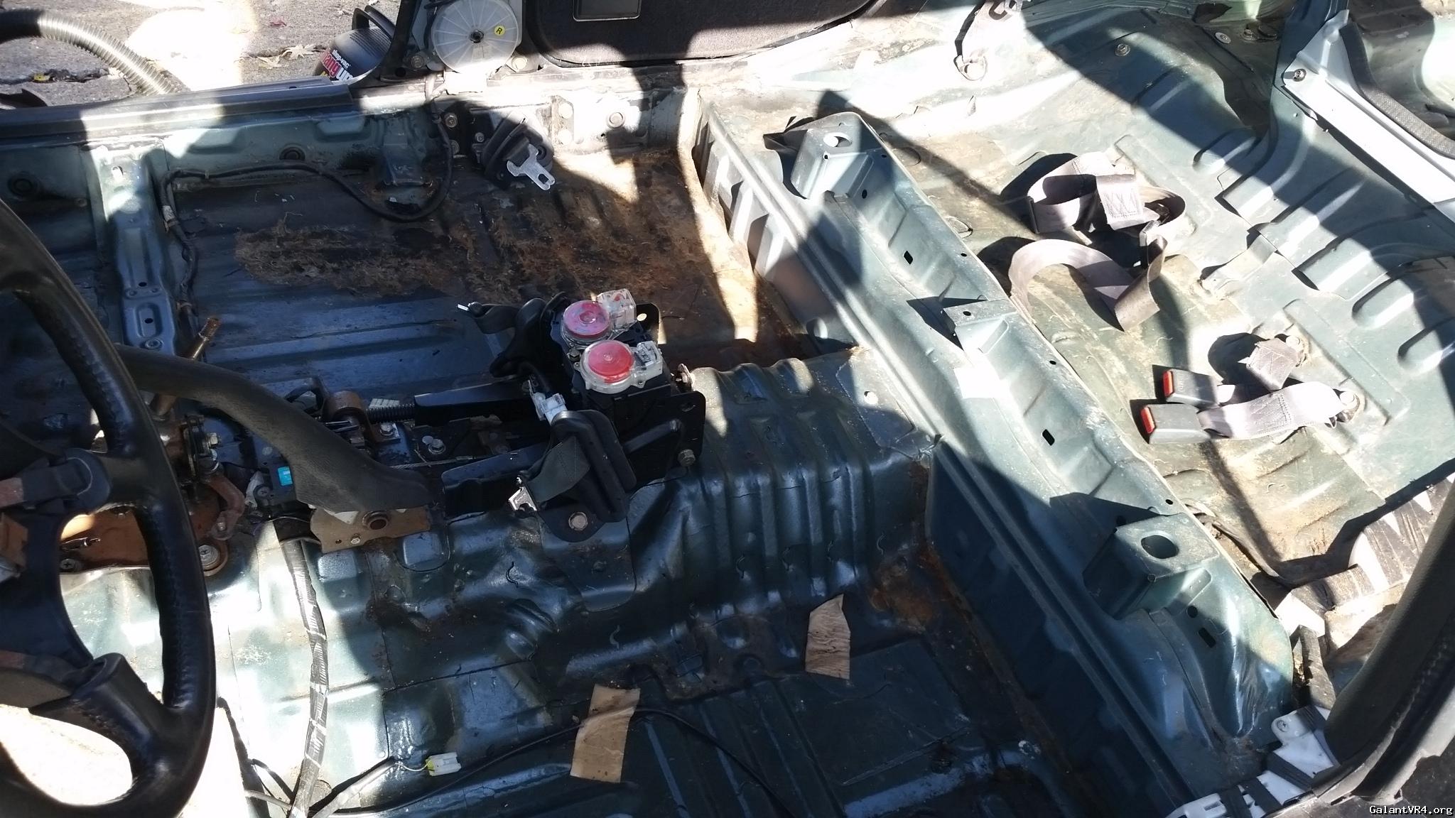

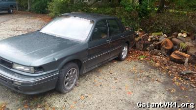

Ressurecting #1025/2000. Here are the plans,
Here as she sits in a sad but rust free state:
Here are the plans (many parts coming off my swapped 91 Colt:

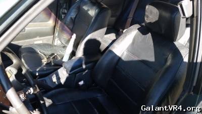

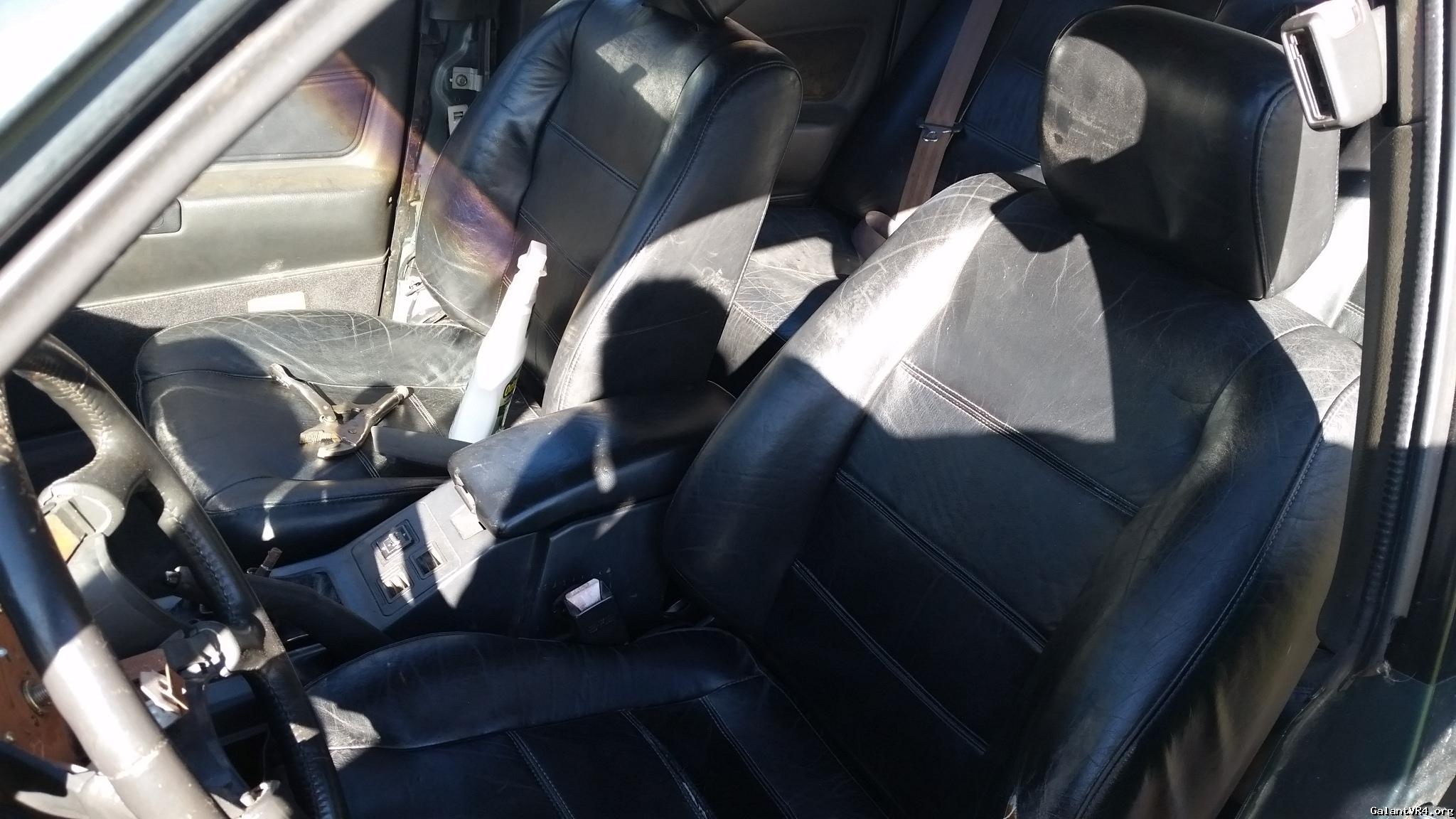

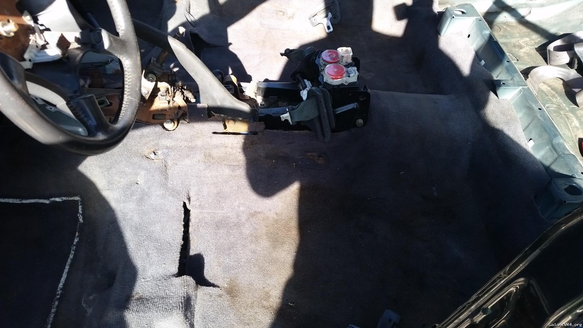

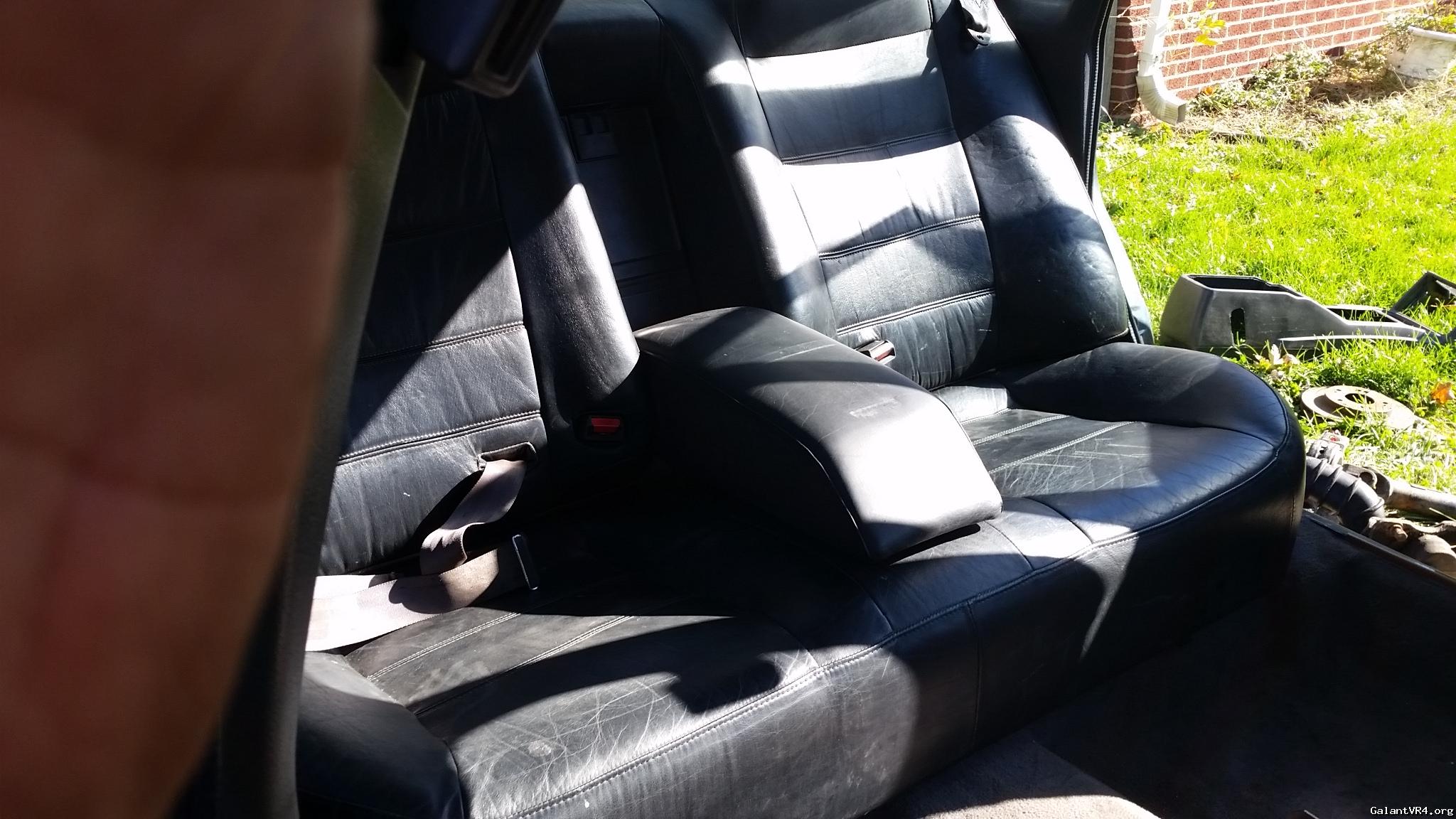

got standed with no car for a while today, so took advantage of the sunny yet 38 degree weather and cleaned out the galant and placed the interior in it to get it out of the house.

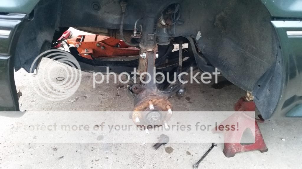

Put in a little work on Saturday since it was nice and warm in the 40's. Installed my 5-lug front knuckles with the fresh bearings. Went ahead and installed new ball joints, stab-links and tie rod ends too. Front struts are toast, rust infested (only rust on the car!!). Unfortunately I discovered some play in the passenger inner tie rod. Guess I will pull the rack and replace those too. /ubbthreads/images/graemlins/frown.gif

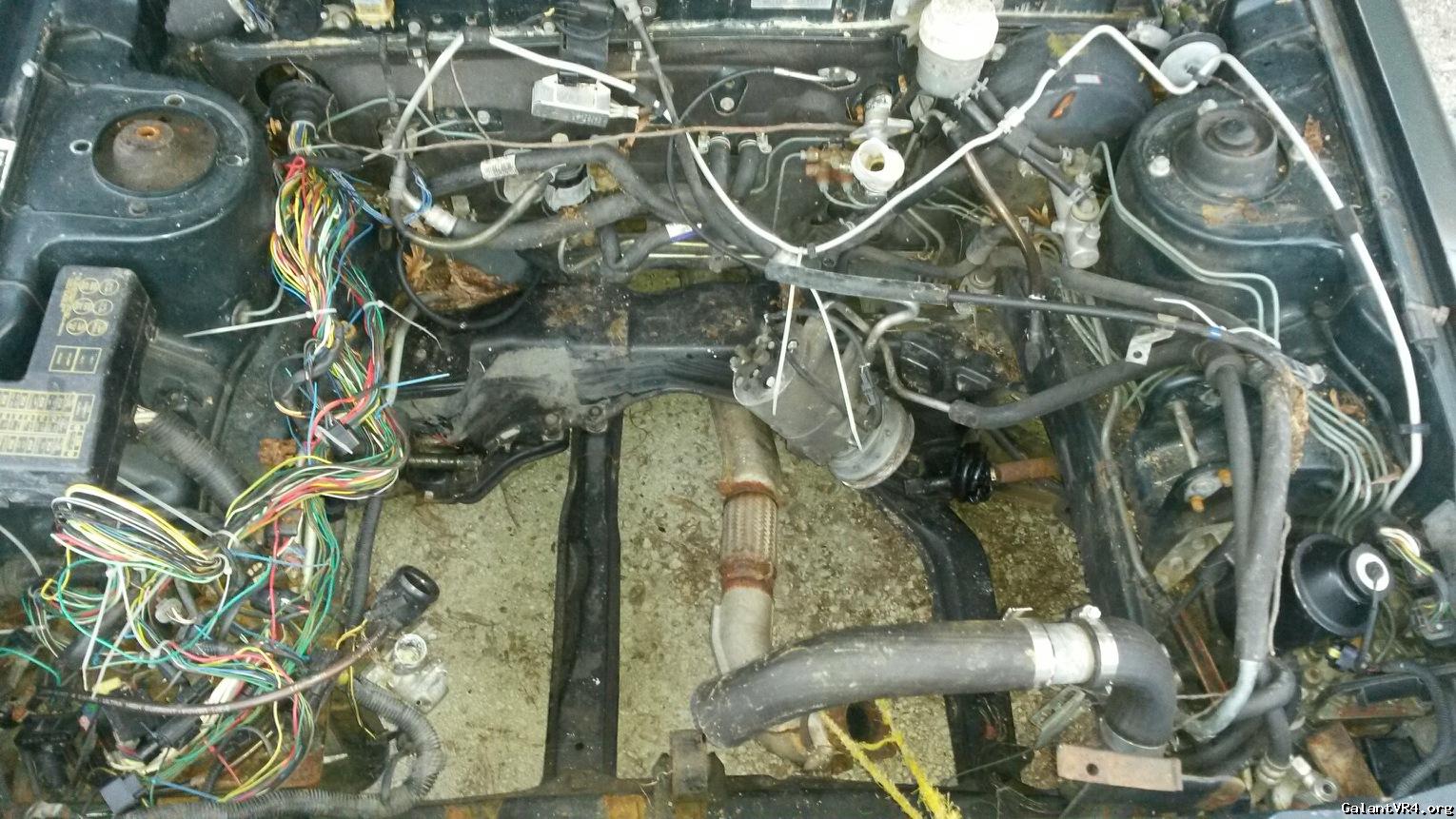

Wow, who are these fools who fray out the wiring system like that, and zip tie a heavy compressor to a aluminum line? /ubbthreads/images/graemlins/banghead.gif They should be restricted to public transit at the least.
Enjoy the build.
thomcasey
Sep 24, 2014
907
Indianapolis, IN
I absolutely agree!!. It looks like they were going to either re-loom or wire tuck and stopped. Fortunately the line is still solid and still holds pressure. I have since straightened that line (ever so carefully) and set the compressor on the cradle.

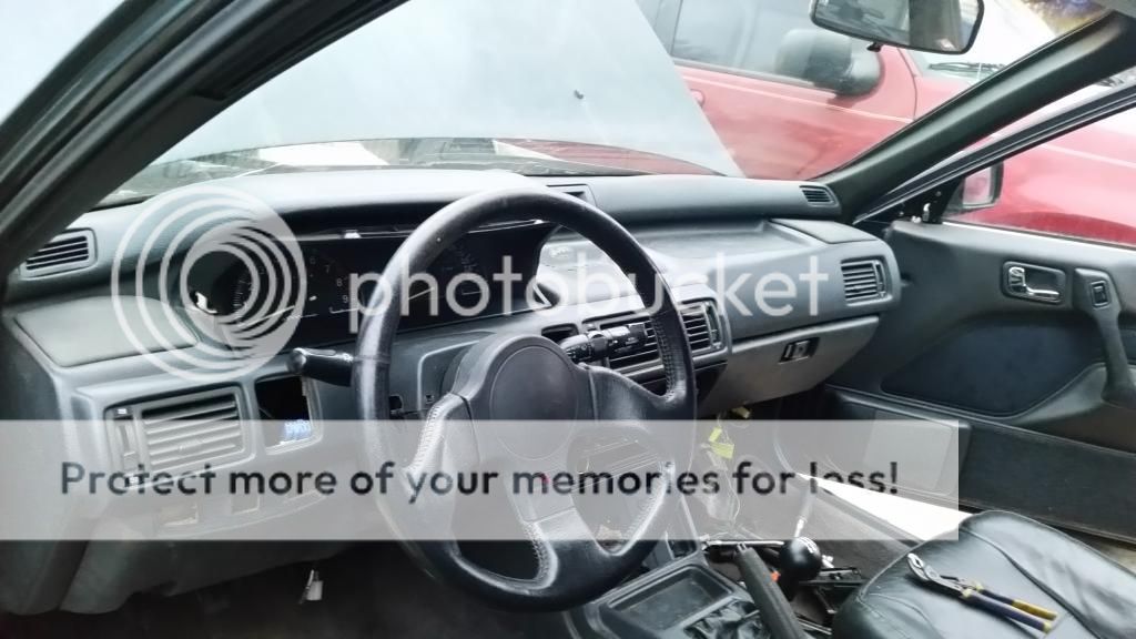

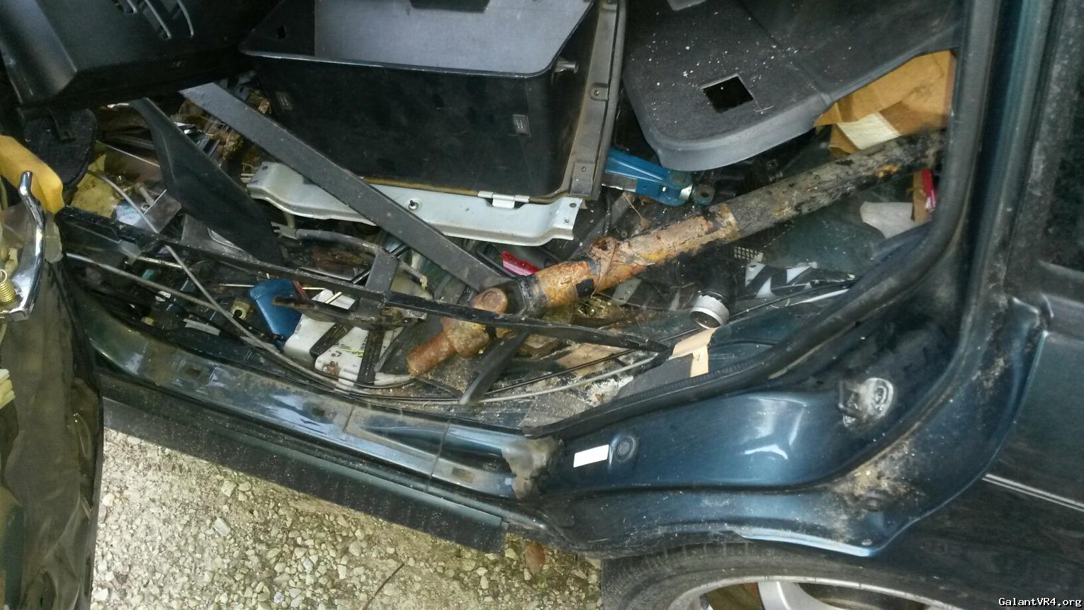

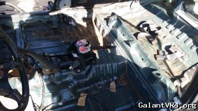

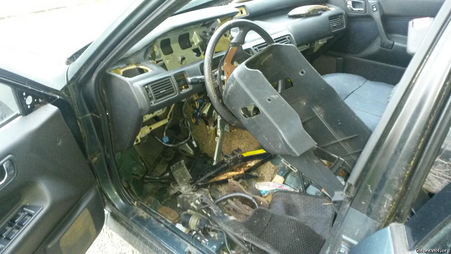

Saturday was in the Mid 40's, nice and warm for driveway work!!! Went to work on getting the dash installed:

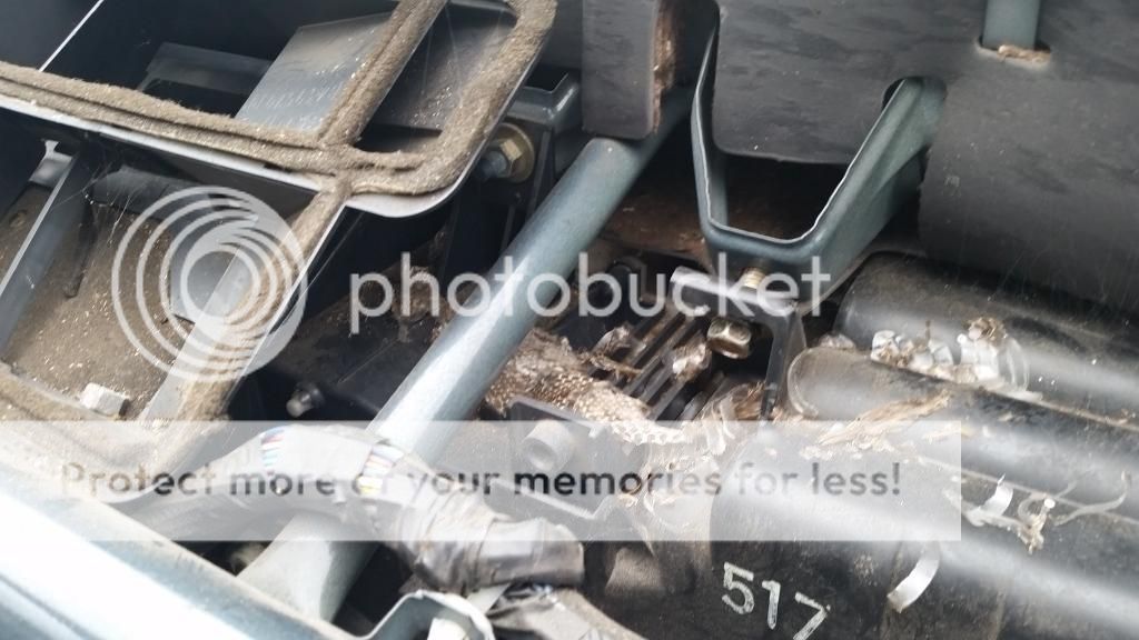

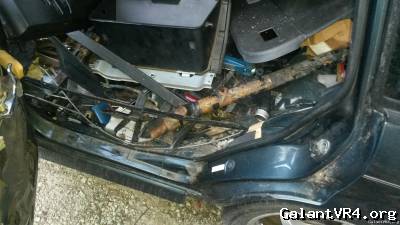

Pulled the dash to install the vent system. Found this on the heater core when I removed the semi installed dash:
The heater core did not work properly, was unable to redirect air since the knob would not move. I found the core was filled with AT LEAST a bunch of acorns, maybe the body of the snake was there too. So, I installed a new core.
Install complete:

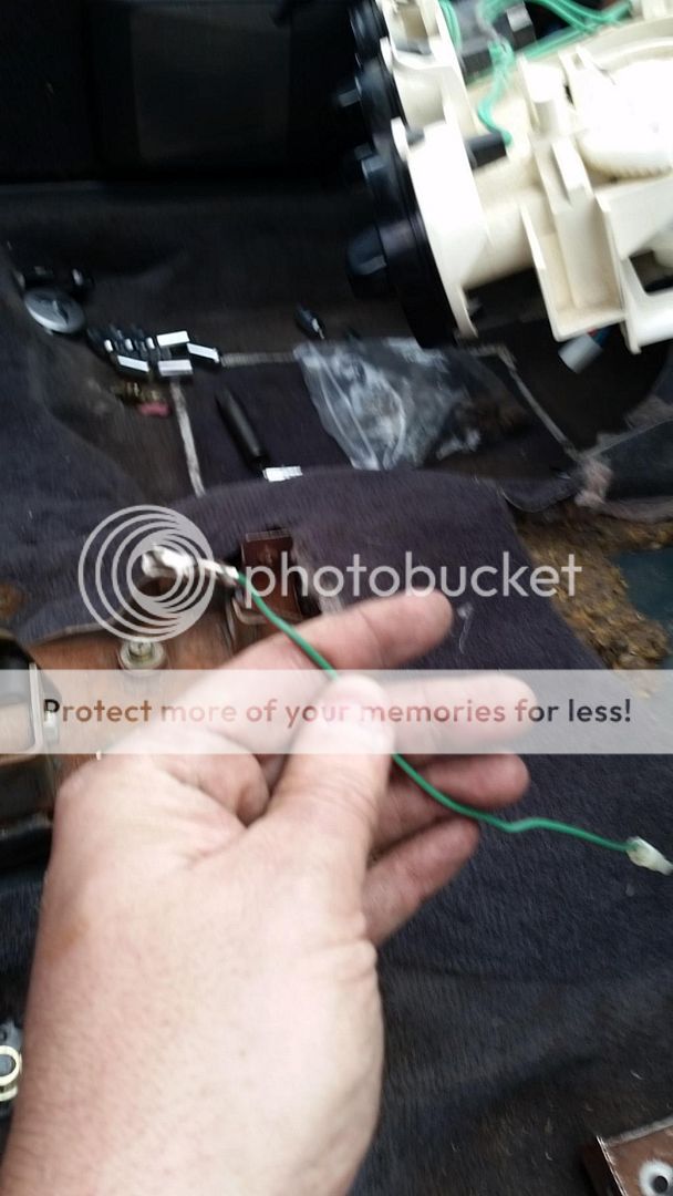

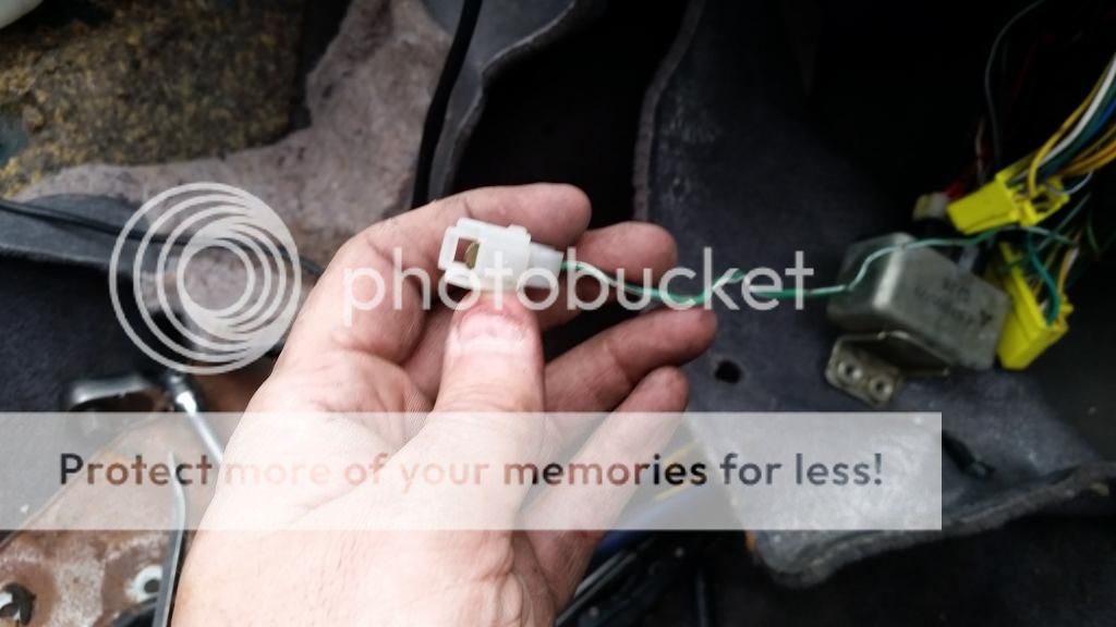

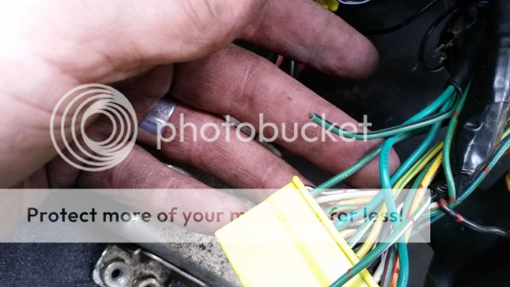

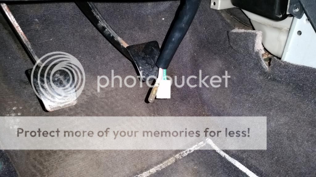

Only issue I found were following wires, no idea where they should go:
These are from under the steering wheel:
These coming from the center console area:
This is where the ECU goes:
And this wire. No place for it to go to in the harness:

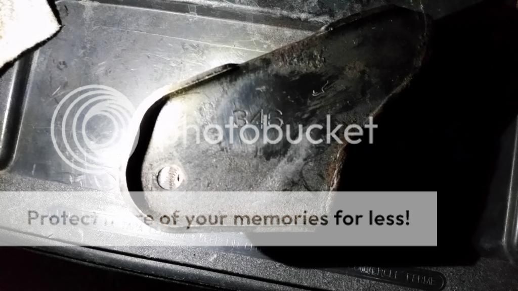

Anyone know what I can use to mount the speedo cable? there is no clip to hold it in place in the gauge cluster mount?

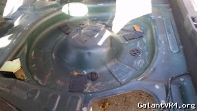

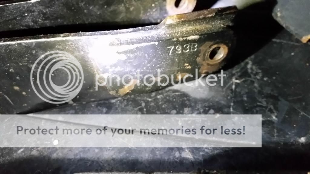

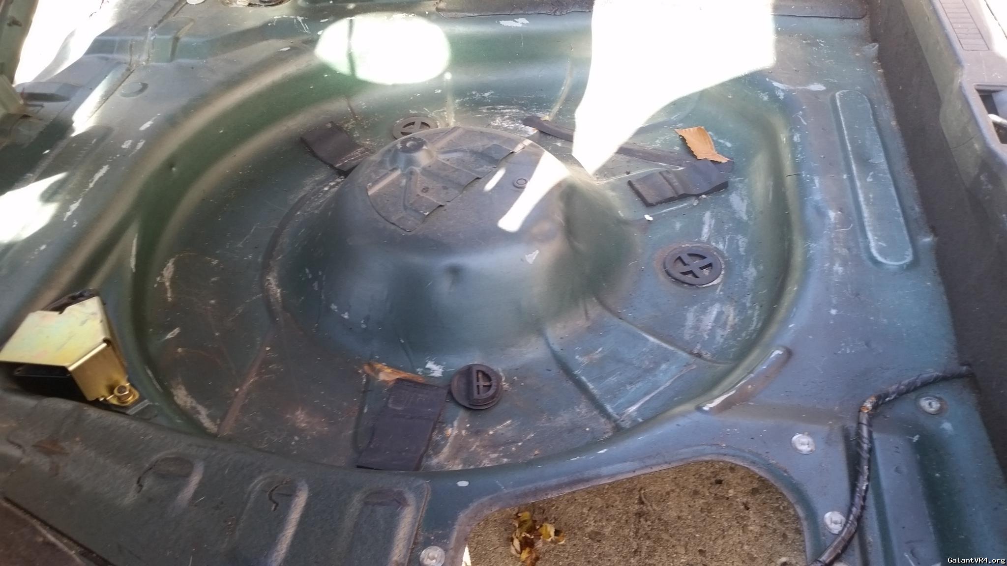

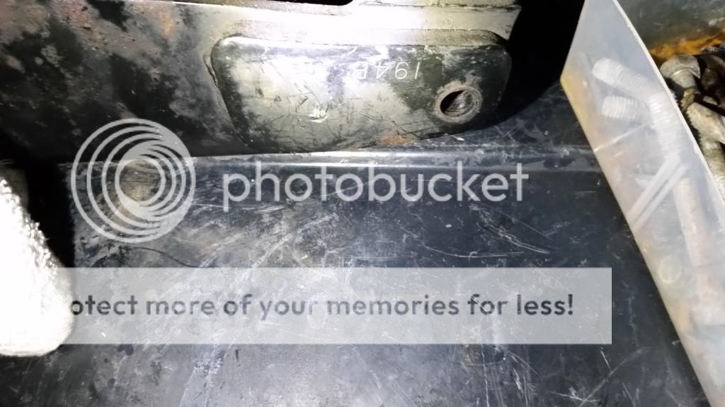

Also found these mounts in the trunk. Are any of these for the gvr4?
thomcasey
Sep 24, 2014
907
Indianapolis, IN
Figures. My luck they would not be the correct ones. I was completely surprised to find a complete dash minus only the two small dash panel/switches and the little panel that finishes off the lower left dash so I was hopeful for these mounts, but no more.
