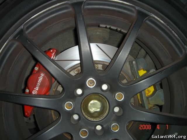

This brake set up is either really, really Rangi (uhhh... "ghetto" may be the most appropriate translation) or (because I haven't seen it before) amazingly brilliant in their simplicity.
Evo Brembos rear brakes on a 1G. Handbrake runs off the factory caliper. I wonder if they've just drilled two new holes on the left hand side for a bracket...

"Evo Brembos rear brakes on a 1G. Handbrake runs off the factory caliper."
did you guys miss that? /ubbthreads/images/graemlins/tongue.gif

I read that as well. It doesn't say if there is still fluid going to both calipers though. You never know what some DSM'ers will do.

/ubbthreads/images/graemlins/applause.gif WOW /ubbthreads/images/graemlins/applause.gif
Quoting CarRacer:
If it does it would help guys with autos keep from pushing though the brakes.

Check out Paul's solution to that one in his build thread.... /ubbthreads/images/graemlins/grin.gif

Quoting LunarShadow:
yippie, more unsprung weight.
That's what I was thinking. What's gained?

Gained: Evo 2 pot calipers and larger rotors - presumably better rear braking. I doubt fluid goes to both calipers - how would you go about splitting the line unless you were clinically insane?
Lost: I'm guessing about 7-12 pounds unsprung when you count the extra calipers, brackets and bigger rotors?

If the stock rear brakes aren't sufficient to balance the front brakes it'll gain some very neccessary stability under braking (backing it into a corner unintentionally is NOT fun).
Plus handbrakes are useful things on street cars!
