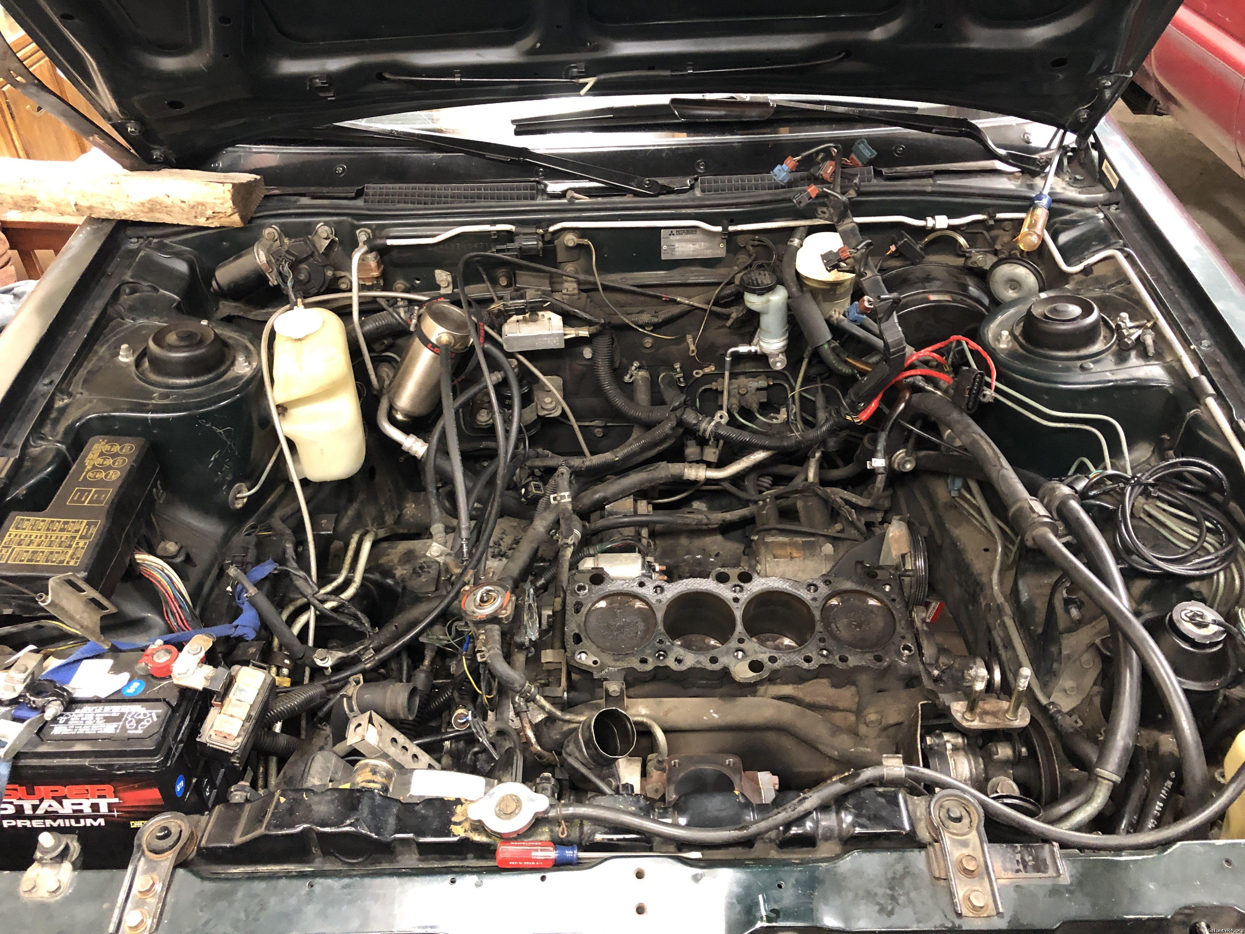

In December, my timing slipped and bent all of my intake valves, and life plus the fact that I'm completely broke stopped me from fixing her up. Well... until now, that is.
In the past couple months I've completely stripped the front end and have started rebuilding everything. I'm aiming for a "reliable" 400 hp, so I may overbuild a bit to hopefully keep'er as bulletproof as possible.
Here's how she looked after pulling the head
Yes, that catch can is an upside down water bottle with bungs welded on.

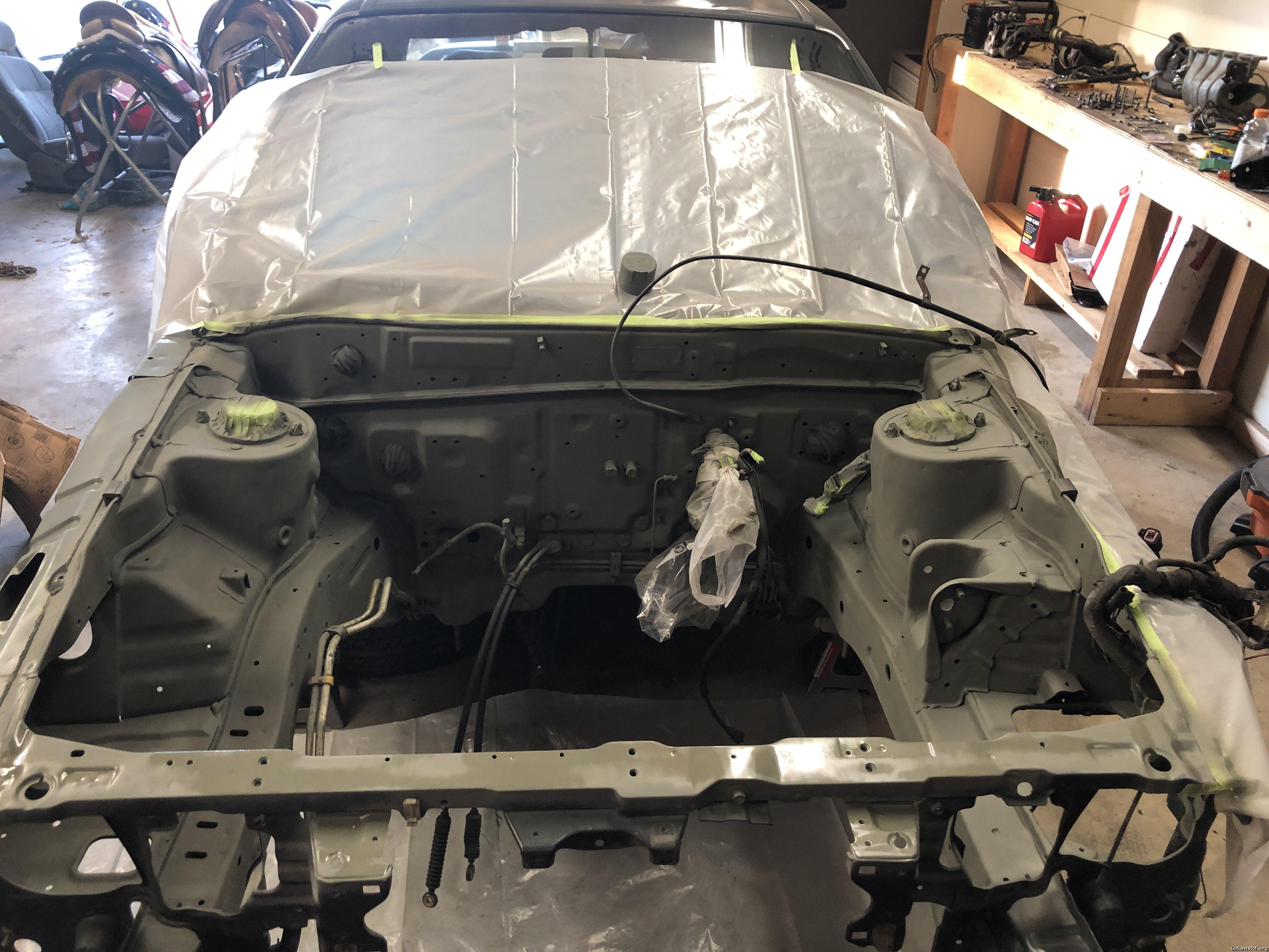

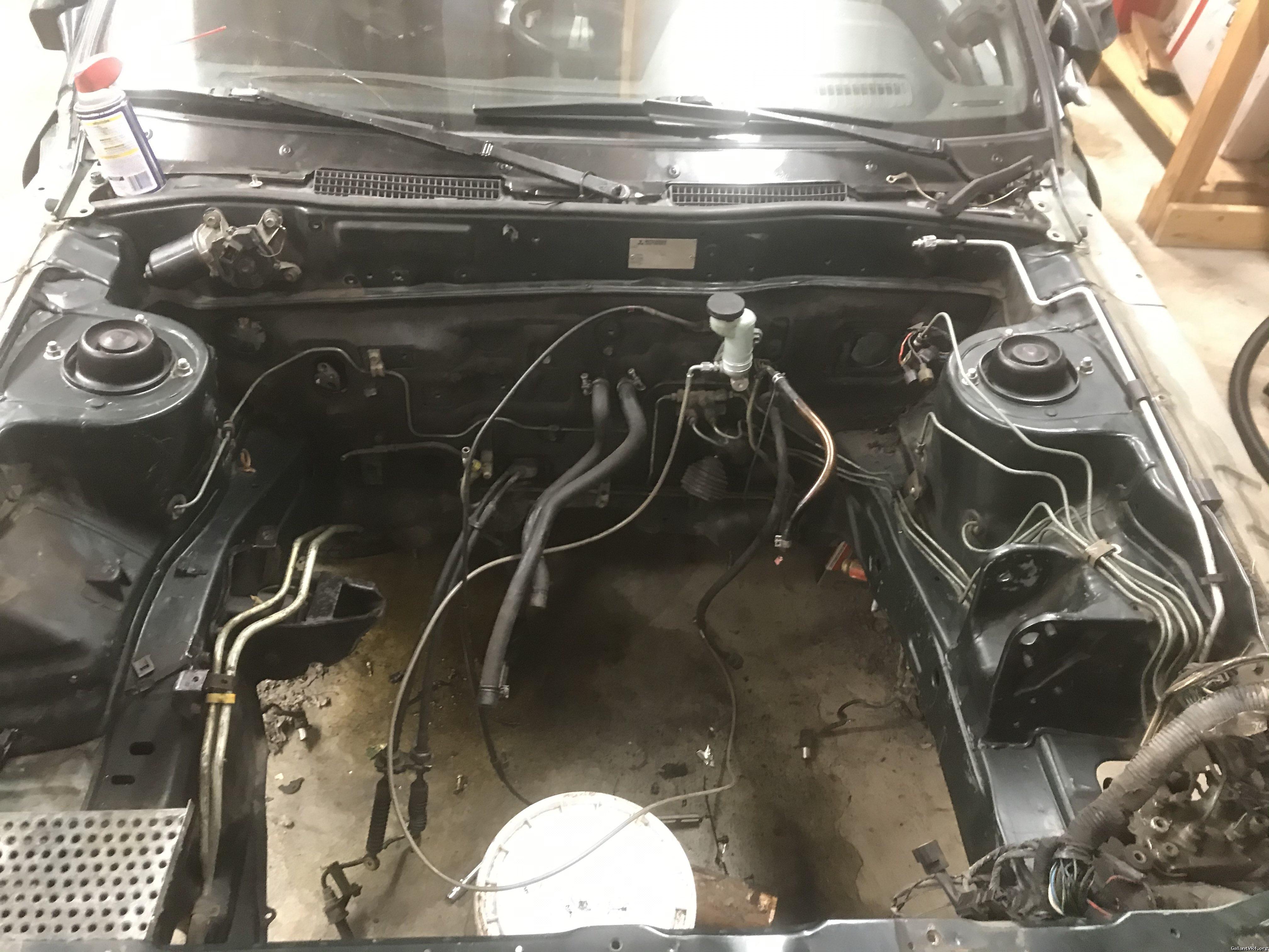

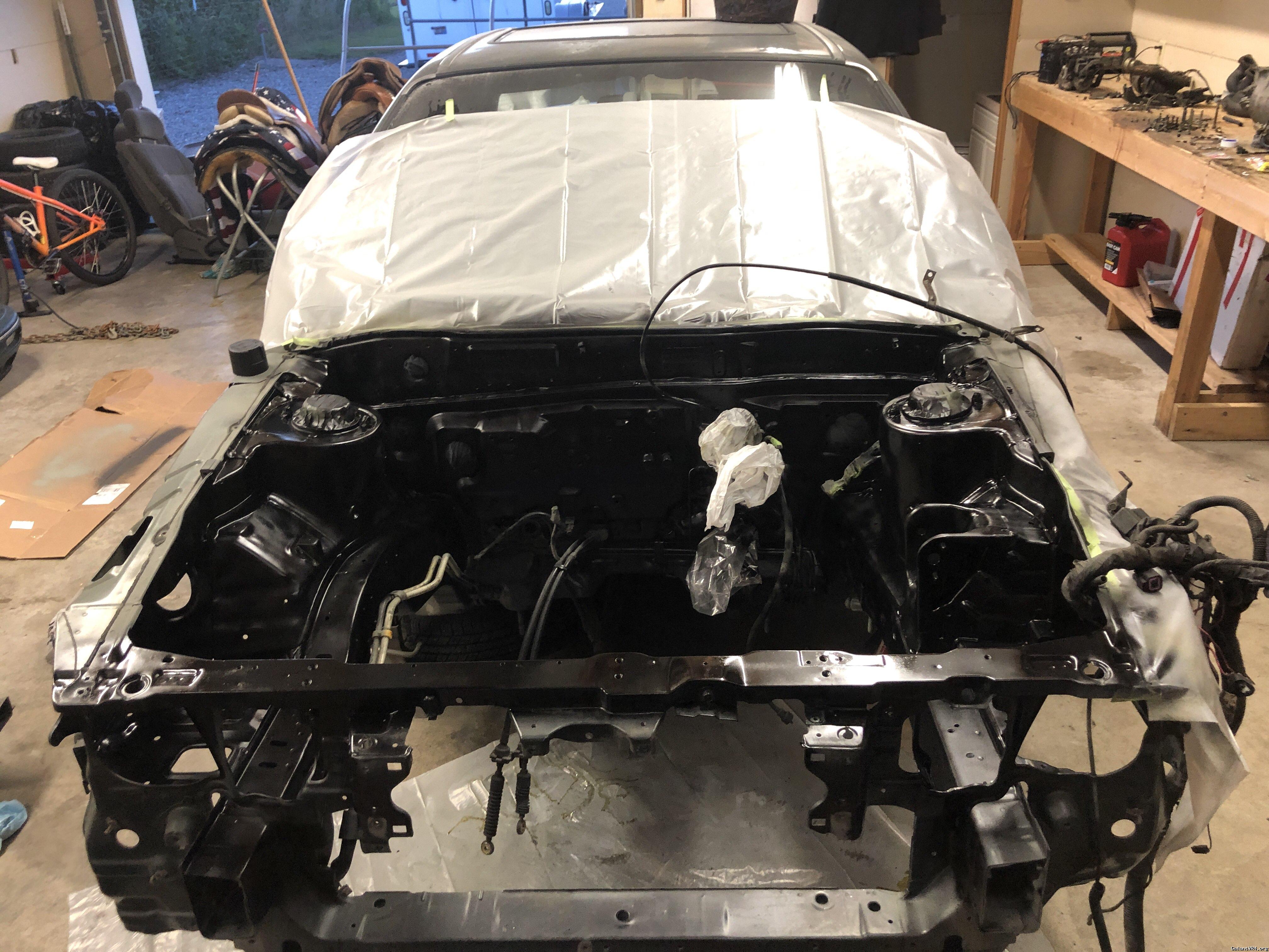

Here's how she looked after I decided I needed to redo everything, which was probably a giant mistake on my part but OH WELL TOO LATE

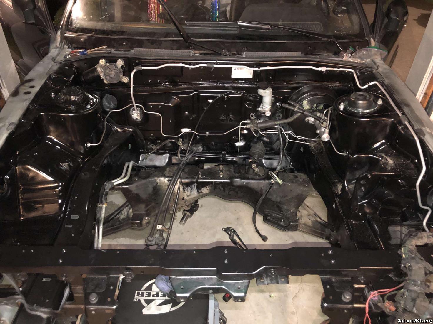

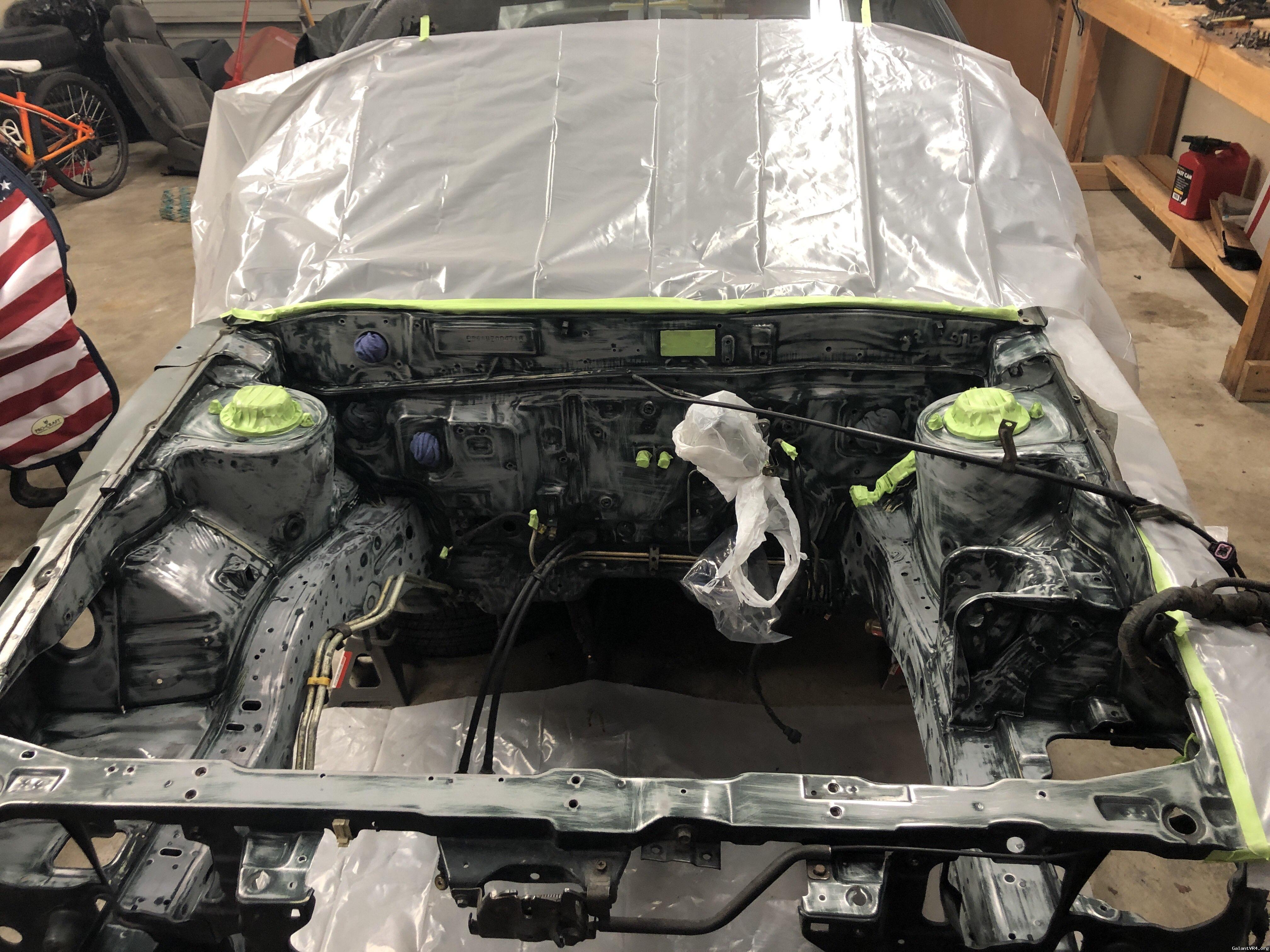

At that point I realized that the engine bay paint had definitely seen better days, and instead of cleaning it up and touching up scratches, I decided to paint it all black. I didn't know what I was doing and definitely could have done a better job of prepping and painting but it doesn't look too bad and could be worse for sure.
Sanded (too much)
Primed
First layers of paint
Now

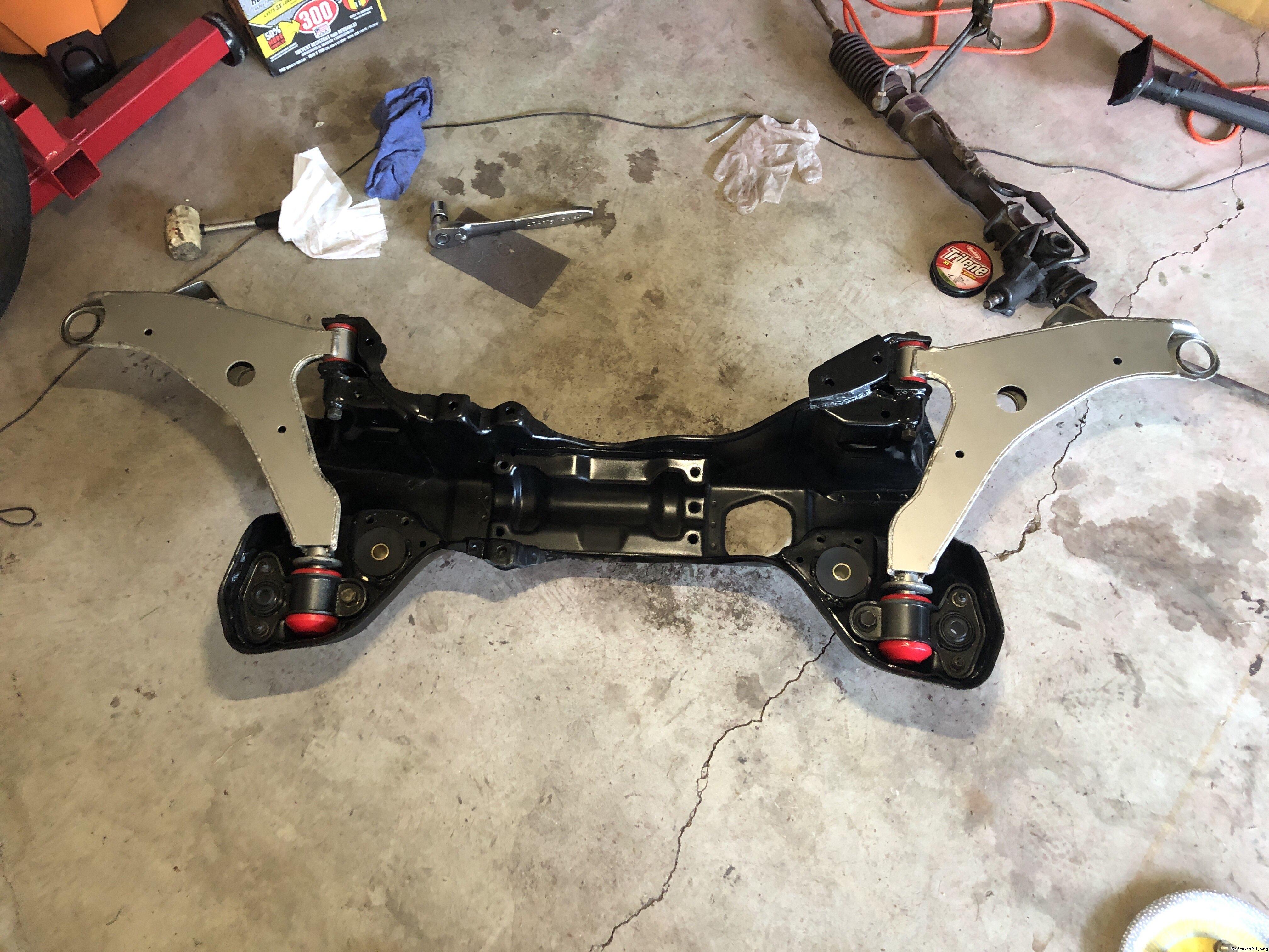

After all that, I decided the subframe and steering needed some freshening up. I don't have before pictures but here's the after of the subframe. I need to tear it down again though to get the rack in.
Energy bushings!! Yay!!

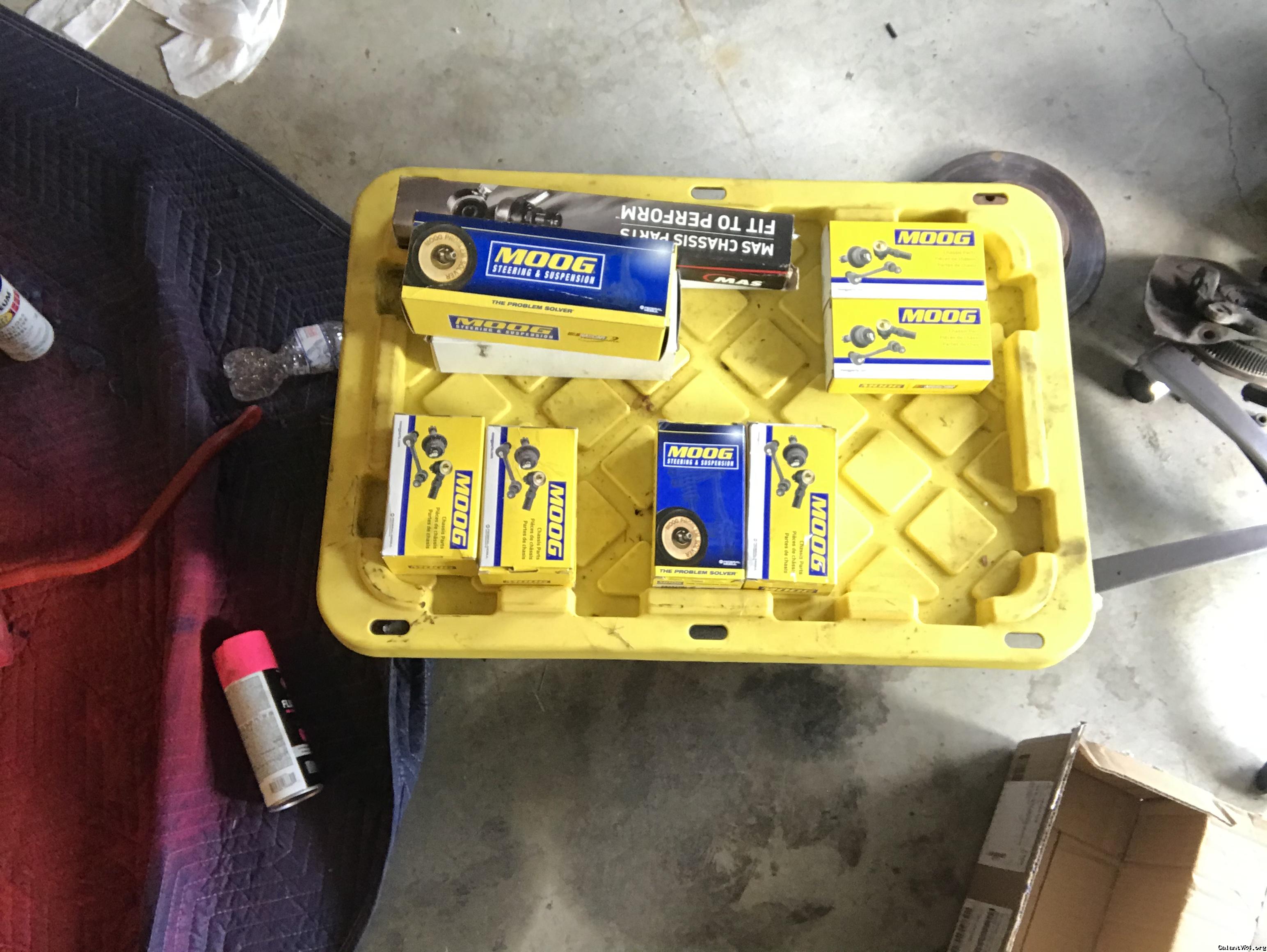

I also have these goodies /ubbthreads/images/graemlins/cool.gif/ubbthreads/images/graemlins/cool.gif/ubbthreads/images/graemlins/cool.gif

What did you use to refinish the subframe? Looks really good.
yubh8tn
Aug 21, 2019
245
coeur d alene, idaho
Quoting Gvr4-330:
Rustoleum. Self etching primer, semi gloss black, and then clearcoat. I used a lot of layers as I question its durability, but I left as much of the original powdercoating as I could for a bit more protection.
We'll see how it holds up /ubbthreads/images/graemlins/dunno.gif /ubbthreads/images/graemlins/dunno.gif
Gvr4-330
Dec 30, 2001
1,565
DC
Thanks. I need to redo my subframe and was debating spending ~350 to have it sandblasted and powdercoated or just doing it what you did. It looks good.
