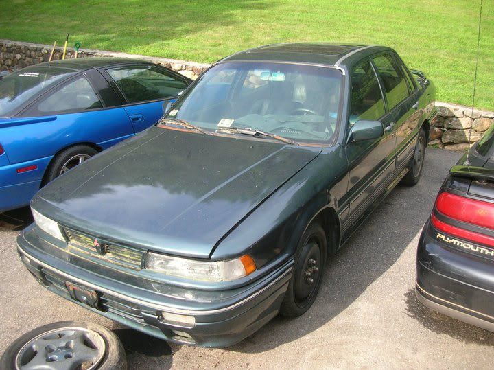

so a few weekends ago, i picked up 73/1000. my first gvr4. supposedly needed a "transmission and an FMIC" and that was the lot of it. also that the car was remarkably clean. while it is a pretty straight body, mostly clean, she has her imperfections. the body has some rust... im not very happy. i drove 5 hours for what was guaranteed to be a clean car. i got a halfway good deal on the whole thing, i suppose if i have to part it out than i could make back what i paid. til then, shes destined to be the spare parts gvr4 beater.
so far i have:
cleaned out the tons of crap that came with
installed good used trans/tcase
installed good used slave, ss clutch line
new 255hp fuel pump
removed 16g for fpgreen setup
new shifter cables (there were none...)
1g shifter
cleaned up/removed all rigged wiring
removed A/C
so when i got the car... the fuel pump housing was out, the tank was full of varnished gasoline, the pump had definetly seen better days, no shifter cables, ABS unit leaks all the brake fluid, no radiator/brackets, so on and so forth. id love to find another belize green or summit white roller and swap it all into it someday down the line... ive got to enjoy this one first. or at least try.
the good news: the key i got was a curtis brand key!
i need to buy the rest of my 5 lug stuff, got a 4 bolt rear and subframe ready just need the front spindles now. need the non-abs kit too. also need to buy a yoke recall kit as mine is so rusted i couldnt slip the transfer case on it... oh well. and the fpgreen with the manifold gate does not like the full size radiator, so half size time it is. a set of injectors, afpr, a gm map, then the VPC i got layin around goes in. got to fab some FMIC piping, and install this evo8 FMIC ive had collecting dust for so many years! so many little bits and pieces. i just want to drive the effin thing! soon enough. thanks for checkin it out.

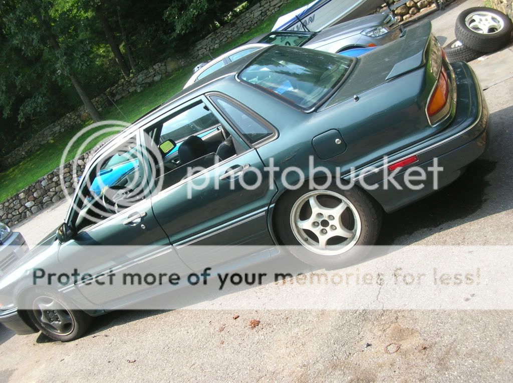

in its place went a very clean 1g TEL subframe with a MINT 4 bolt LSD rear, KYB's on 1g intraxx springs, and a set of 2g 16" GST wheels i got for dumb cheap. its slammed pretty good, i like it. the front struts/springs to match are in, just with the GVR4 strut tops. it looks very nice so far, i havent got the 5 lug spindles in yet (thanks Paul!) to do the swap and put the GST wheels up front but i like how it looks. the setup in the 1g looked almost too raked for my opinion, it still has a slight rake in the galant but it looks great! need to buy one strut to replace a blown one i found when i was swapping the springs around. also got a set of 5 lug drilled/slotted front rotors to top it all off!
FPGreen setup is all installed, all lines plumbed and re-worked. 255HP is in with all new nuts and a newer gasket. AFPR setup is in the mail (thanks mountaineerjeff!), got a fuelab filter (thanks Nate!) and i found a set of 680's locally. the plan is to run the VPC setup with the same injectors/pump/regulator i ran in my 1g that made 400 awhp. now i just need a wideband, an intake pipe, and an IAT sensor.

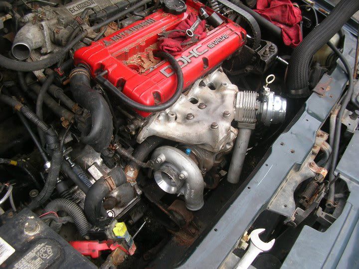

mocked up:
fully installed:
honda radiator is in, i need to cut the bracket i made and drill out the holes a little more and thats finished. the radiator hoses came from a 1g and only required minor cutting. with the outlet of the green, and the front engine mount, its a tight fit indeed.
the FMIC problem is the next on my list. i have a short route 1g FMIC kit, but i would need to purchase a Tial BOV. i also have an Evo 8 FMIC, and a turboxs RFL, which would require custom piping in order to work properly, however ultimately could cost less and require less cutting.

the good, the bad, and the ugly. earlier this month i had made quite a bit of progress. on wednesday, 73/1000 fired up and ran! the engine included in the car is okay.... so far. i ended up using the 1g short route FMIC setup i had laying around, and borrowing a TiAL BOV from the blue car. it came out nicely, the only thing left to do is to cut the bumper up to fit.
you cant see, but i had to make a funky contraption to conjoin the FPgreen and the 2.5" piping. when i do the prothane engine mounts, im going to clock the turbo up to change the angle a little bit. the wastegate dump tube has been cut, i think im going to unbolt it and rotate it to change the pitch of the dump tube. right now it would be blowing on the LICP, and thats not good.

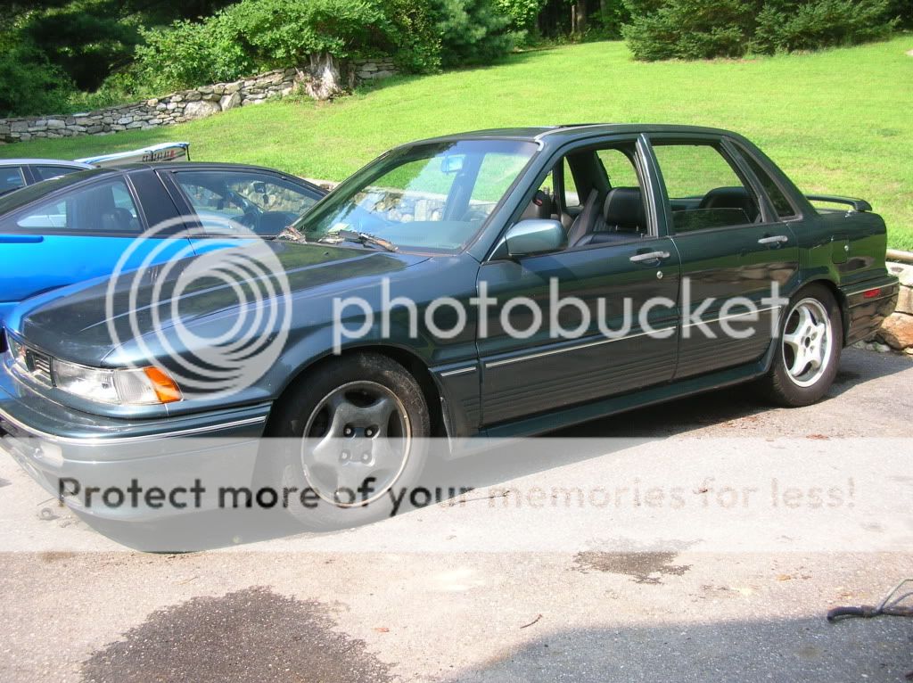

heres some pics for you guys to enjoy. im hoping to be driving this thing in the next few weeks. thanks for looking!

Looks good Phil. I'm really like the stance of it.
I might try some form of 1g springs on mine...

thanks fonz! i really want to change something around though. i had these springs in my grey car (intraxx, IIRC) and it had a pretty badass rake, so i figured since 1g rear springs are shorter that it would level out. i think im going to search for some eibach 1g awd rears to try to level it out a bit, as the rear sits a little lower than i'd like it to.

Have you driven it around yet? I'm curious to the ride being that low. I got Evo suspension and won't be sacrificing the shocks, but I have a feeling 1g springs will fit.

i havent driven it yet fonz. started it weds to find the fuel line leaking, and this morning after finishing the rear brakes, come to find out one of the hard lines is broken and leaking /ubbthreads/images/graemlins/frown.gif
frankly, if the money was there, id just do a set of coilovers and be done with it. that'd be the right way to do it. although i was suggested 2g upper strut mounts to correct the too low in back condition. gona research that and try it. would be nice to get it to level out. with the front struts being in good shape, i dont think it should bottom out unless i start flyin over some really rough surface... but the rears being tucked as they are, i do worry a little.
