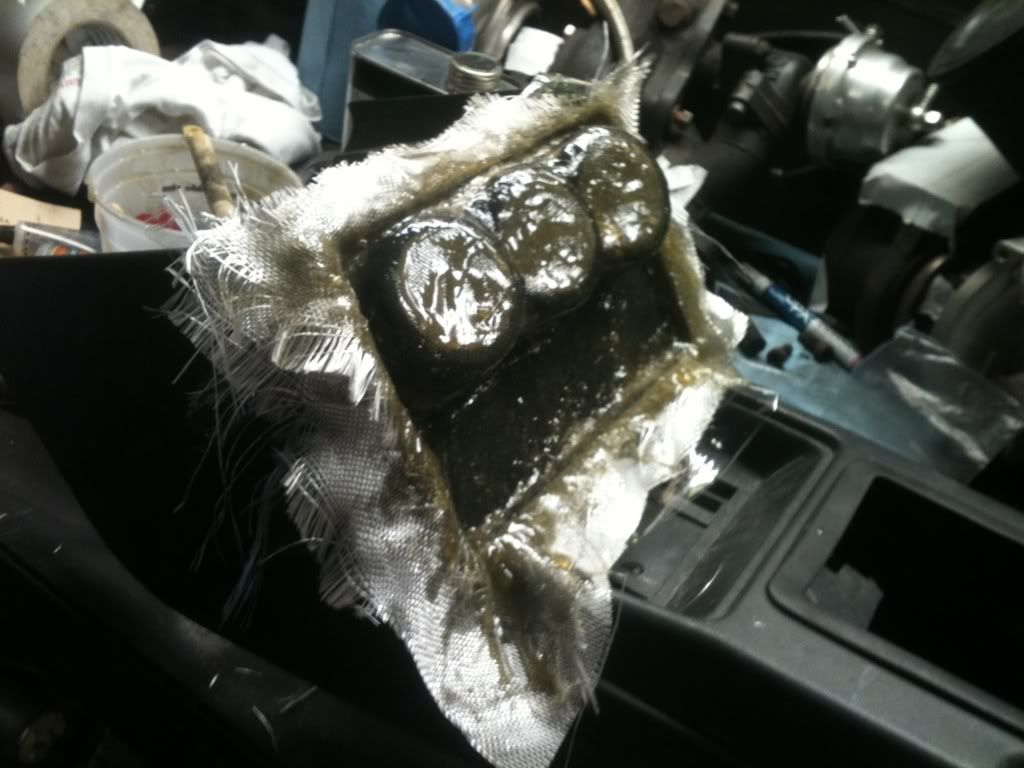

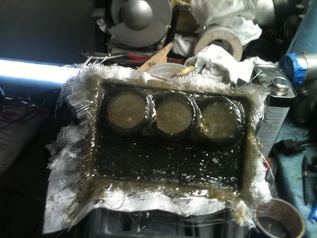

Here it is, got the gauge pod fabbed up. Still need to add a few more layers of fiber glass and it will be done. I need to make the cut out for the radio. The options for gauges in the galant suck. I don't like where the gauges have to be but with the gauges angled up it makes is a little better.
That makes five layers of fiber glass. Should be plenty strong enough to hold the radio. But just to be on cautious side I'll make some reenforcement once I have the cut out done.

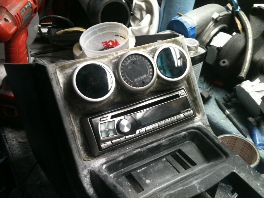

Here's a little update, I wanted the gauges up as far as I could get them. that's why I put the radio on the bottom and tilted the gauges. I still have a lot of work to do but this is where I'm at right now. Comments, concerns anybody?

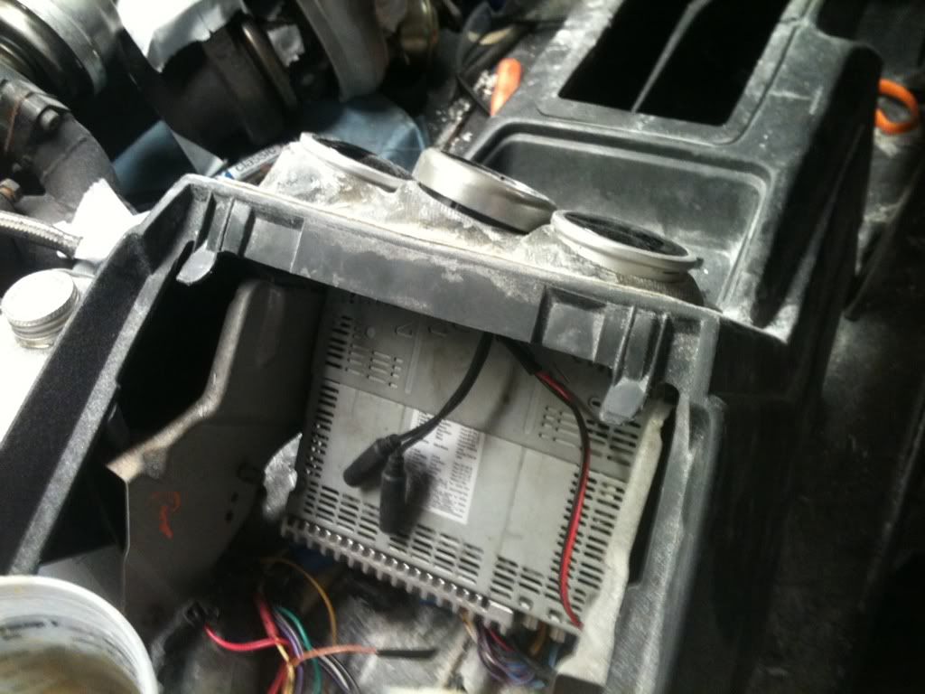

The gauges look good! How do you tighten the fiber glass plate on the console? I had my after market sound system stolen, the robber cracked the console on the facia of the plate, its all hacked up and i do not remember how the stock ones go. I will be making another setup like yours and need to know what you did to screw it in place.

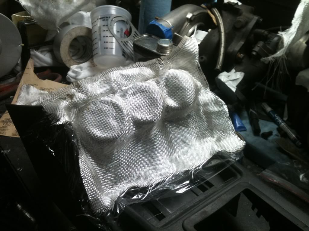

I made it with a lip on the back of the top so it kind of snaps in and I made it fit very snug. All of that plus the weight of the radio holds it in. I never had the stock piece to go by I just used plastic wrap and got the fiber glass mat to be the same size as the console. if you can work fiber glass its not hard.
