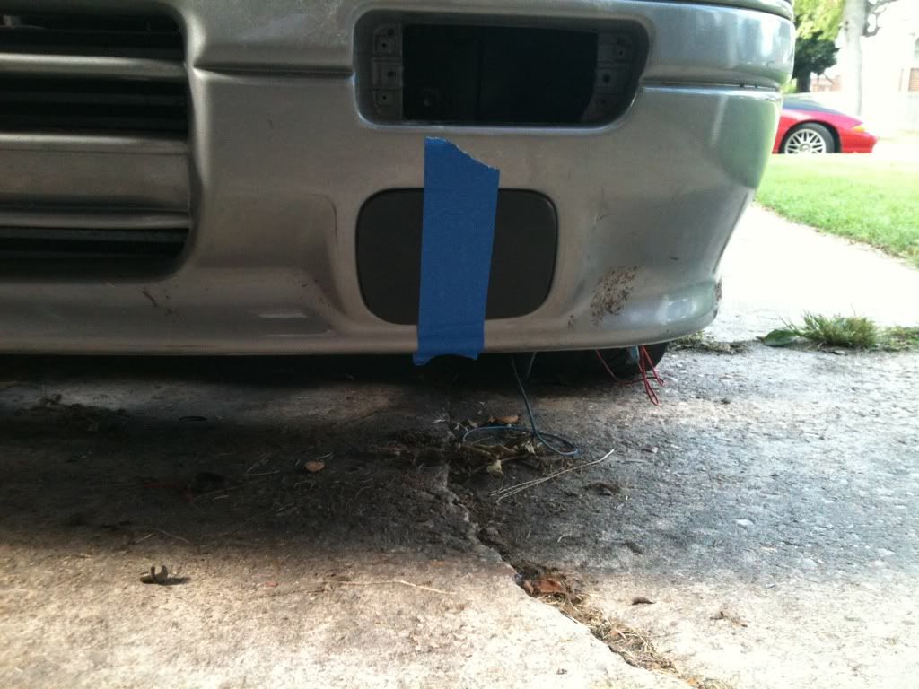

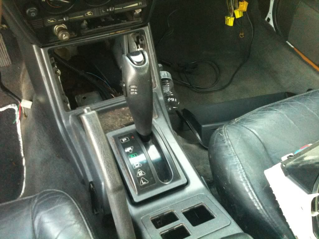

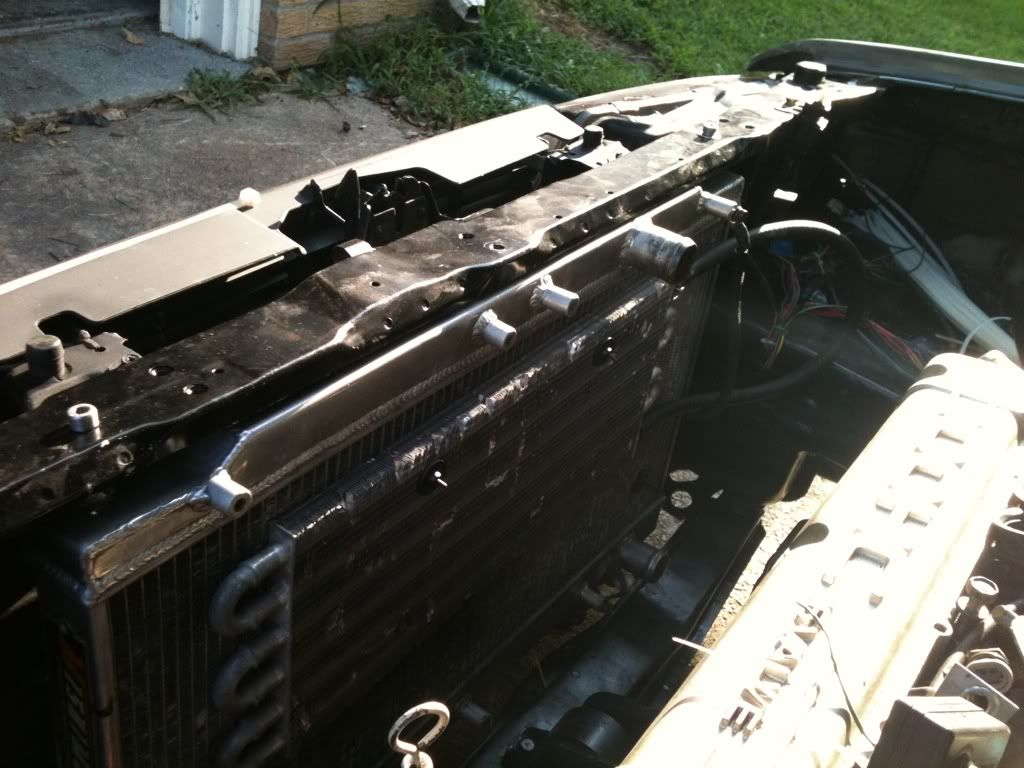

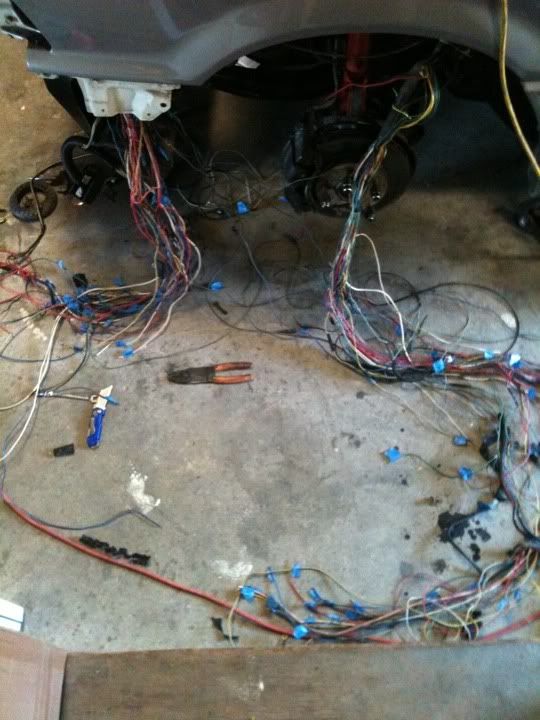

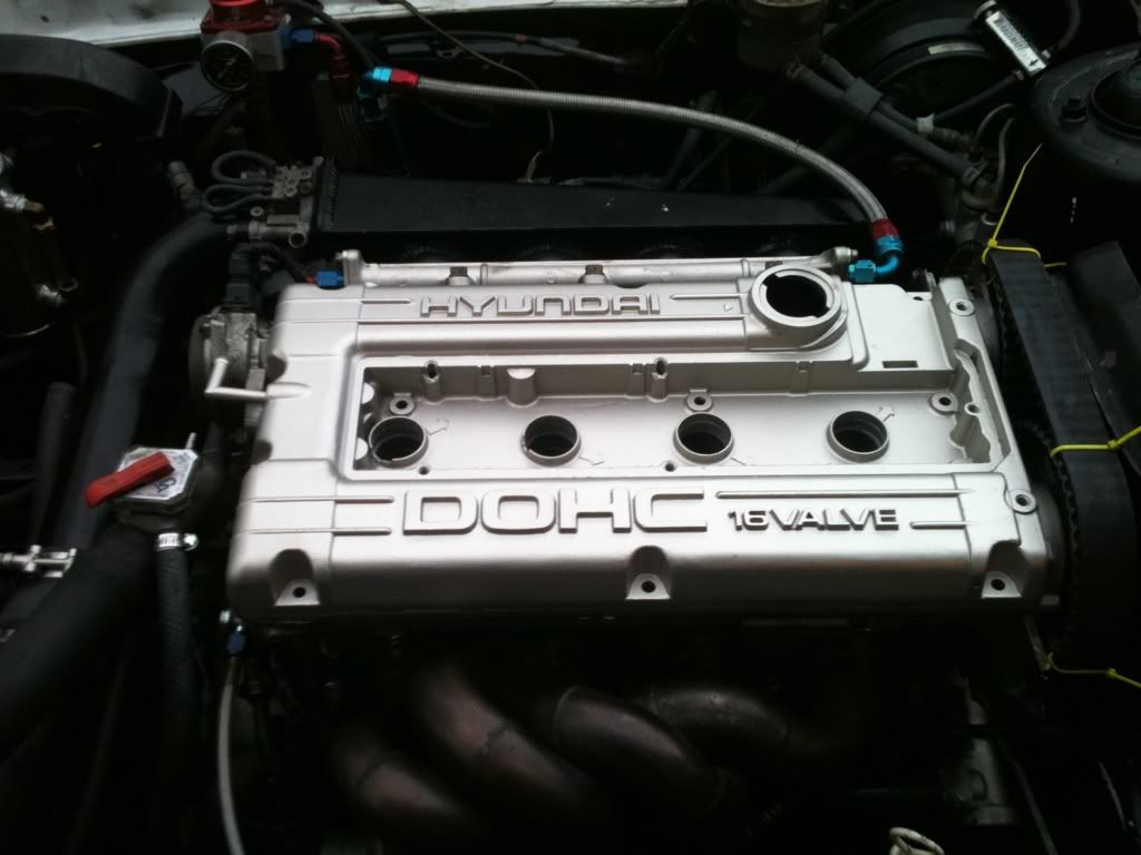

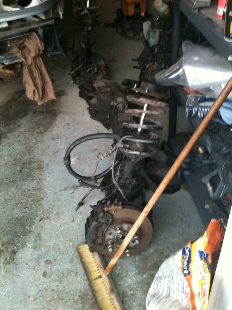

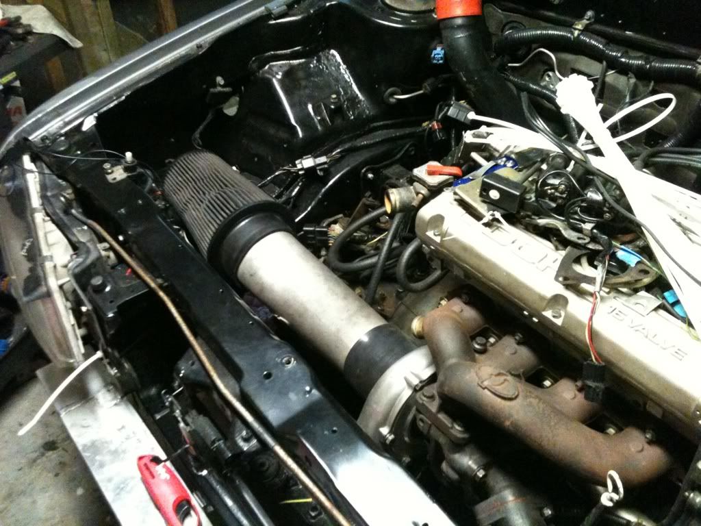

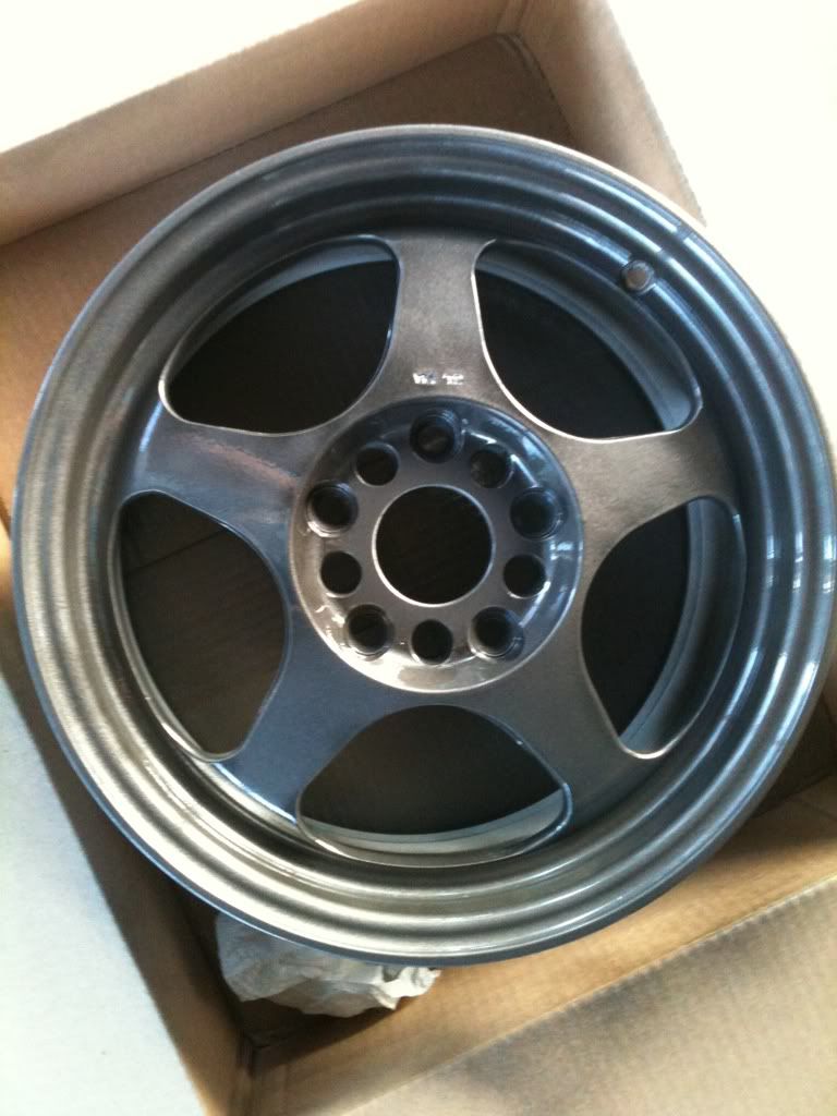

Picked up this car from Ren a few months ago. It is a pretty clean rust free car and mostly all there minus the obvious motor/trans/ and all that. The quick of it is, I swapped out the entire suspension, subframes, rear end, engine, trans, fuel system, intercooler and radiator out of my Laser. I is an Auto now and from what I understand one of very few said auto swapped VR4s. I had to drill out the factor welds on the lower radiator mounts and slide them about an inch and a half to the drivers side so the intercooler could pass through the core support. I have also relocated the alternator to the back so I had more room for intercooler pipping. It's going to be powered by a ball bearing GT3088, 1200cc injectors, managed with AEM EMS, and probably running on E85. It should be a lot of fun to drive when I'm done. It's getting really close. I have to decide what wheels I want to run, I have a few options one of which is a set of 16 inch rota slips in gunmetal. I have to make a list of what's left to do and start chipping away. Now on to what you all came here for, I'll let the pictures tell the story better than I ever could.
Here it is the day I got it.

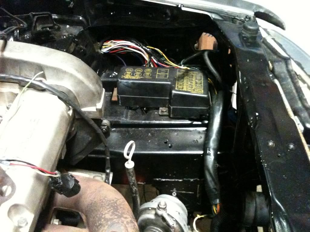

fuse box

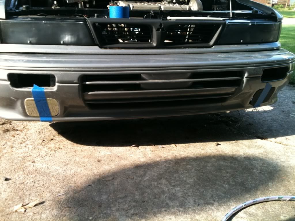

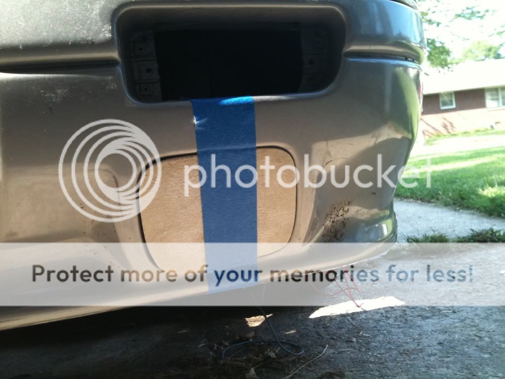

fog light hole covers
Pure sex right here ladies and gentlemen...
almost forgot
now let the bashing begin!!!

With a 30 series turbo and E85, 1200cc injectors may not be enough, depending on whether or not you want to push the turbo.

I have my concerns about the injectors, for now if need be I can run higher fuel pressure until I get some bigger injectors but I want to be sure that's what I really want to do first. I should add that I will be running a dual 255 setup as well just have to finish building it. Ultimately like Cherrod said my plan is to get a hta68 and with that turbo I should have plenty of injector with the 1200s. Once the car is all together I'm going to get it tuned with a pretty tame tune so I can save it from my destructive ways and maybe keep it together for a while. In that time I will start building a motor. As far as what motor I'm kind of on the fence about staying 2.0 or going stroker. I would love to have a torquey motor so lately I have kind of been thinking more along those lines. Probably get some different cams too. I have a set of comp cams now. I like the fp cams but still need to do some more research and figure all this out. When all is said and done, should be a good car to take my daughter to school in and get some groceries. To the auto laser guy, all this car out of my auto laser... /ubbthreads/images/graemlins/wink.gif

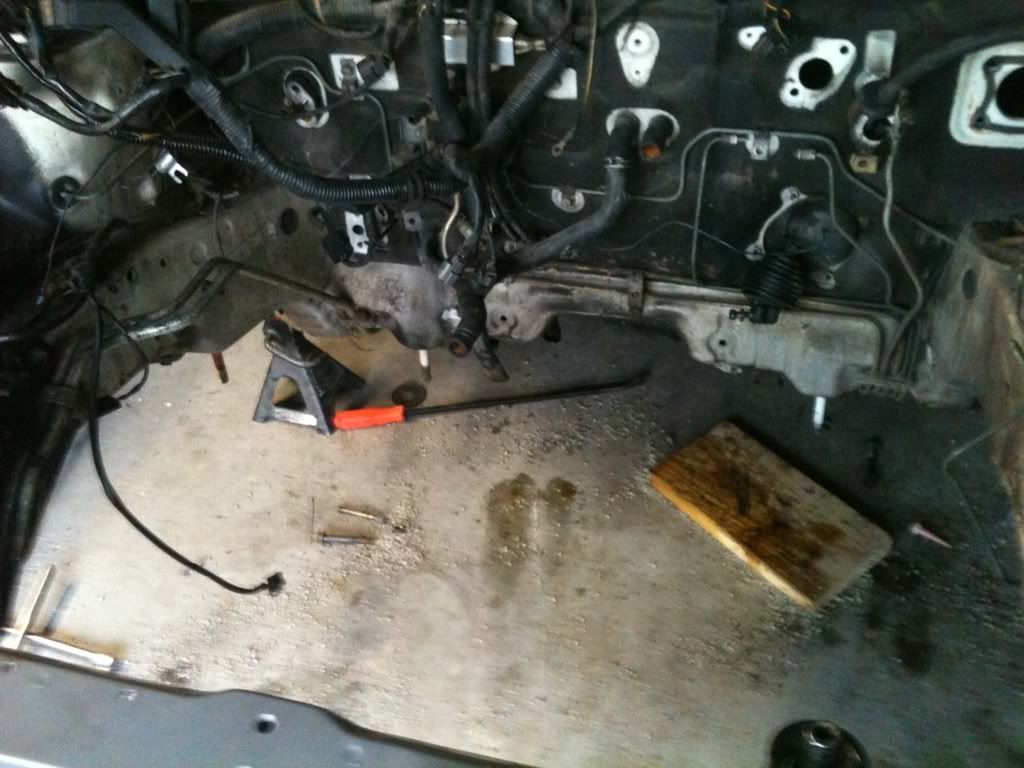

Well the rear end has to come back out, I have a very big clean puddle of differential fluid where ever I put the car. my luck sucks.

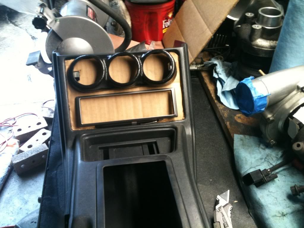

Terry Posten
Dec 16, 2003
9,009
Davenport, Iowa USA

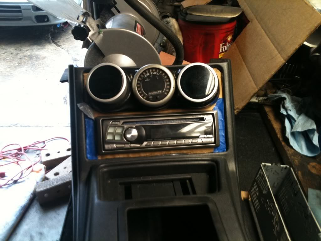

Curtis makes one exactly that orientation.
I had one, still may but I went with a 5 gauge setup and a hidden amp and an iPod cable.
Check my members ride post (link is in my sig at bottom) if you want to see it. It is in the older interior shots, I just flipped mine.
