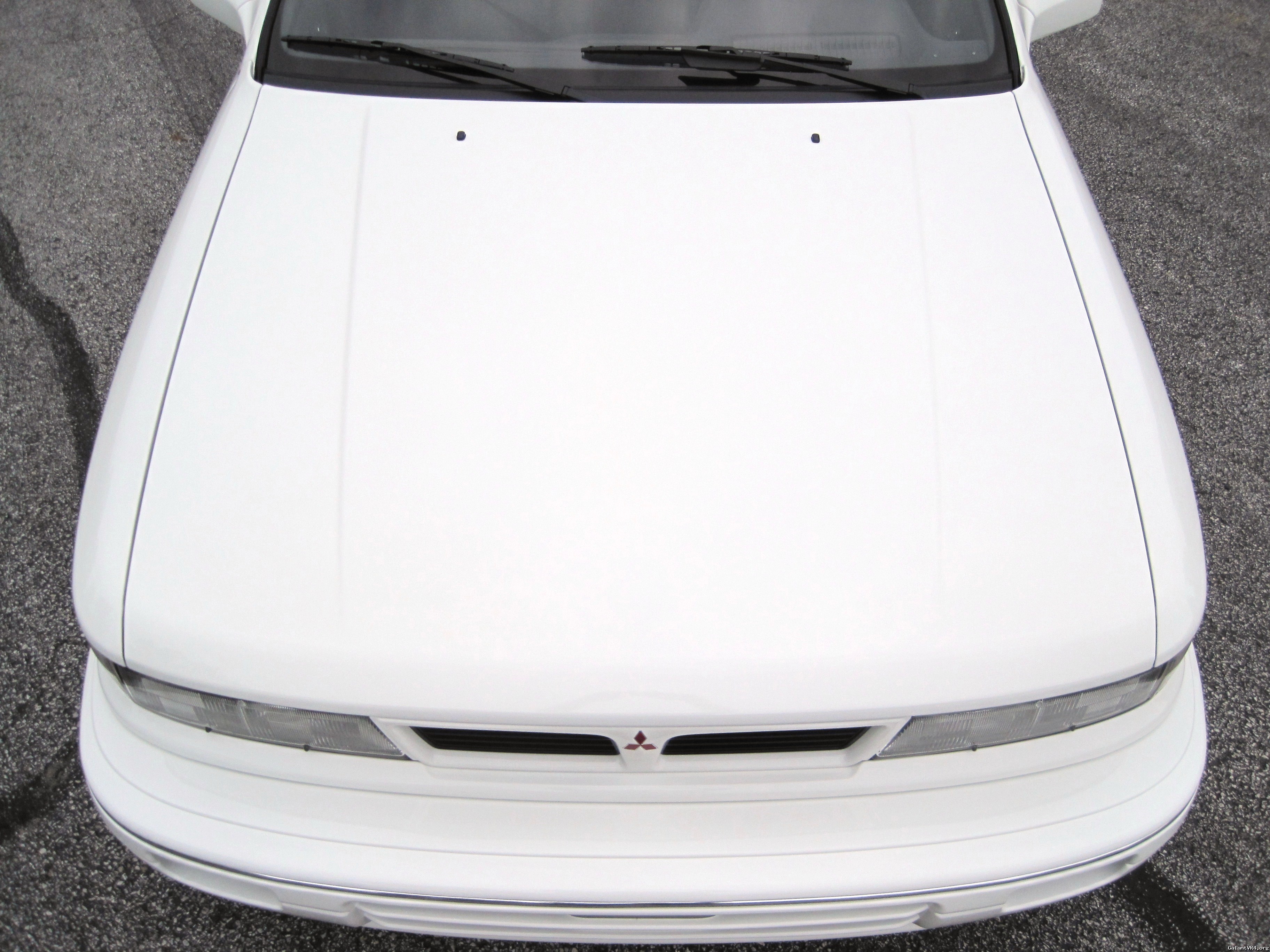

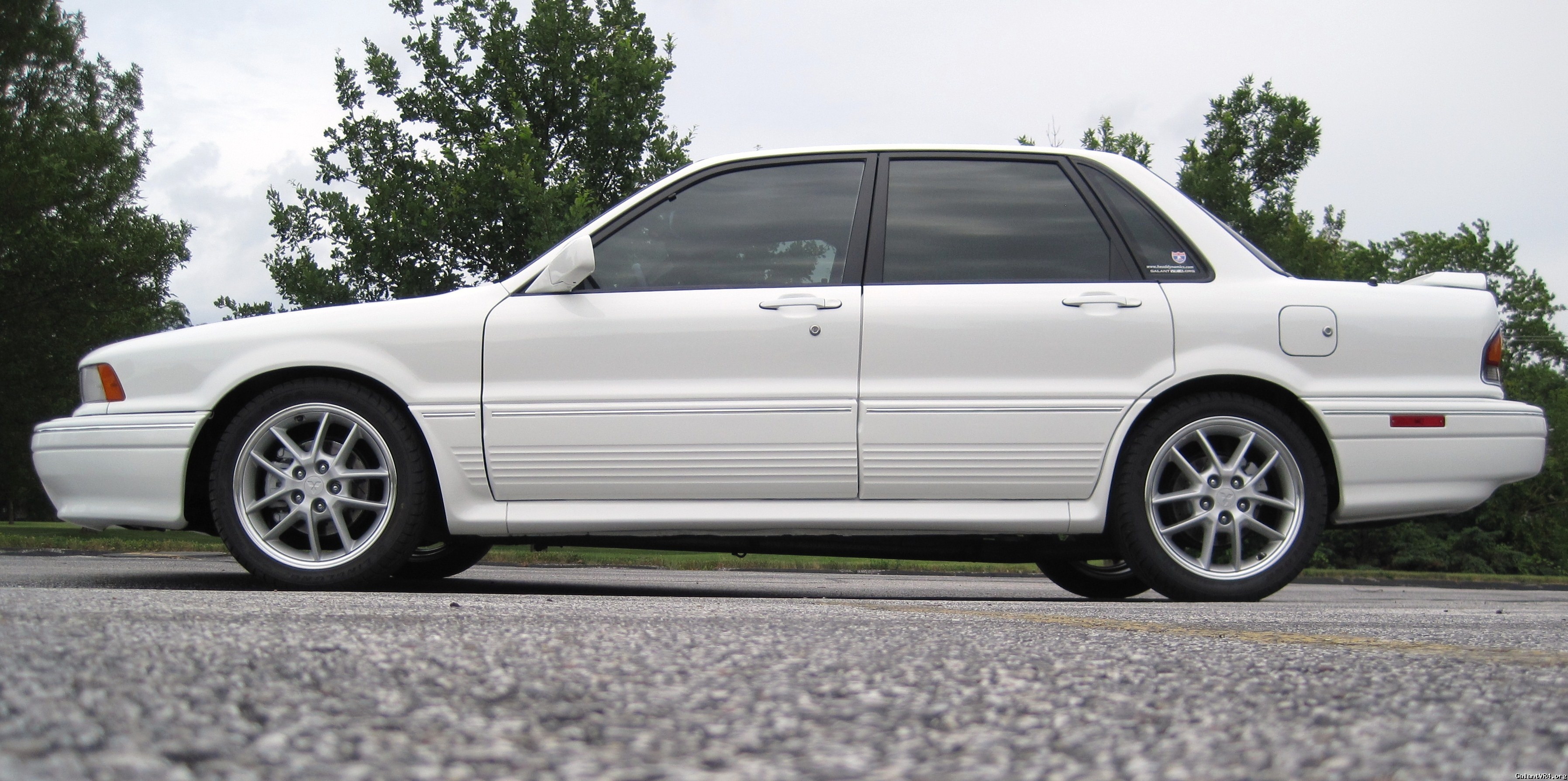

New paint by Tom Lindle
Factory Summit White
New emblems
New chrome
White handles
Rustoleum oil based flat black undercoating
Complete engine bay restoration
Looks like a new car

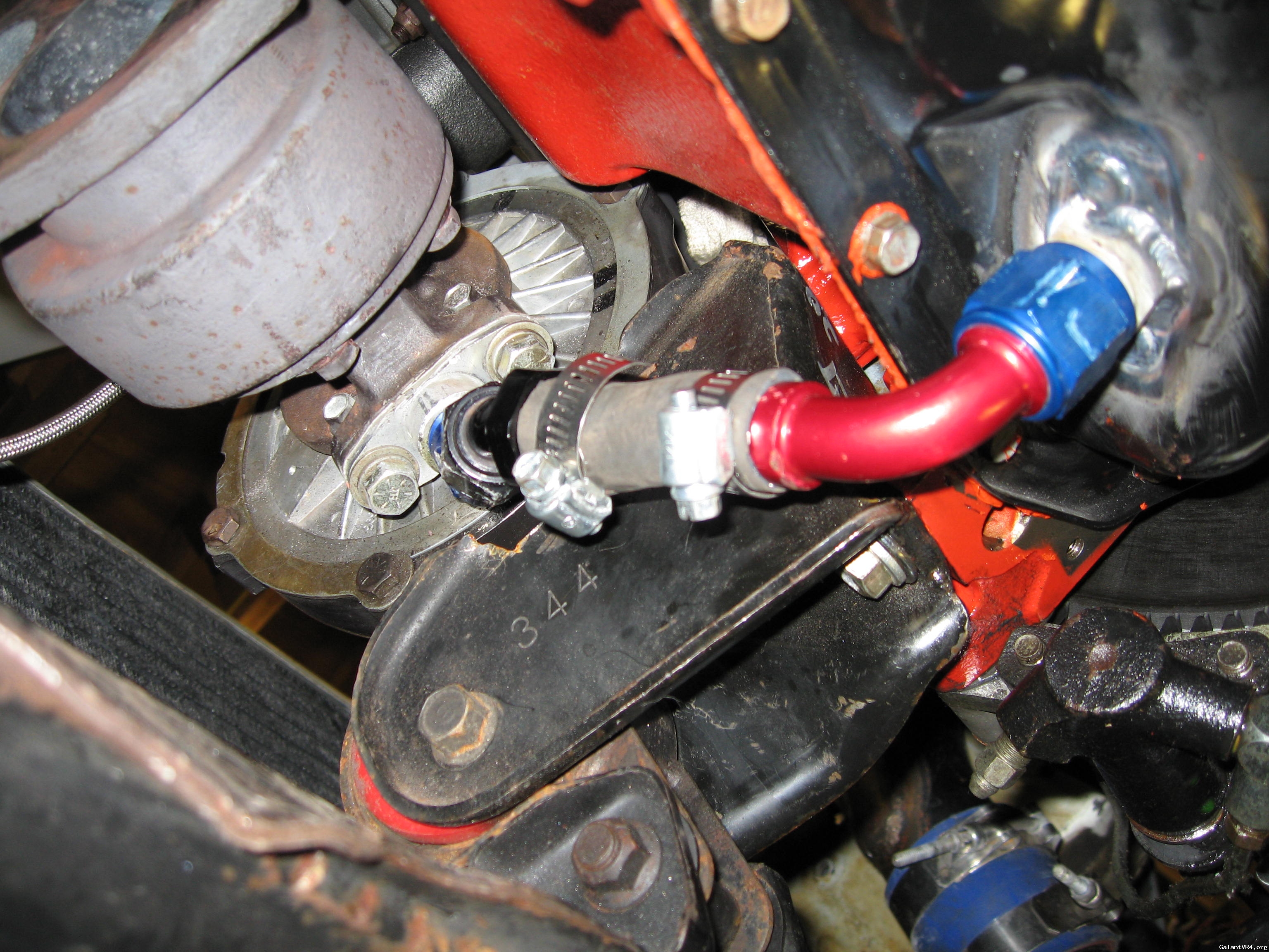

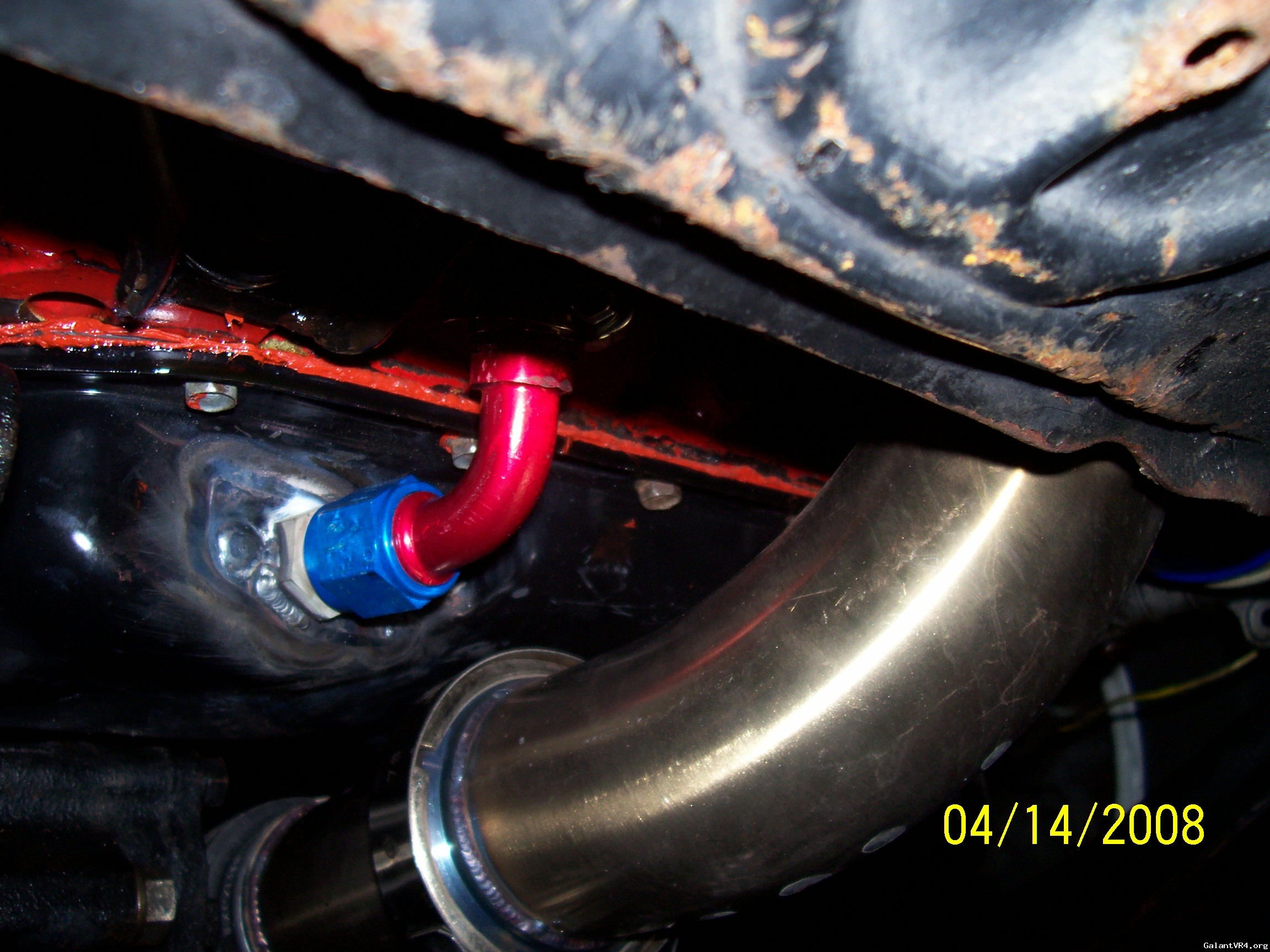

Stock oil pan with -10 drain fittings

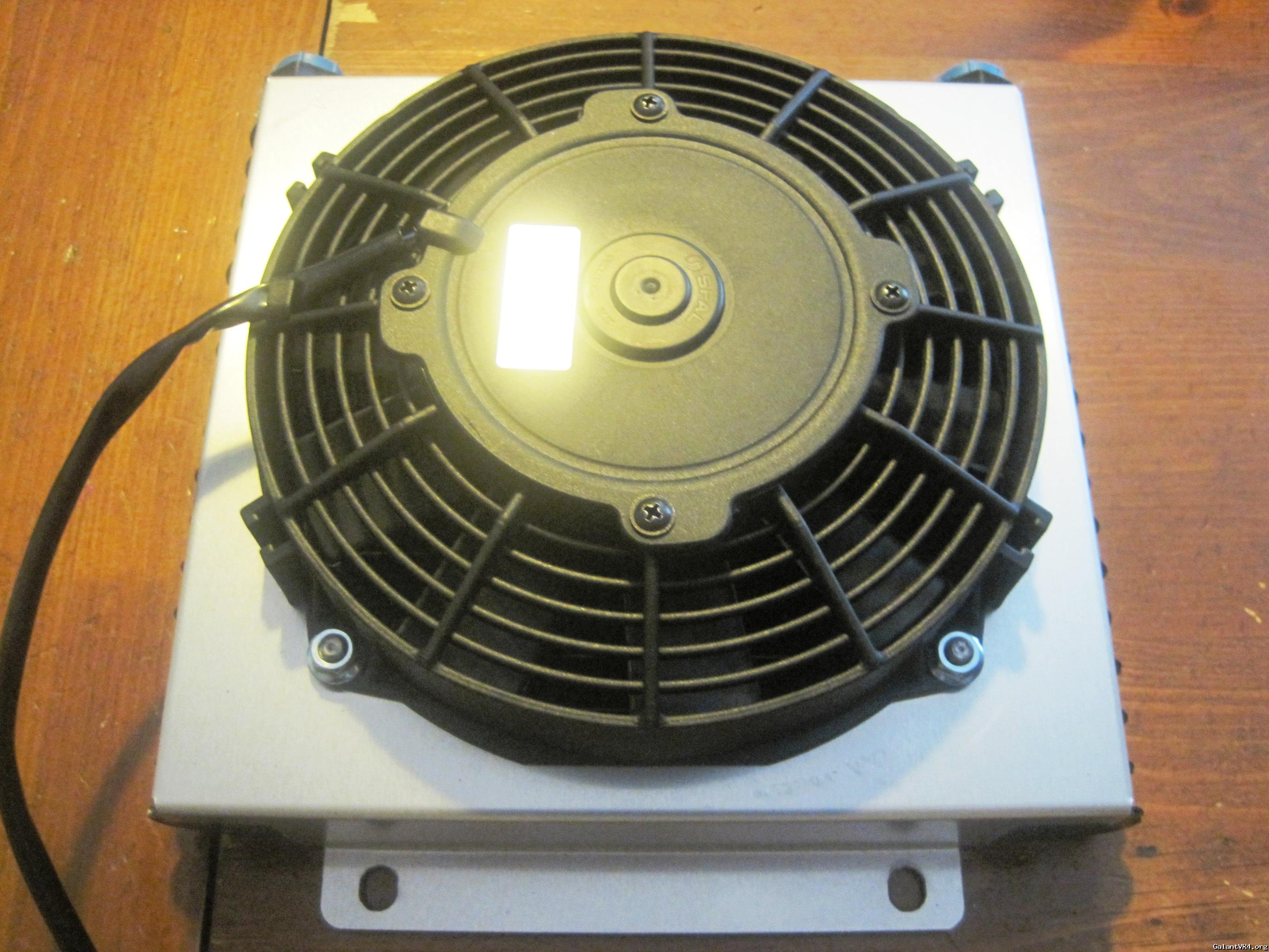

Custom 10"x10" oil cooler w/8" fan and -an10 braided lines

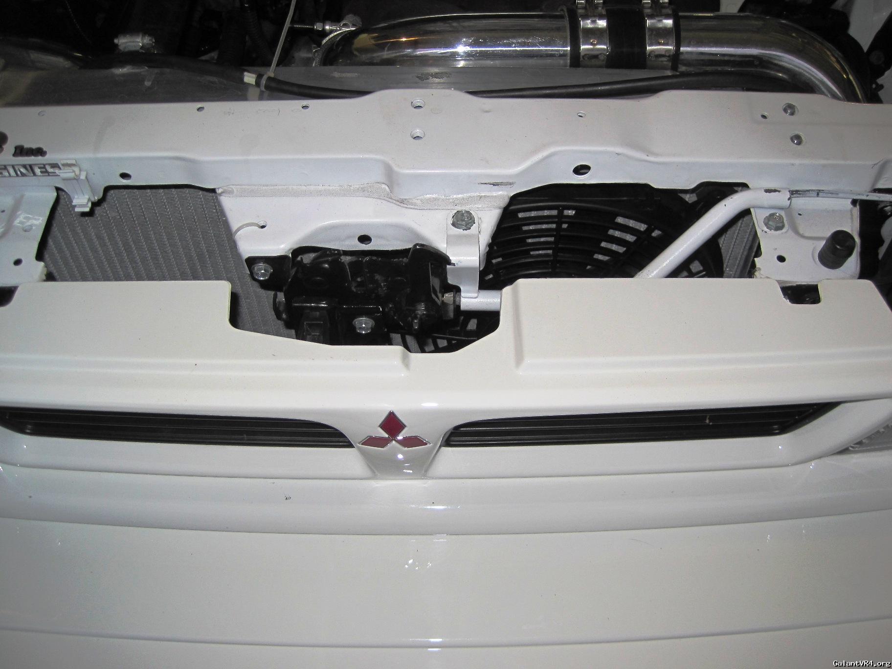

1G style aftermarket Radiator w/twin 12" fans custome setup for 160 degree operation

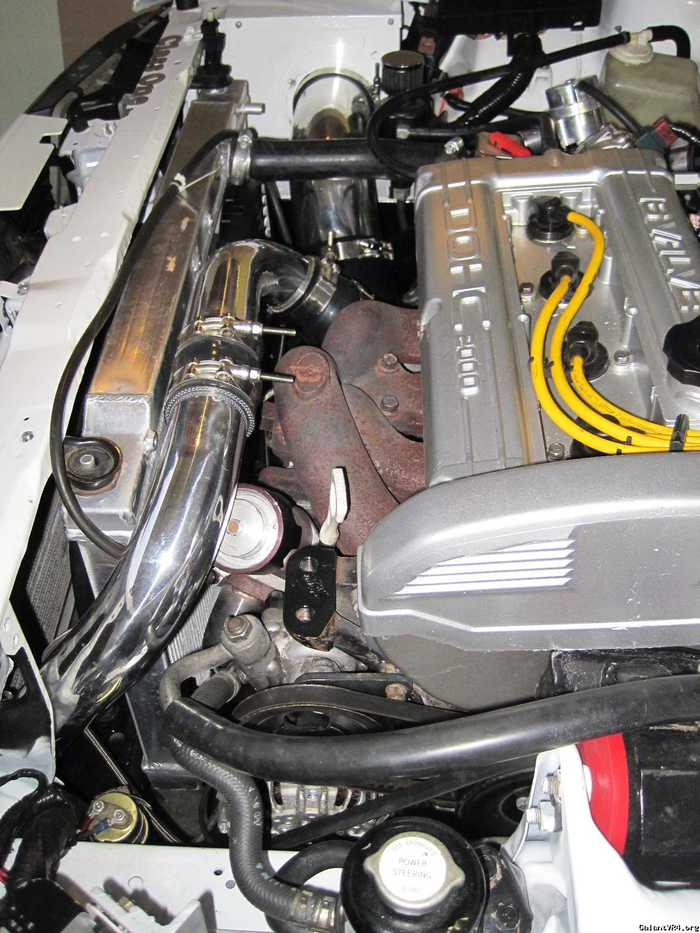

Forced induction

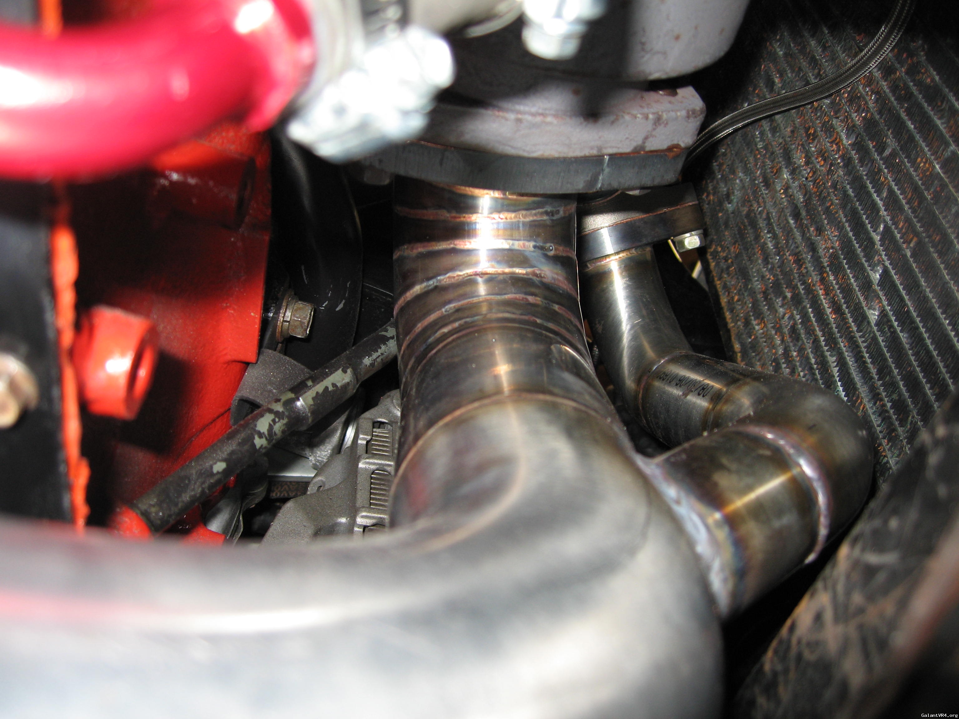

PTE SC6152RSP A/R .70 ball bearing
FP Race exhaust manifold
JGS external wastegate

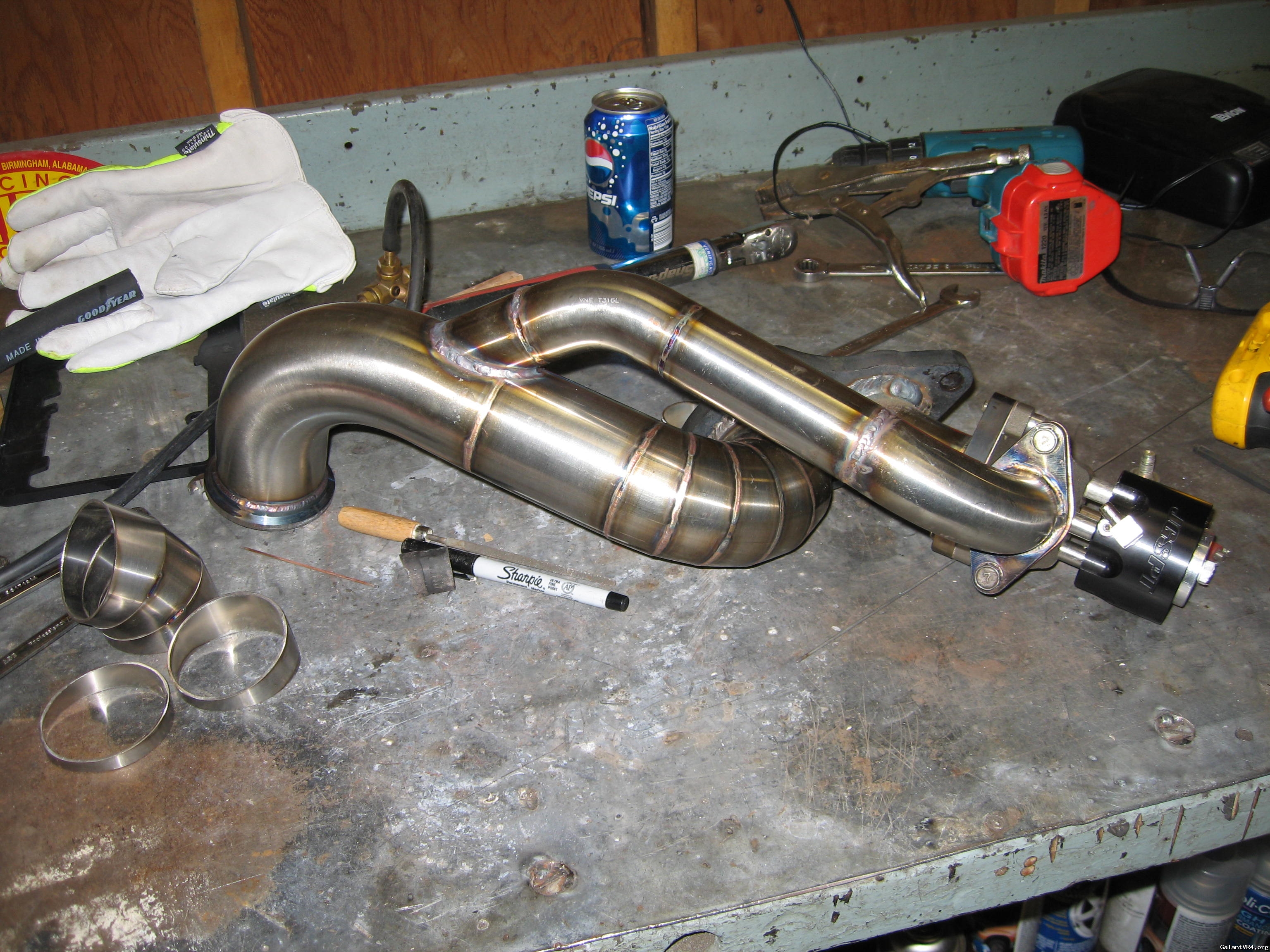

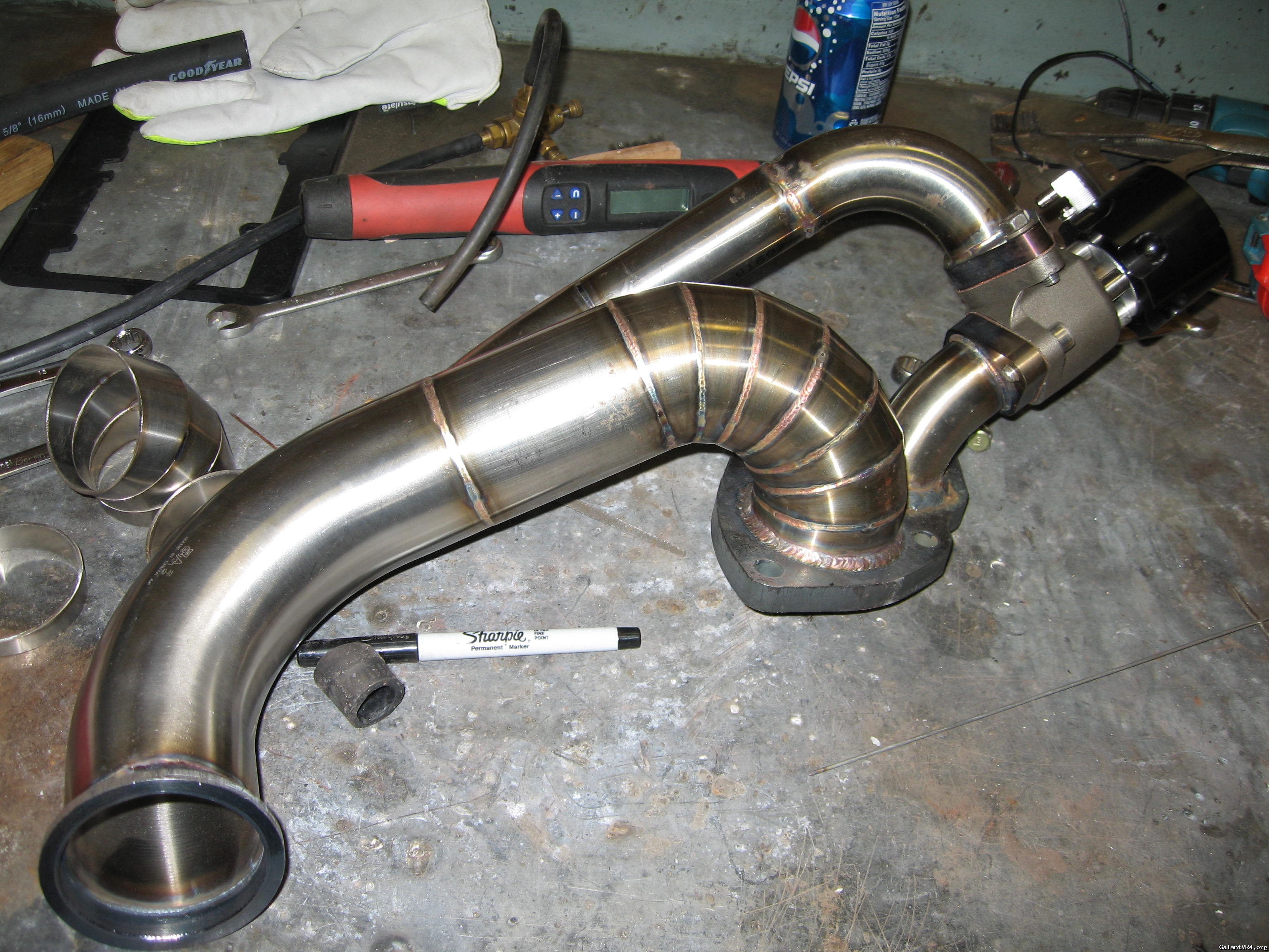

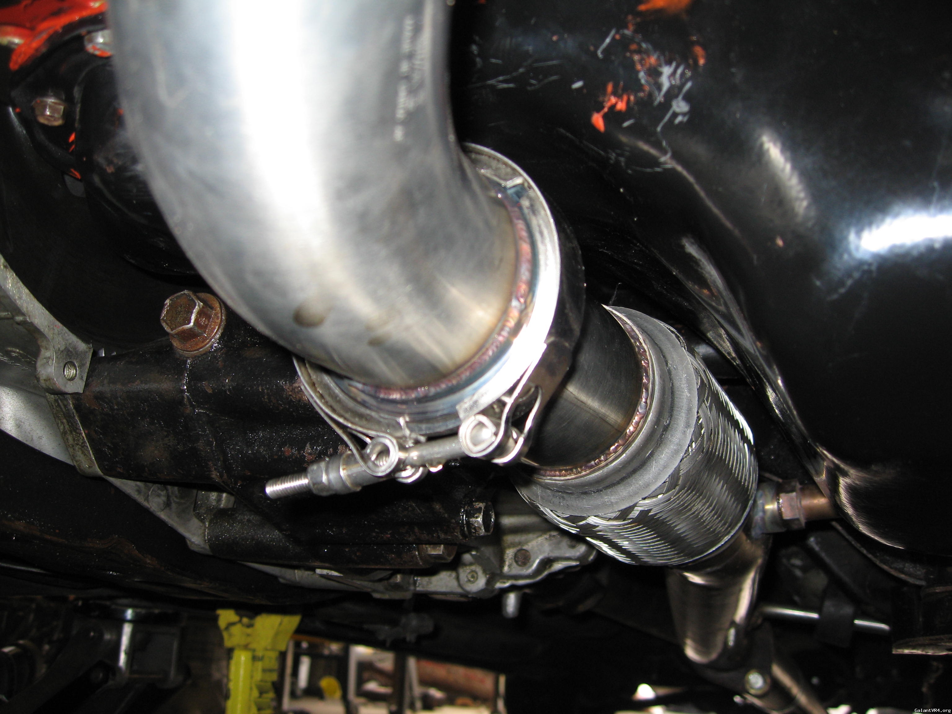

Custom stainless steel down pipe (Head Dynamics one-off work of art)
FMIC and piping from Extreme Turbo Systems
Forge BOV (vented to atm)
4 Bar Speed Density
GM Intake Air Temp sensor
4" aircleaner setup with a cold air box
Lower Shores Performance MBC

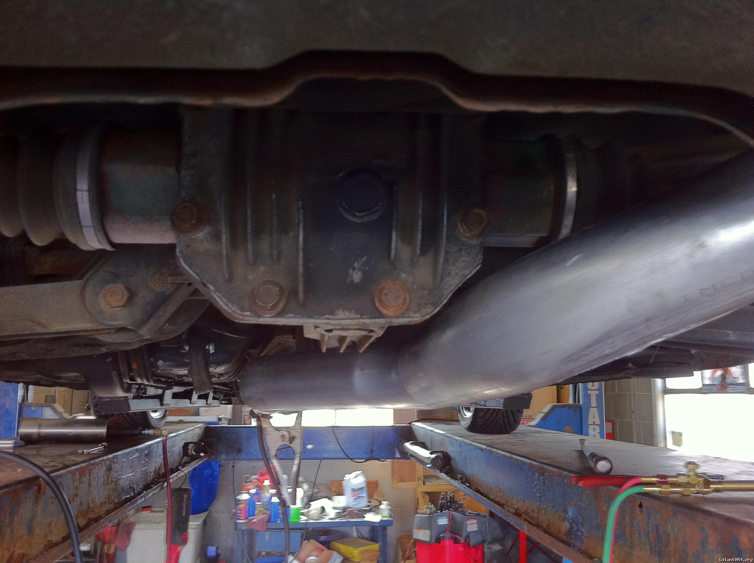

3" turboback exhaust w/o cat

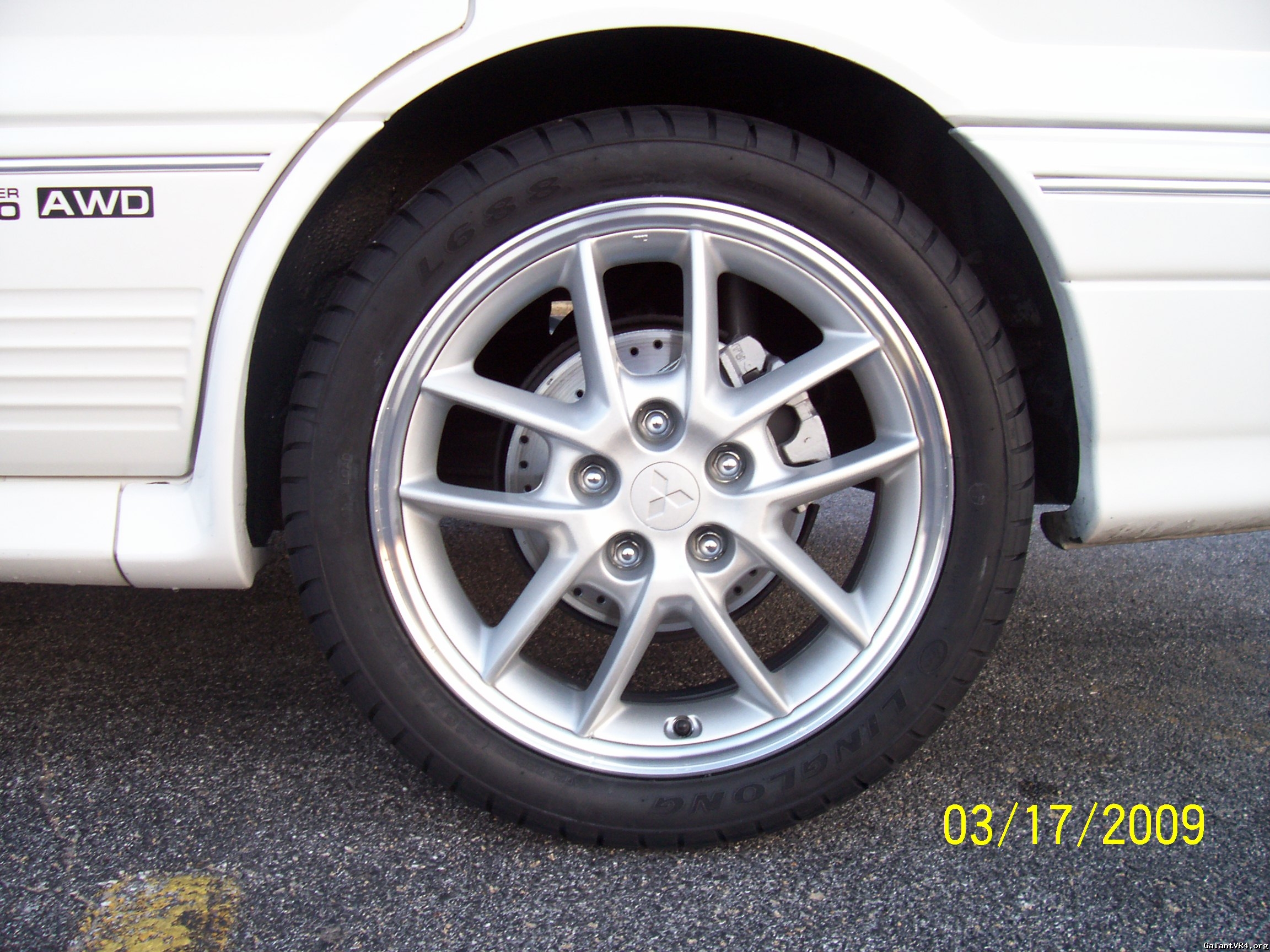

New rotors - 5 lug Stop-Tech cross-drilled/slotted all around
Yingling 215/45/17 ZR Ultra High Performance rubber
Enkie 2 piece OEM rims (won at MOD 08)

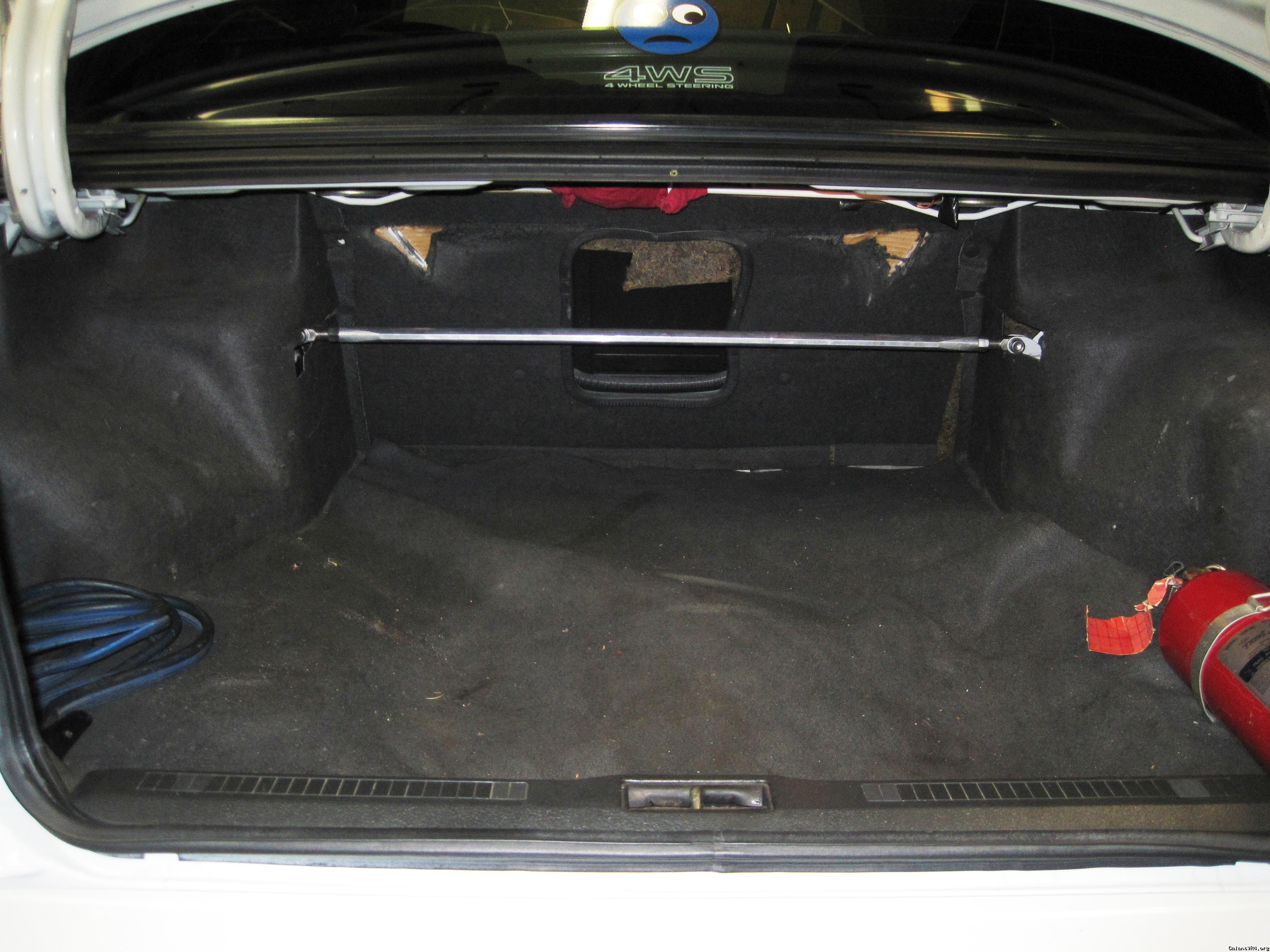

Whiteline rear strut tower brace

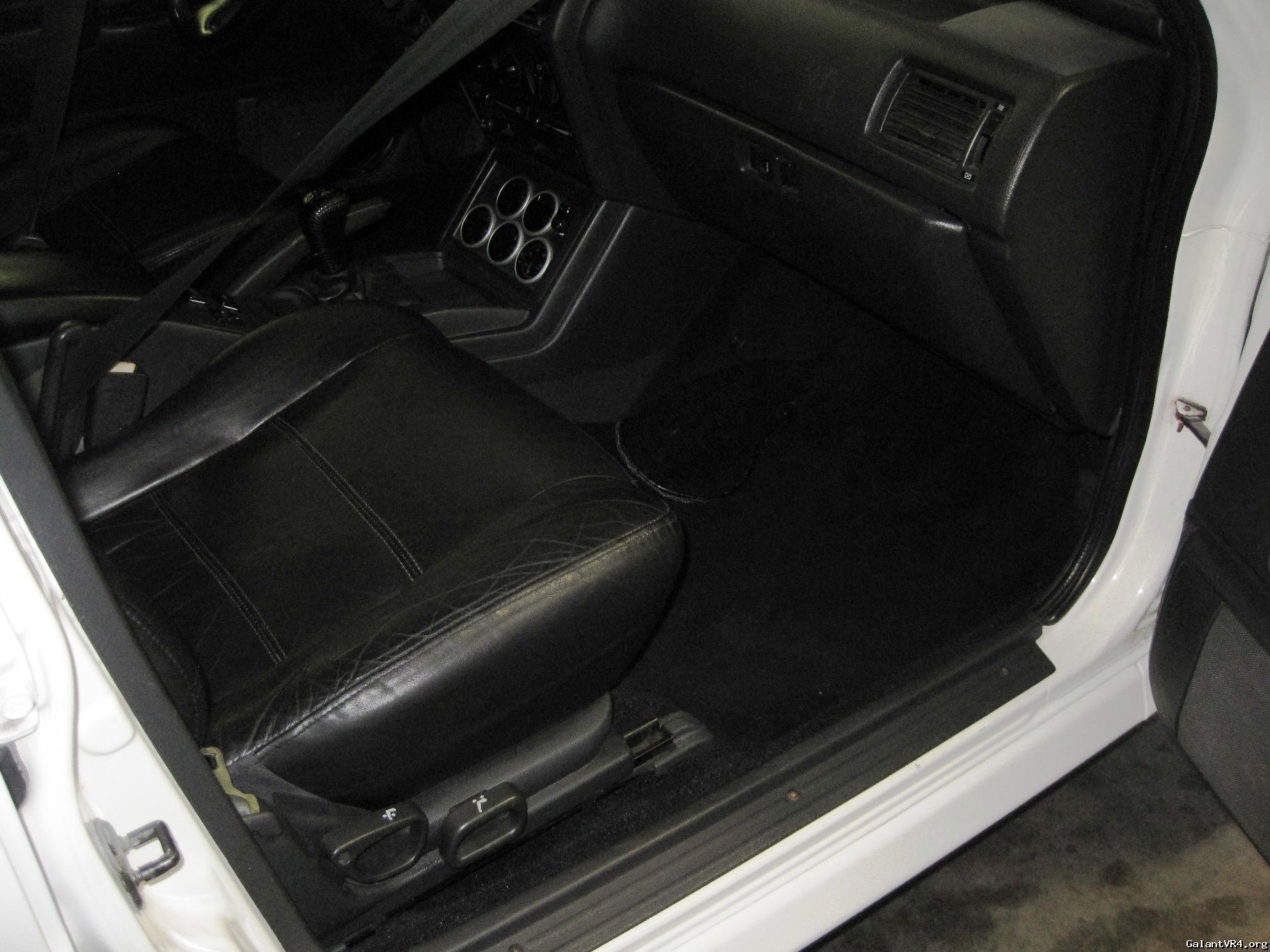

PLX WBO2

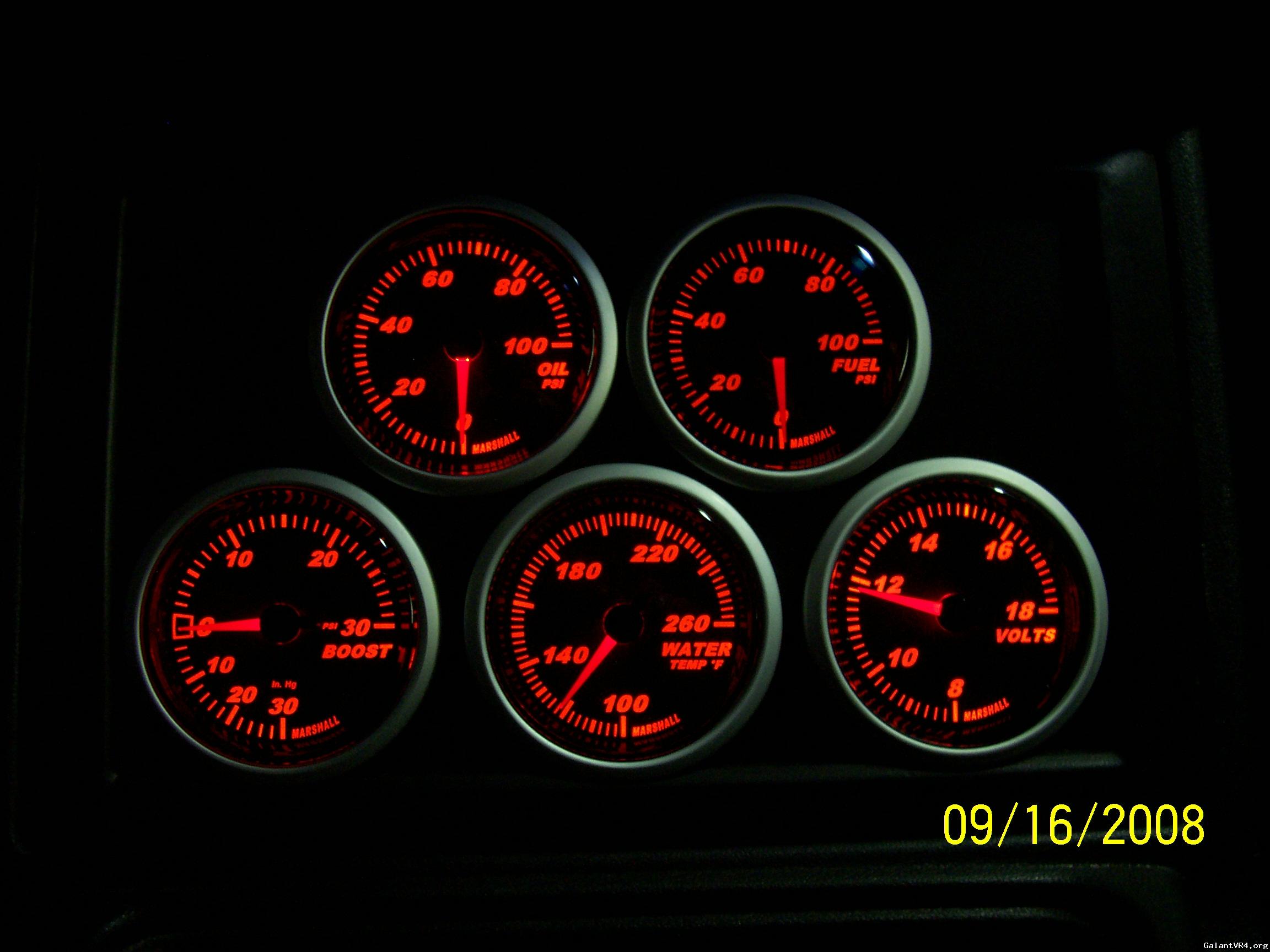

Marshall Oil Pressure gauge
Marshall Fuel Pressure gauge
Marshall Boost/Vac gauge
Marshall Volt gauge

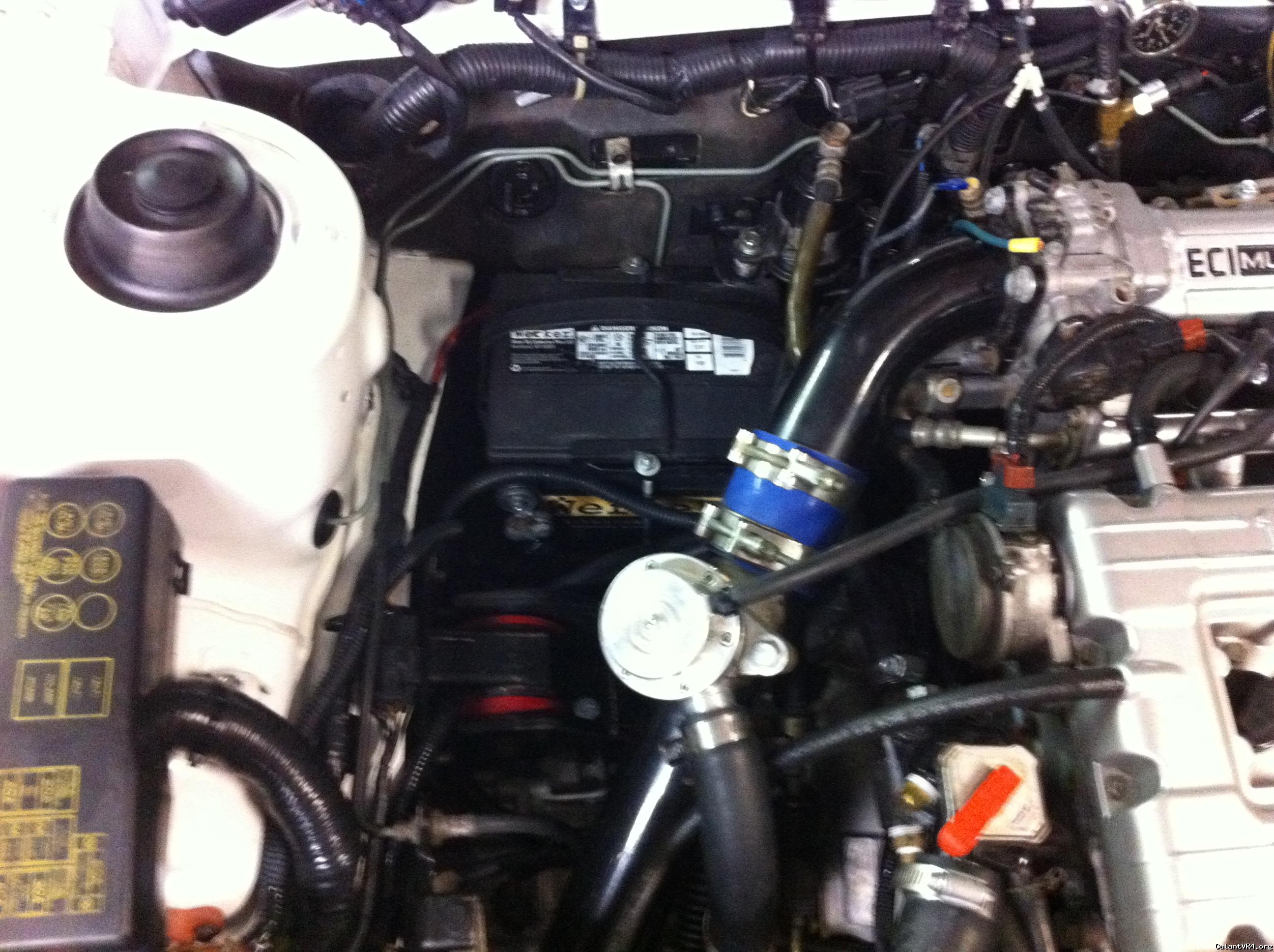

Relocated full size battery to firewall

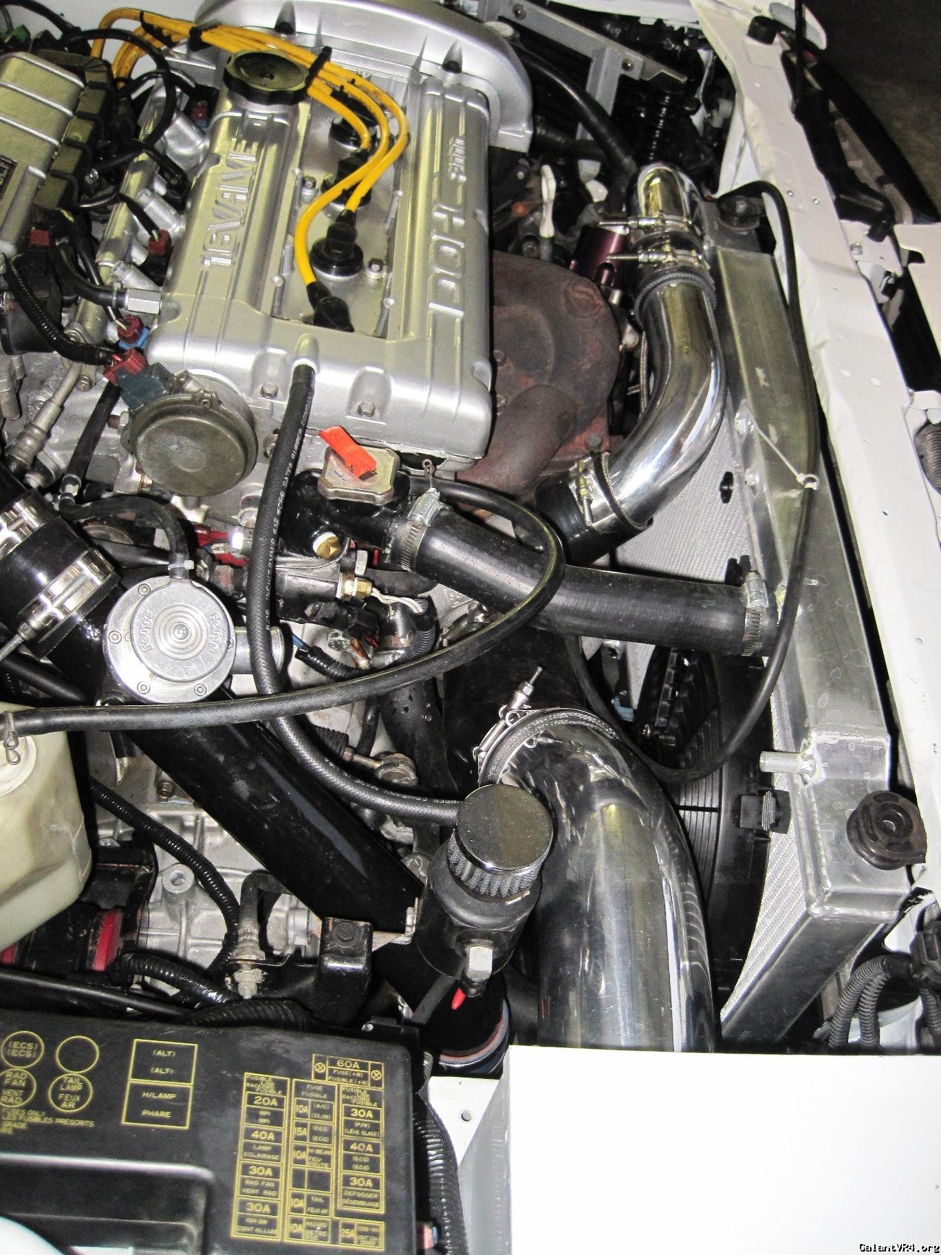

Pictures taken in July of 2011. New engine bay paint, speed density setup, EVO III transmission, new intake piping, radiatior setup, etc...

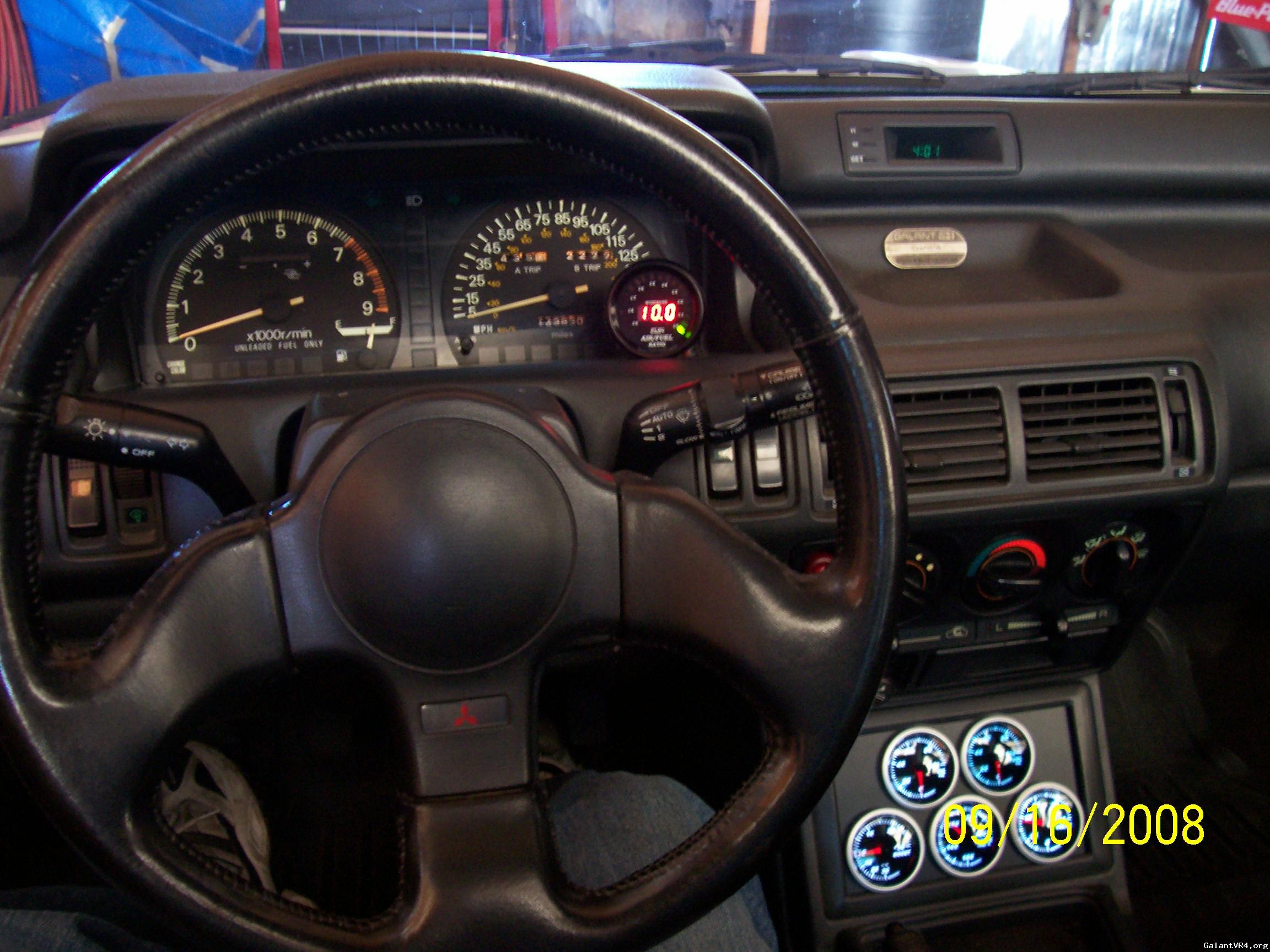

Gauges change color with dash lights

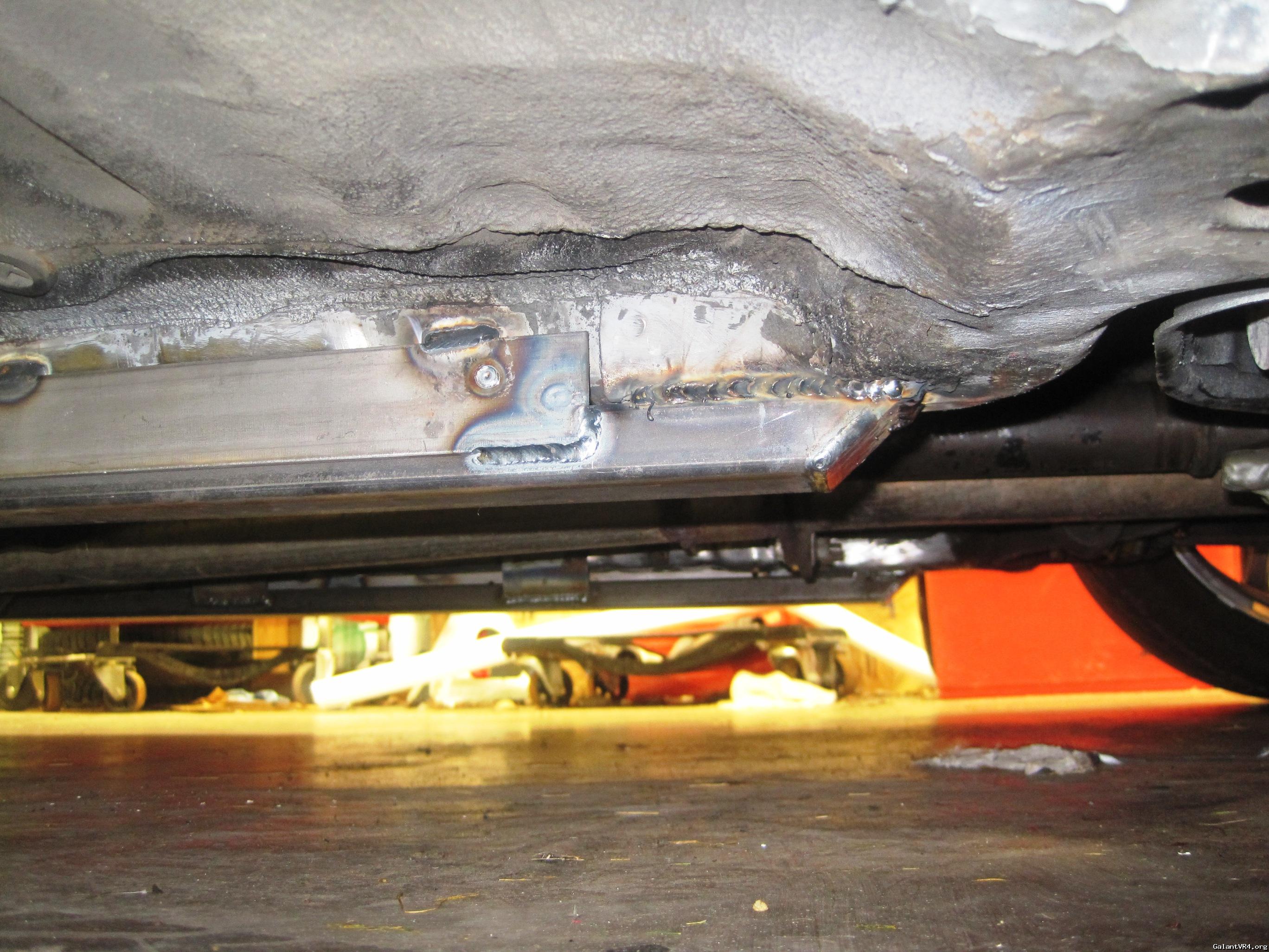

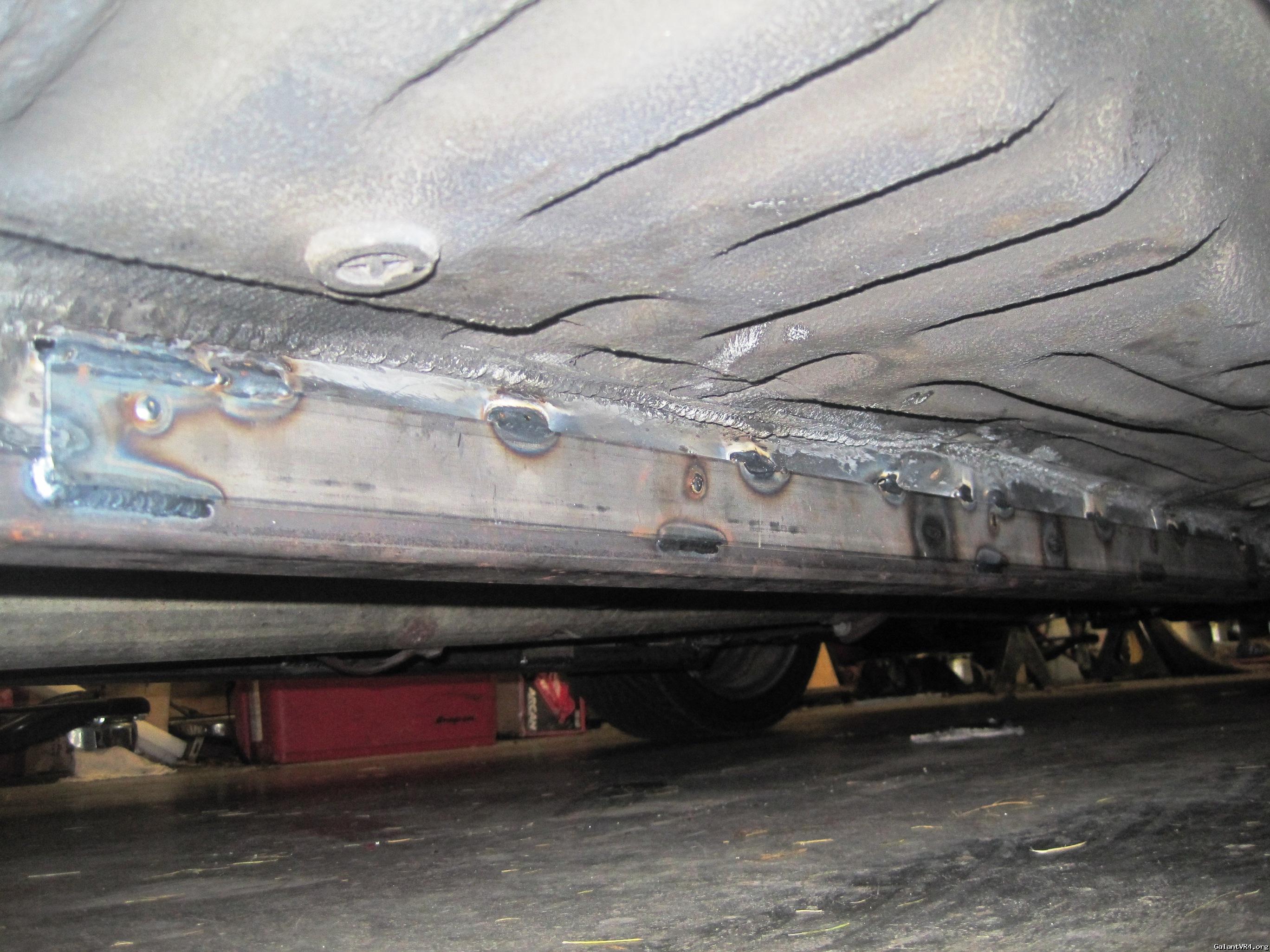

Curtis rails (before new undercoating)
