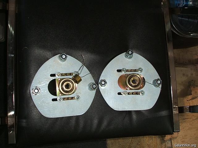

Tein front camber plates
Hot Bits front camber plates
The bushing that's wired tied to these "goes between the top spring seat and the bottom of the bearing so that it will articulate" according to Peter at Hot Bits Canada.
By a sort of happy accident, I have both on the way to me (I hope). I'll sell the set I don't use, but before that I'll take some photos for comparison and adding to the knowledge base here. It may come down to which set works more cleanly with the Ground Control coilover set up I have now.

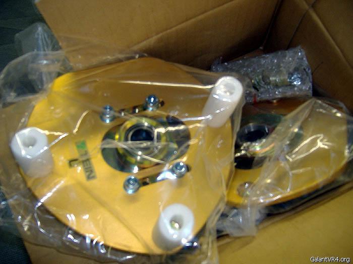

The company called me back. They told me wrong on the phone. They indeed do have the fronts in stock. I have no idea how many. And I didn't believe them. So I ordered a set. They arrived today.
The rears are, as stated, on order from Japan.
I thought everyone would want to know.
