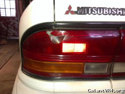

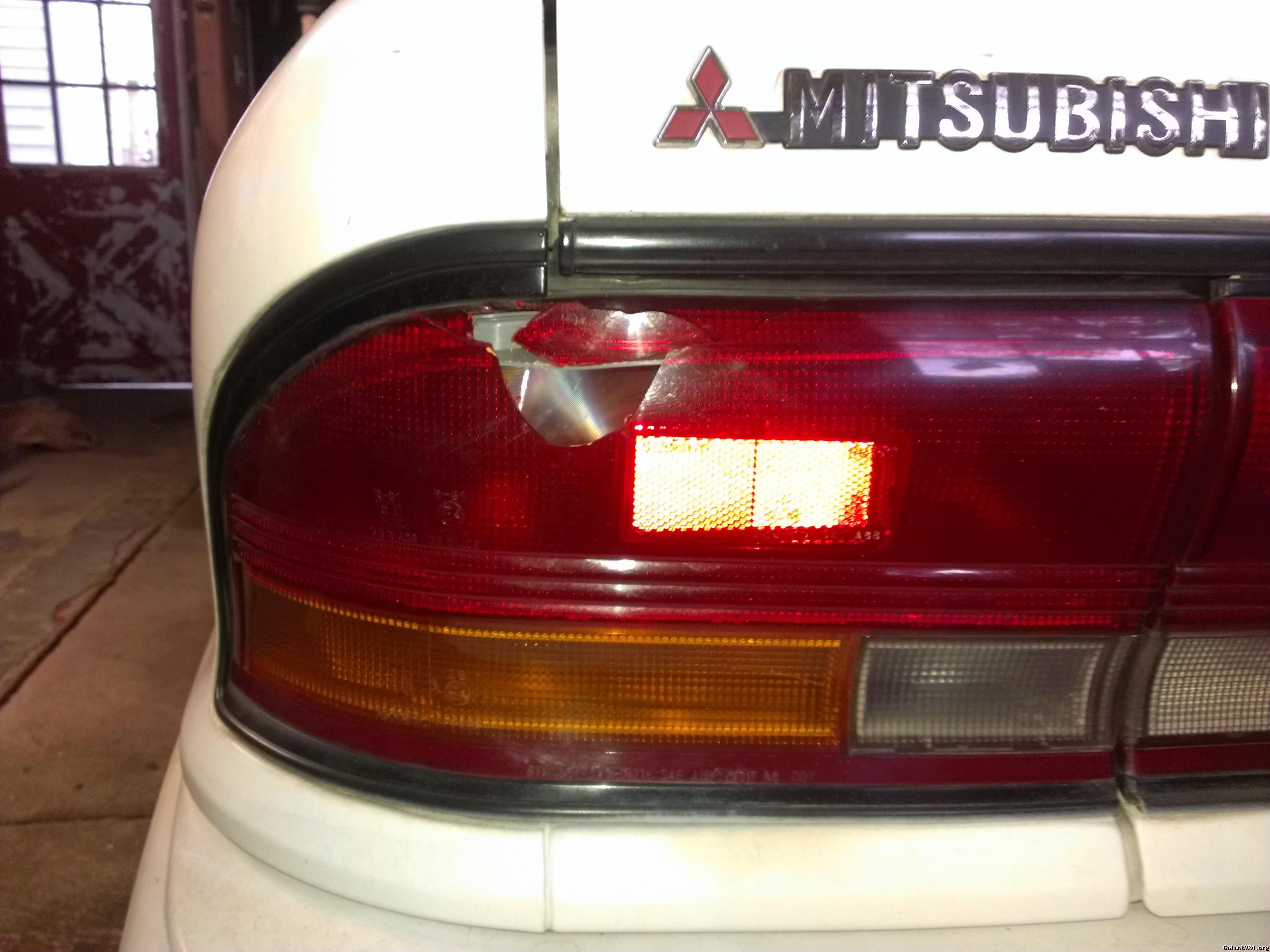

Ok so broke a tail light lense. There are a bunch of gs lights for sale with the chrome trim but mine are gsx with the black trim.
Has anyone tried to remove or swap trim? Does it come off easily?

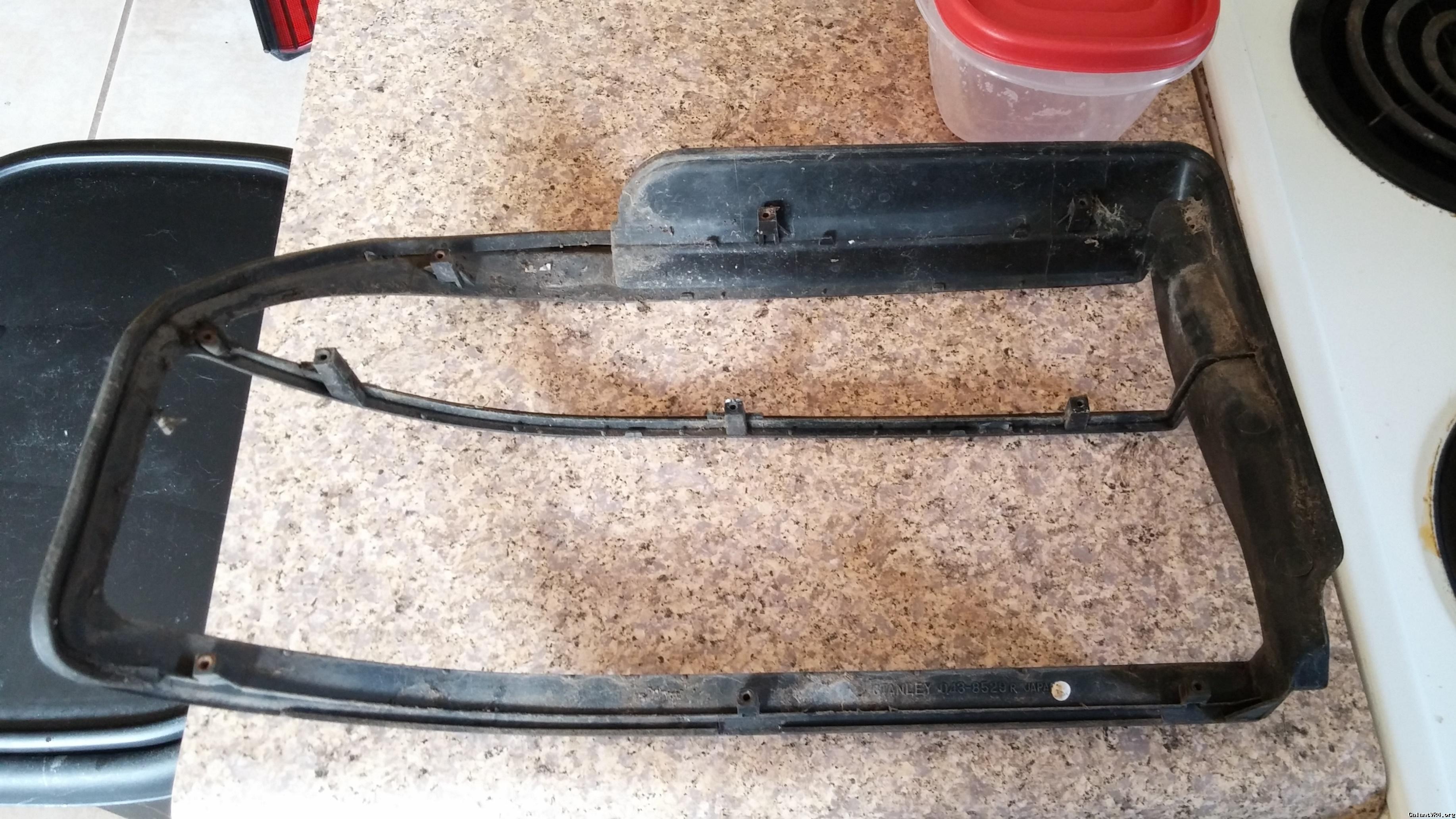

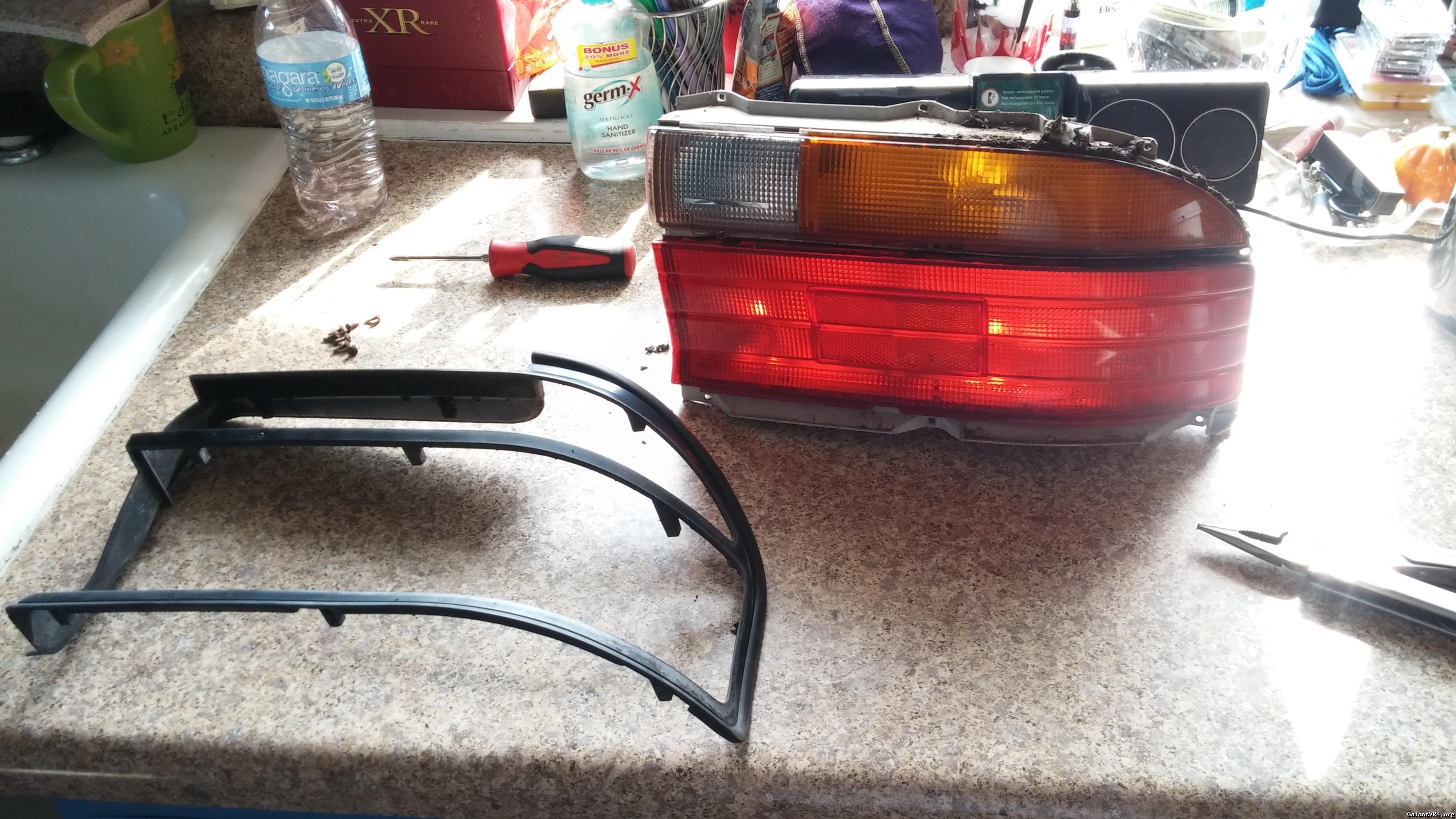

Took one apart this morning, snapped a few pics for ya. Very easy to take the trim off, 10 little phillip head screws. 2 of them are hiding inside the housing.
