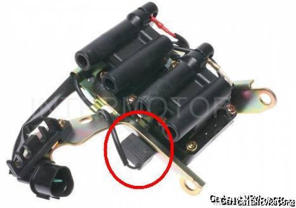

It is my understanding the power transistor works or it doesn't. Same with the CAS. Either the car runs or it doesn't. /ubbthreads/images/graemlins/dunno.gif
Does anyone know this is for? I think it has something to do with the tach. Mine is hanging on by a thread and my tach jumps at 4k while on the highway but my logs are fine, so I have the same issue.
I haven't come across a new coil pack to raid that part from, so I'm just guessing here.

Well, turns out replacing the power transistor has fixed my problem, no more hiccups or tach twitches or anything.
I've found that my valve cover gasket has gone to crap and was leaking a dribble of oil on top of my old power transistor. I dont know if thats the real cause or not, but getting a new one and relocating it in a different area has fixed it for me.
