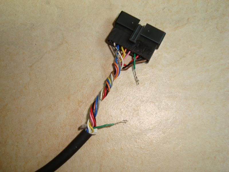

**Update** I tapped the the gauge cluster, and the needle fell back to it's starting position. My only question iws HOW THE F it got stuck at 9K!!!
Anyhow, I traced the S-AFC issue...... YUP!! Broken green wire. :b
GVR4ZUM
Jul 8, 2002
1,455
SoCal, USA
I can't tell, was it soldered or just twisted on. If you have access to soldering iron, solder it and put electrical tape.
