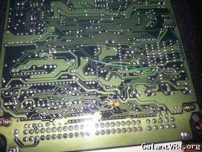

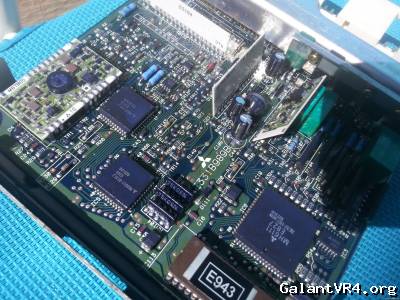

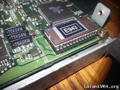

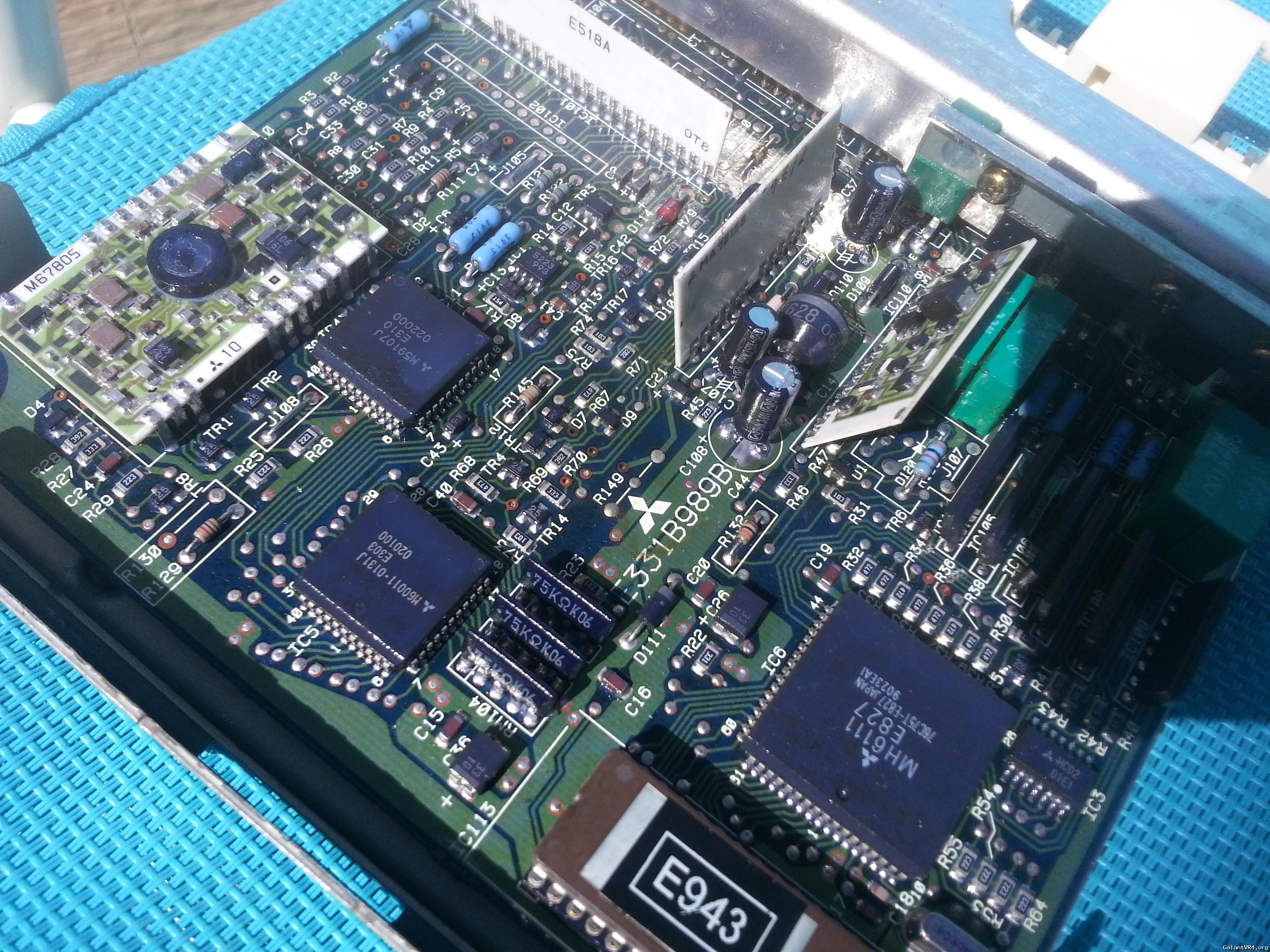

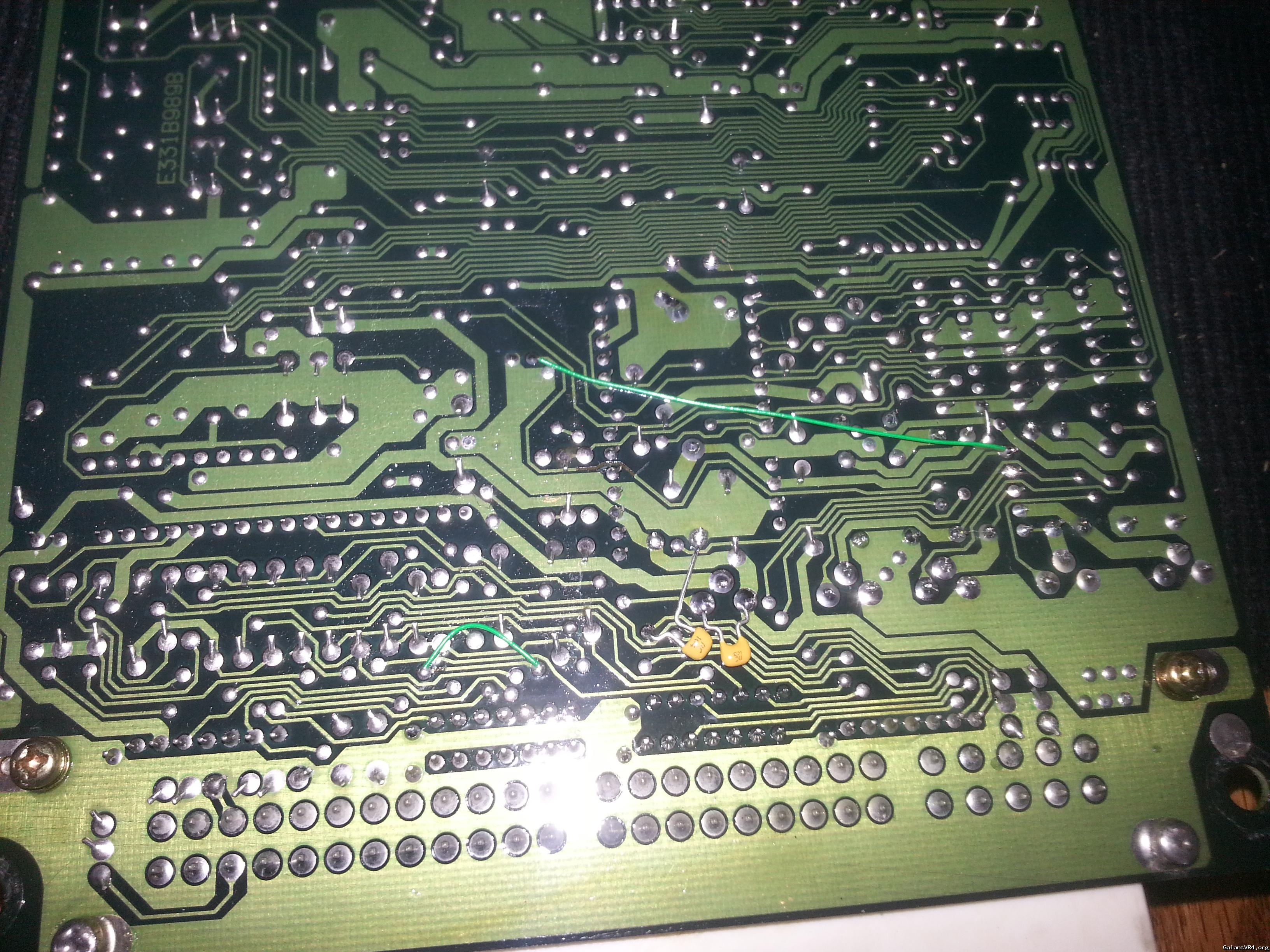

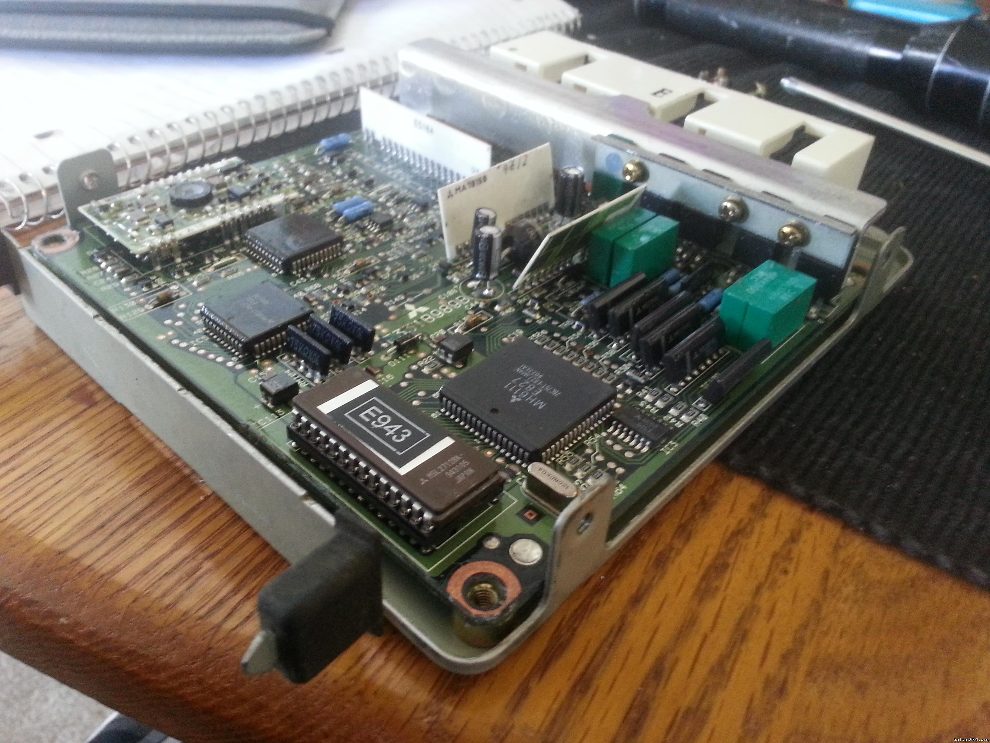

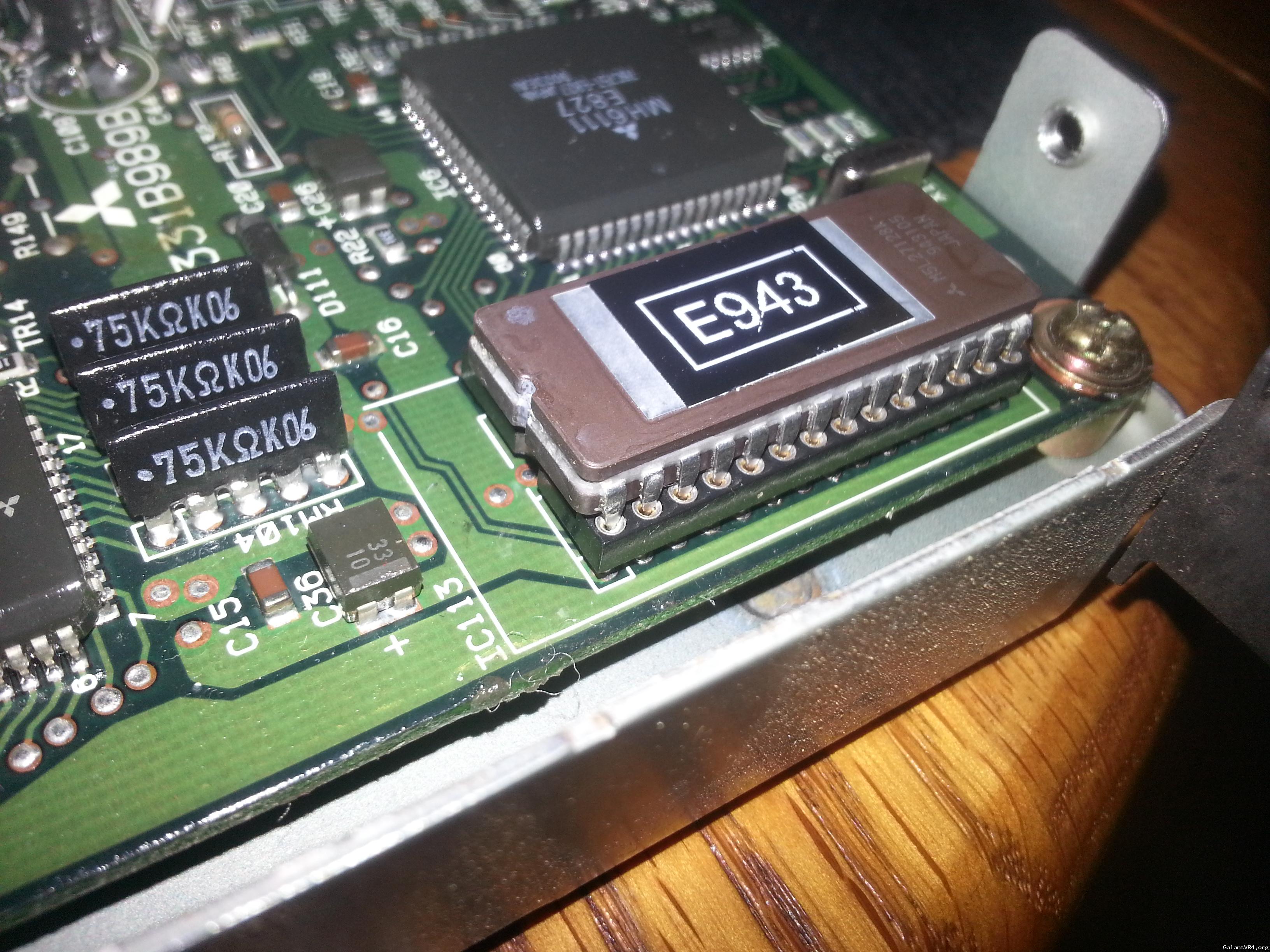

I found quite the surprise when I opened the ecu...
looks like a recap and socket job was done already but, they installed jumper wires etc and they forgot to clean up properly. Solder job looks good but I can see corrosion setting in already in one spot from the old leakage, nothing serious though. And who knows whats jumped across the back of the board but, I can obviously see the broken traces. /ubbthreads/images/graemlins/banghead.gif
Anyone local want to test the ecu in a different car for me to see if it exhibits any issues?
