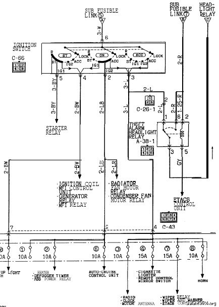

Mike, follow the wire down from the "On" position of the ignition switch. You can see several wires at the fuse block where you can tap your line.

I actually ended up tapping off the hot side of an empty fuse slot in the underdash fusebox.

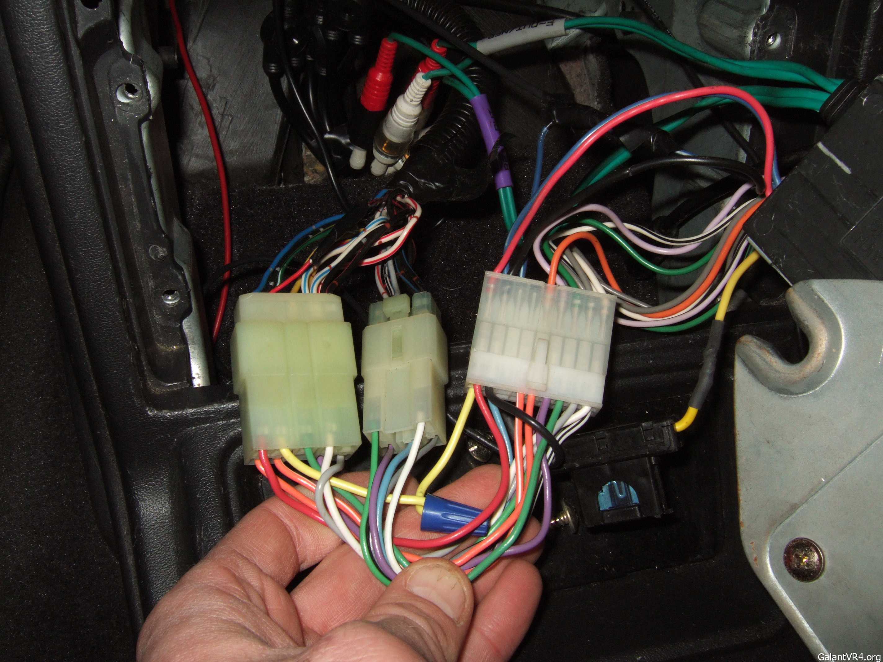

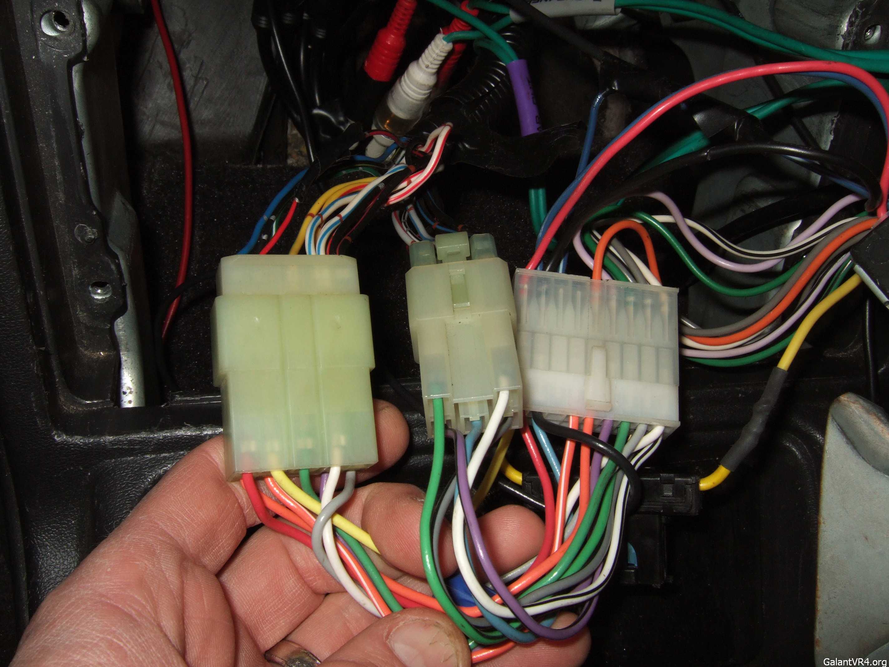

Is it the blue one (from the car) w/ the white dots on it?
I had tapped into the yellow wire in the middle harness (w/ the blue wire nut) and it was constant batt power, so my coolant temp gauge was active when the car was turned off...doh.

You might be able to make a lead off the fuse slot with multiple pigtails that could support several items if they don't draw a lot of current.
