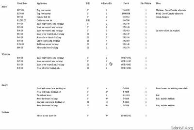

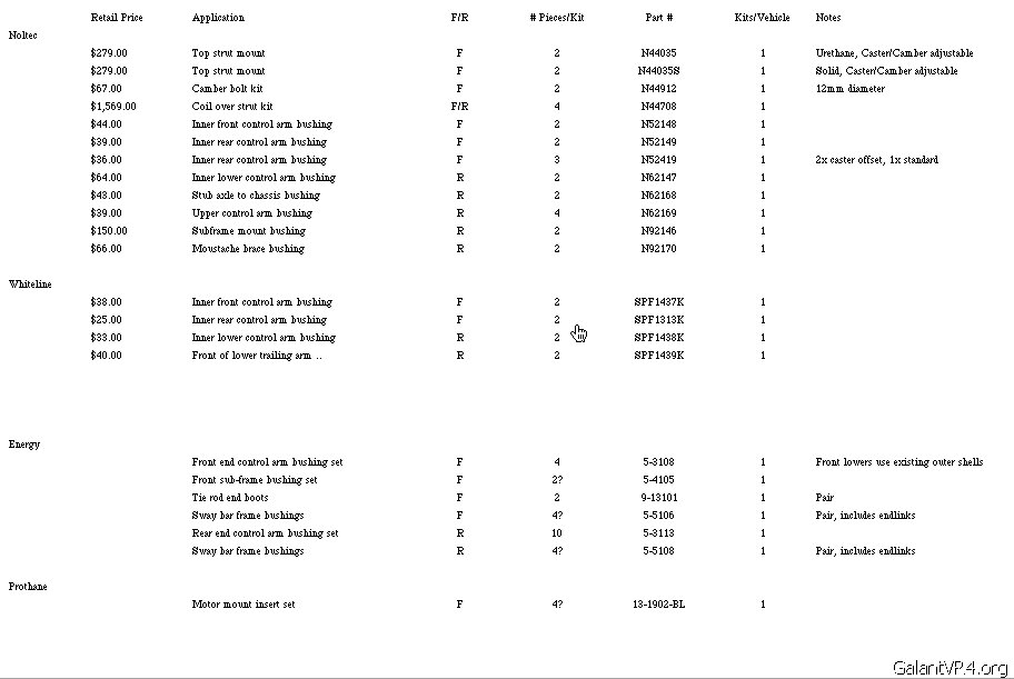

I searched the archives and below is a summary of all info found. Please note the questions following some of the items. Please comment on the preferred set to use at each of the specified locations. It would be great to hear from the experienced members who installed these, and especially those who tried more than one type of aftermarket bushings at any given location and have a strong opinion on which type fits/performs better.
For each set of bushings, please include the part #, price and retailer from whom you purchased them.
As to the format of this thread, I will continue to edit this post as you provide your comments 'til a concensus, or boredom
is reached. TIA!

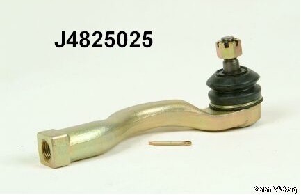

3) Front steering tie rod ends - consider using the beefier but compatible Montero units and the associated spherical and other 4x4 bushings made for Monteros.
