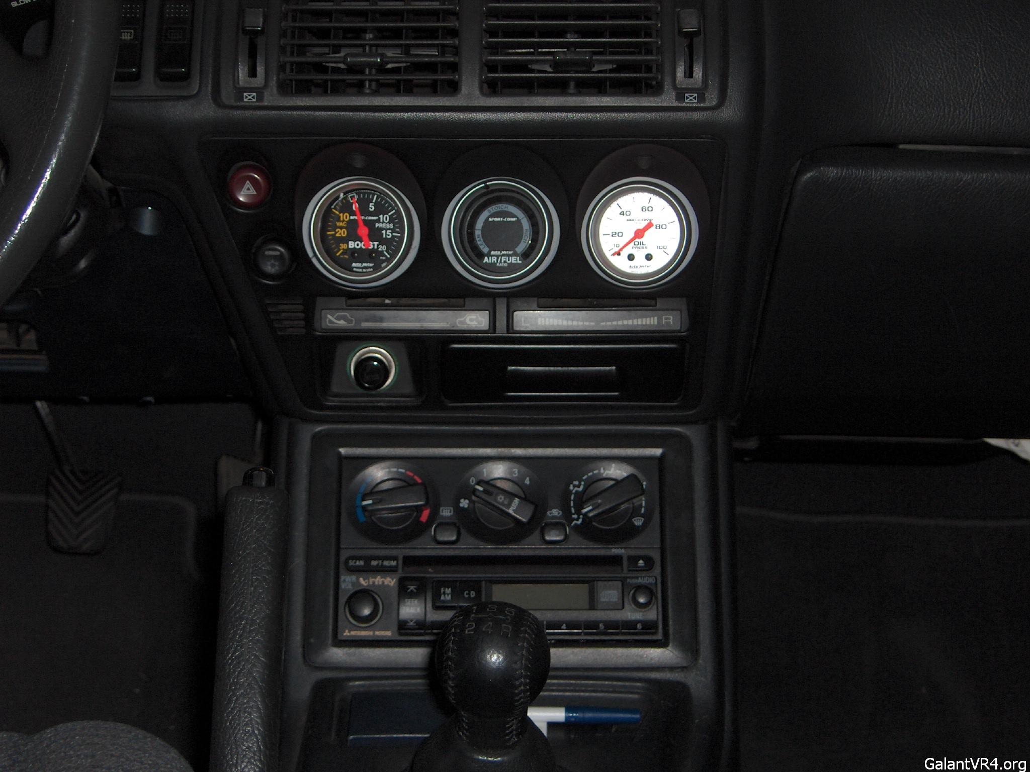

Heckert, I removed the stock hvac controls and kept the blower switch, added like a foot of wires to it, and adapted (jb welded)it into the lower hvac controls. The gauges are installed in a flat piece of sheetmetal and angled toward the drivers side.
AlphaMale, the hvac control im using is from a 99-03 Galant, which is the same as 00-05 eclipses and some 02-05 monteros.
Guys if you want more details I can dissassemble the whole thing and take pictures so you can have an "insider" view of it. thanks!!

This is what I did to my GGS

I've got my wideband unit in the flip pocket /ubbthreads/images/graemlins/grin.gif
Powerplay has 2 gauges mounted under the tray with all the coins in it (above).

Here's what I've done...
This houses my EGT and Wideband /ubbthreads/images/graemlins/smile.gif
2g deck???
The deck is actually mounted from the side with only 2 screws...and yes, I know it's an old ass deck /ubbthreads/images/graemlins/dunno.gif And the S-AFC is just mounted with magnet tape /ubbthreads/images/graemlins/cool.gif
I just have to say that I am impressed with the solution gtluke and mrmitsu have of hiding the "good" stereo and gages behind the oem stereo. Nice idea.

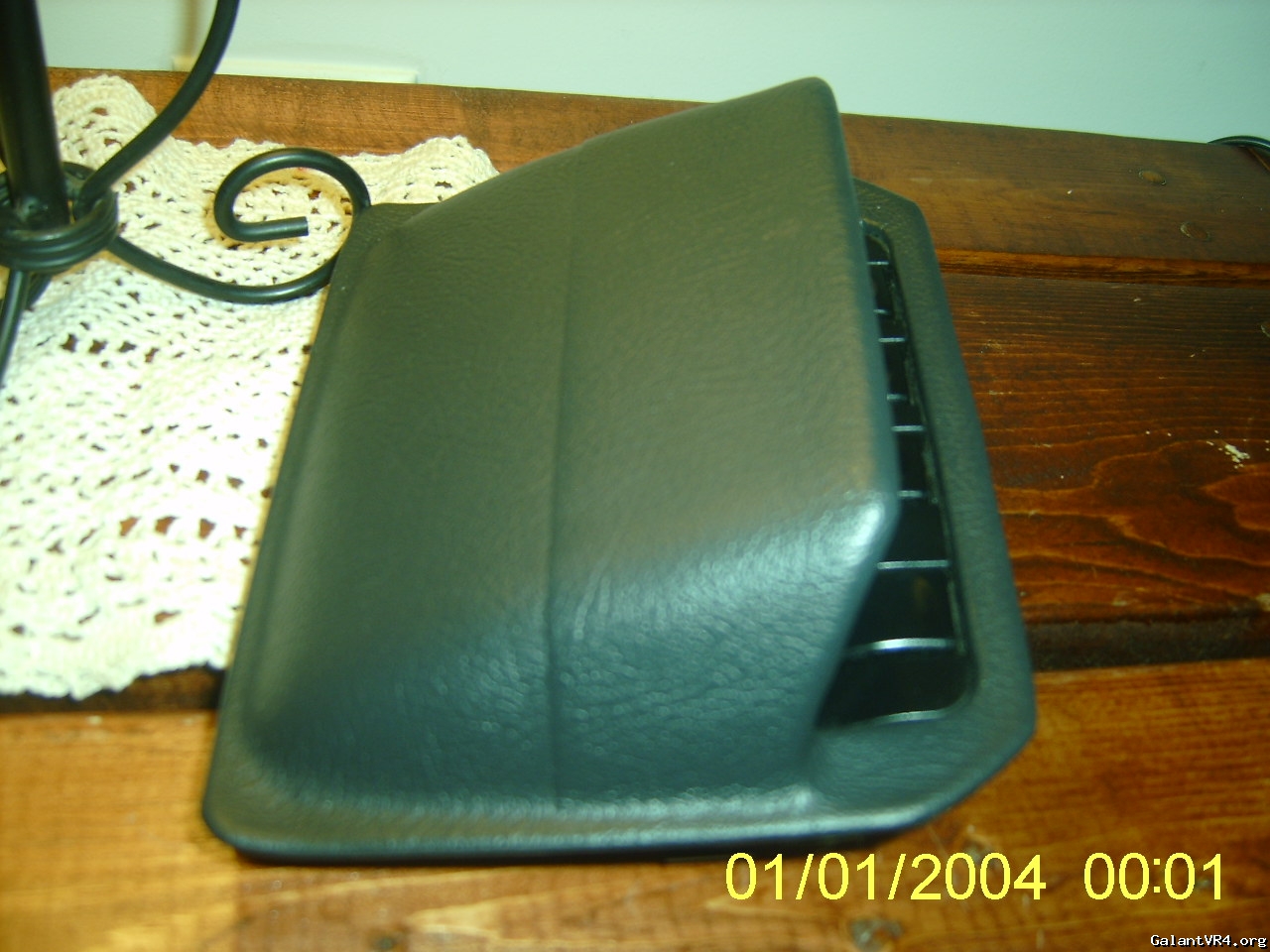

I think if you get the adjustable suspension gauge pod as seen here click gutted out and had the digital gauges made buy click you could get at least 3 of them in there Gauge dimensions: L=2.12" D=.6" H=1.37" I know where one is /ubbthreads/images/graemlins/wink.gif
