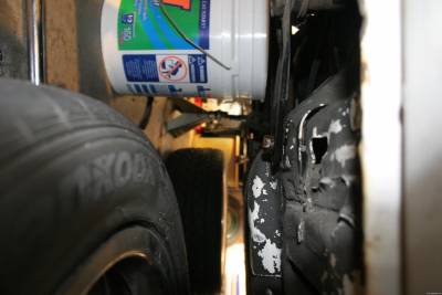

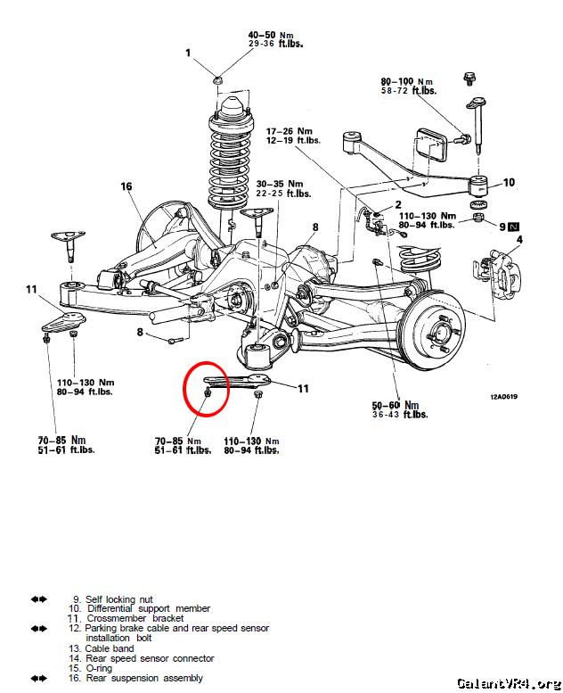

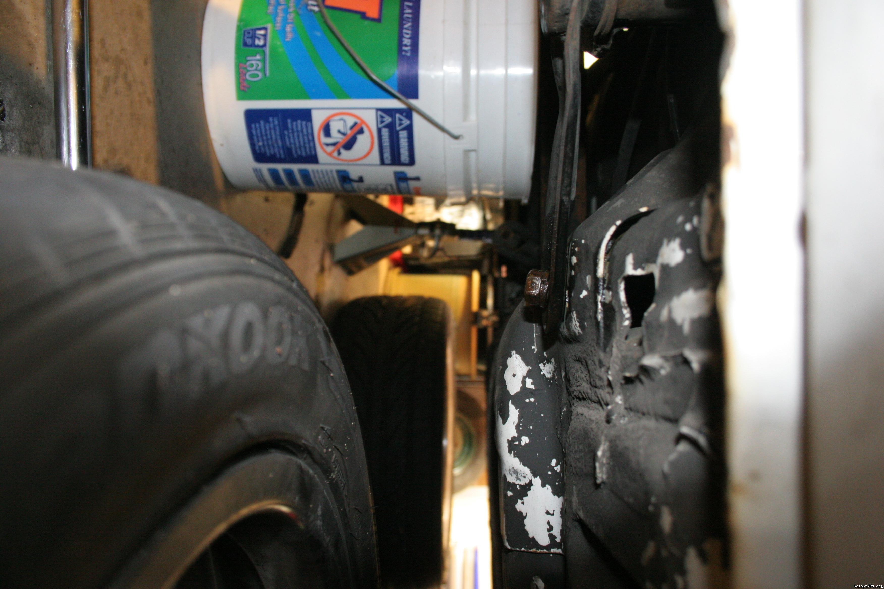

So I am removing my subframe to replace my rear diff. Basically I started loosening the bolt and it was very difficult (using a very long bar), but never stopped being difficult. I don't want to keep forcing it, and after looking a little closer it almost looks like it is cocked a little. Am I totally f*d here? The other side is the same way, really difficult, and switching from c/clockwise to clockwise doesn't seem to loosen it at all. Weird thing is I could swear I have taken these off before... Thanks for any suggestions guys.

You can try a little propane torch and heat it up a little. If you break the bolt, you will just have to drill it out and re-tap to the next size bigger.

Okay, just wanted to check, I thought maybe it was coming out sideways. I already have to drill out 4 of the exhaust hanger bolts (hence my hesitation and frustration today...) so if I break it I guess thats just a lil more work haha. Thanks, I'll try the torch.
-shamus
Never never use a long bar you will snap it. Take a punch put on the end and give a short but stout tap with a hammer. Cheater bars are to much torque ive seen guys at school use them and the teacher comes running. We do the punch trick and walah. It frees up some corosion inside.

Alright, I'll try punching it to get some of it broken up, then hit it with an impact. I still cant help but feel like it is coming out at an angle, but I also dont see how thats possible considering it threads in the frame.

If you've still got the stock squidgy rubber subframe bushes you don't need to remove the subframe to replace the diff...
Unbolt the drivesahft, the rear axle flanges and the bolt on either side of the diff, then
support the diff from underneath with a jack then un-bolt the mustache bar, lower the jack and there's enough 'give' in the front subframe bushes to allow the subframe to droop enough to get a socket onto the top 2 bolts, undo these and the diff is free, lift the subframe back upto the angle it should be at and place a block of wood/etc under it to hold it in place until you are ready to install the new diff.
Installation is the reverse of above.
