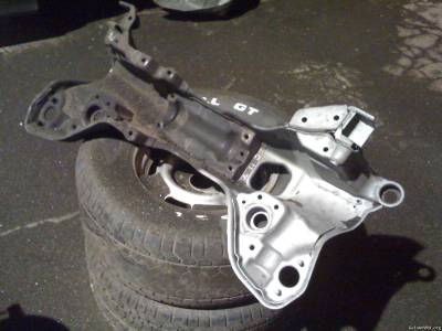

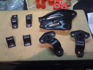

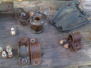

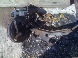

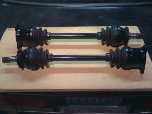

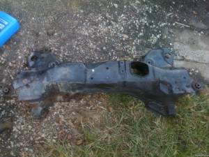

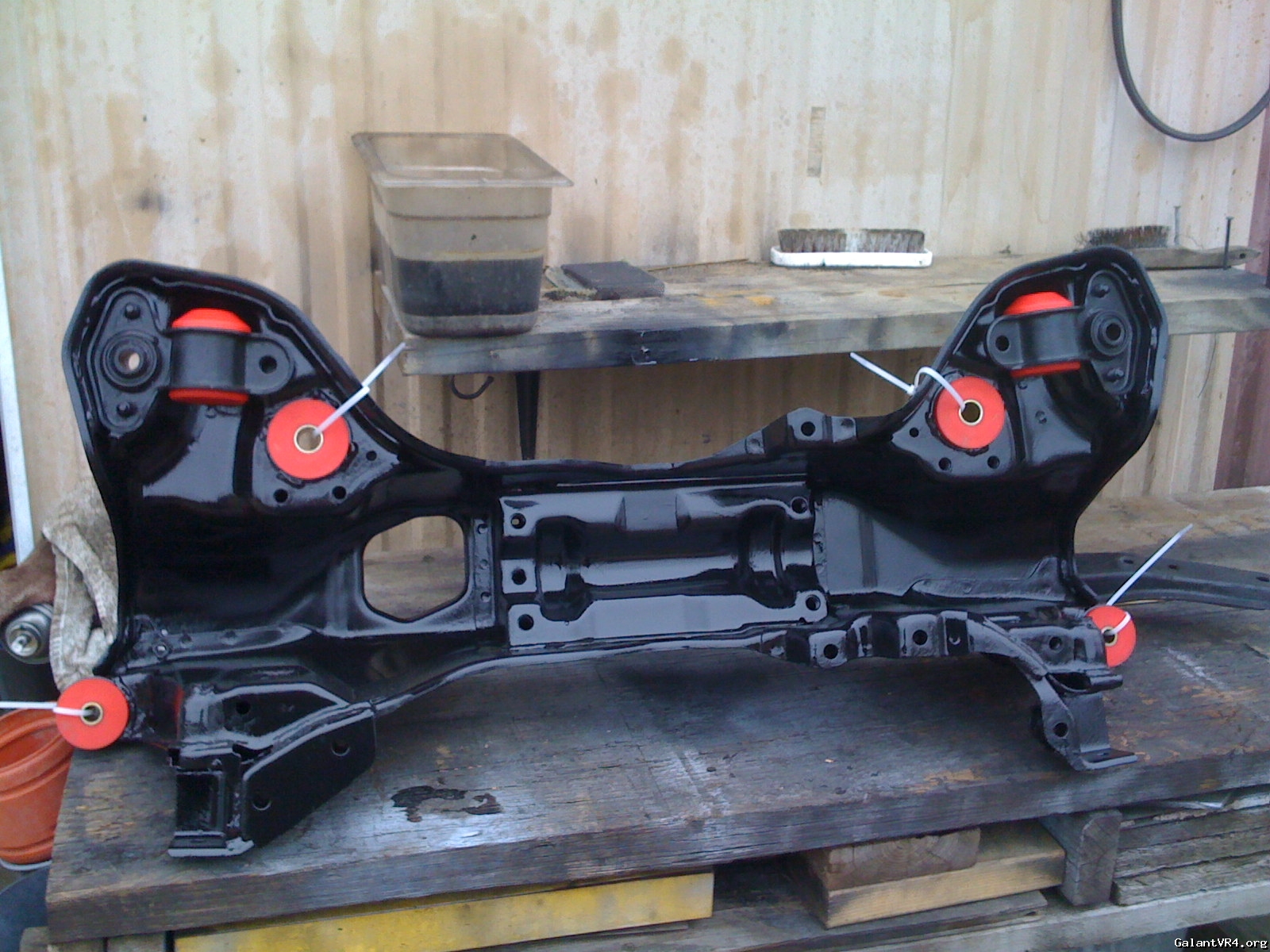

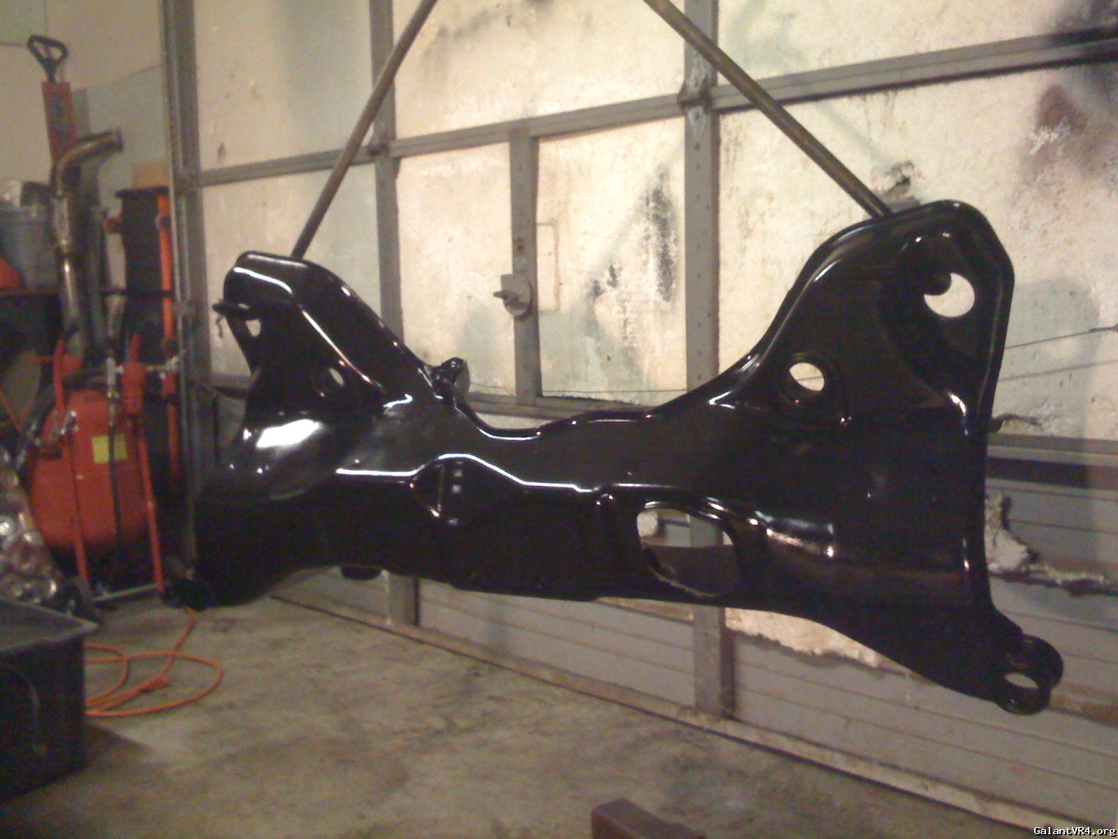

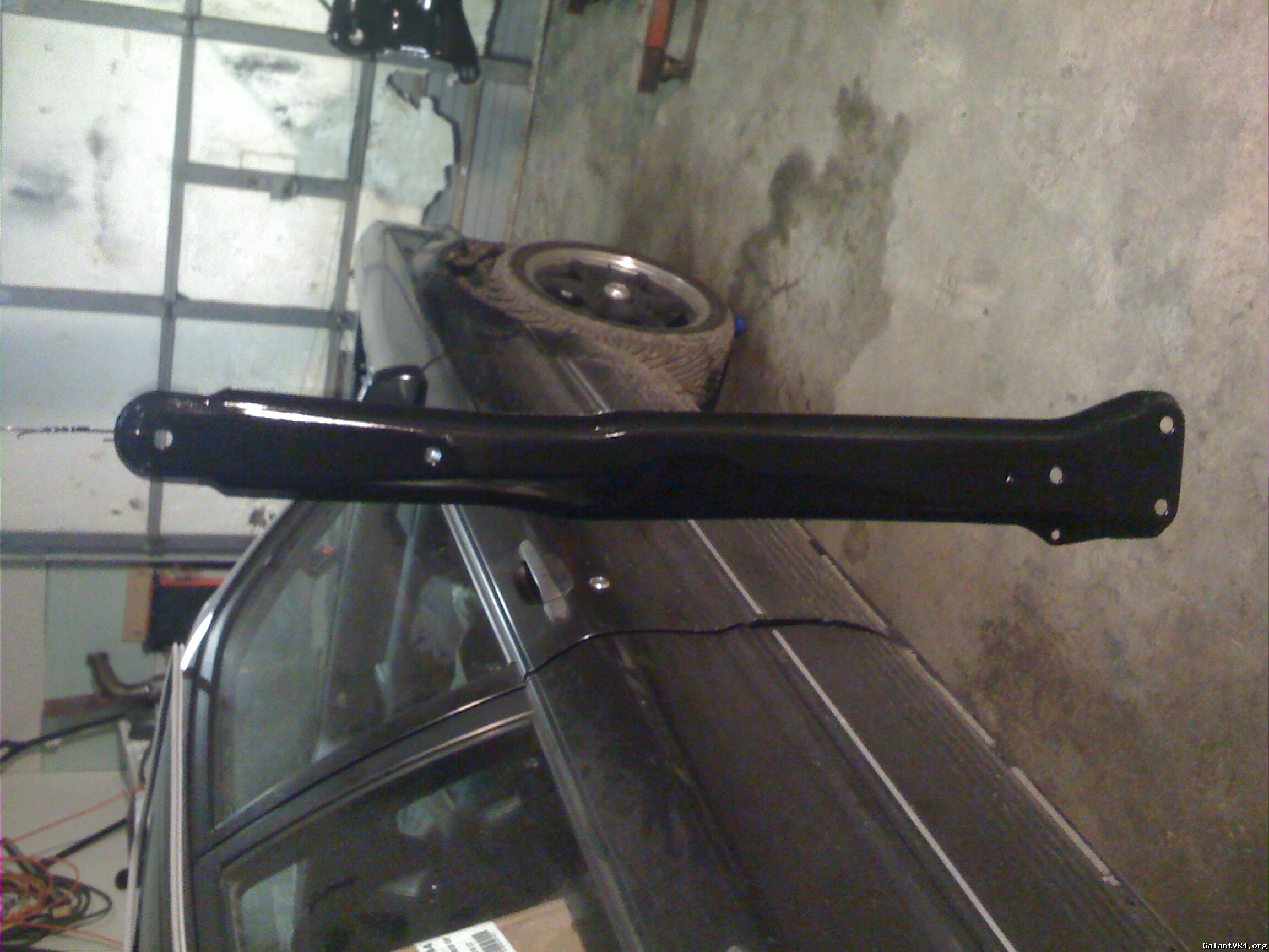

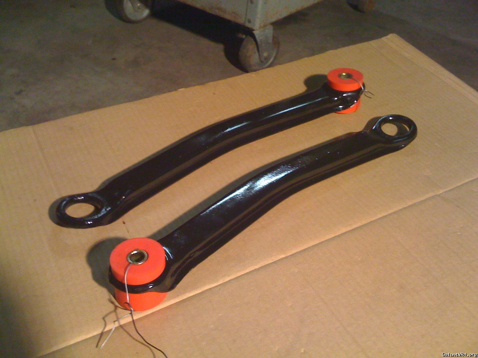

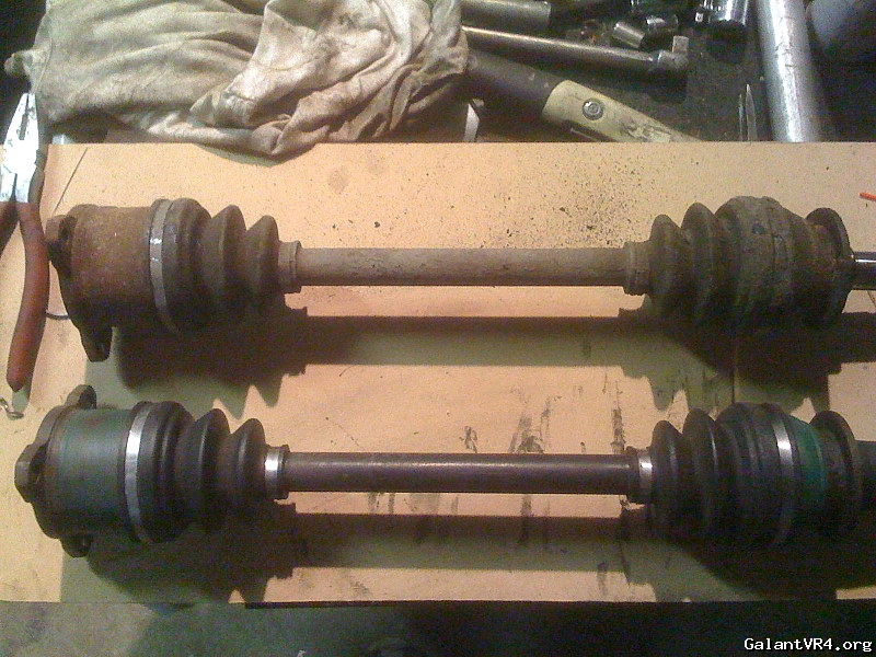

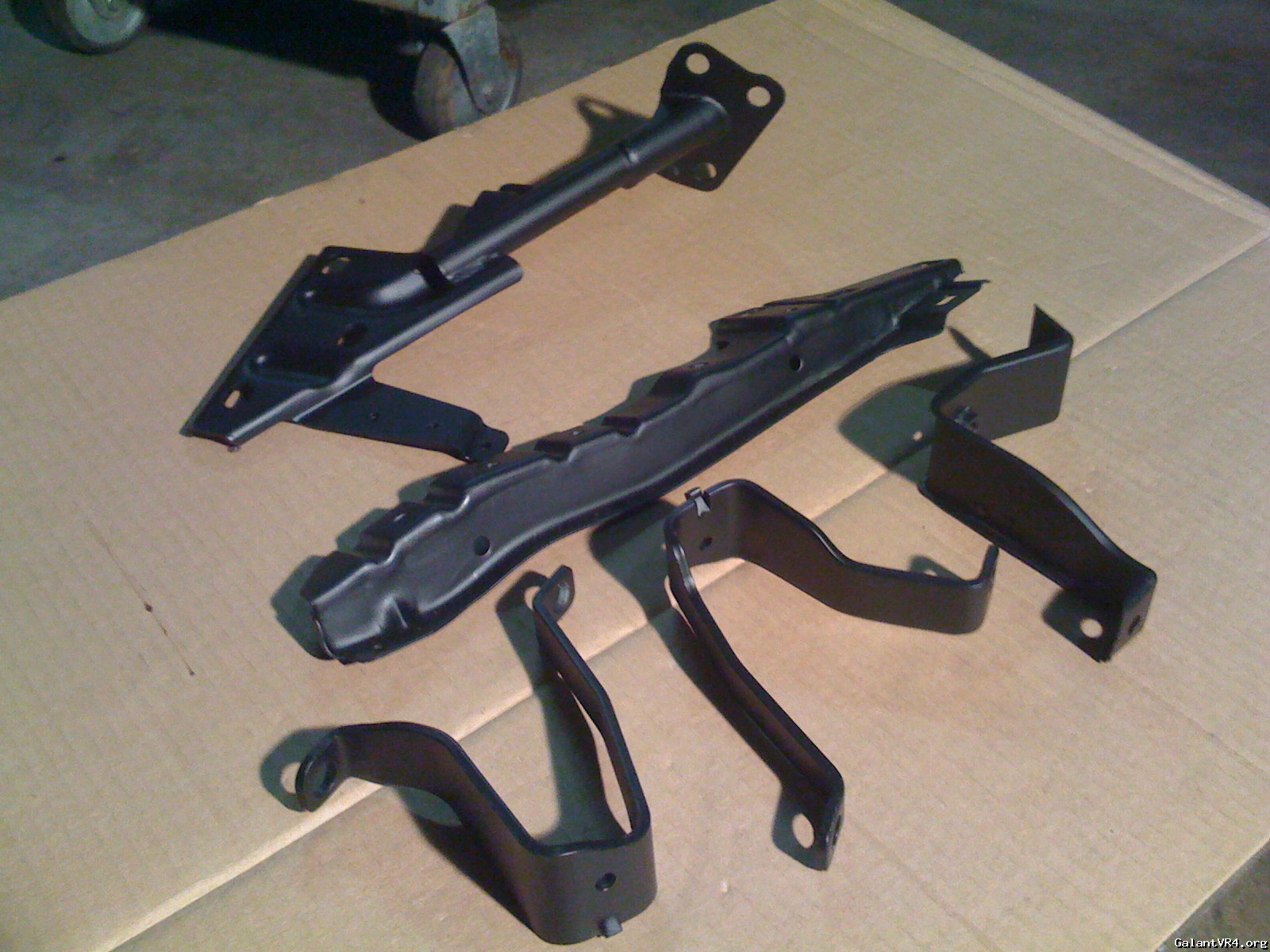

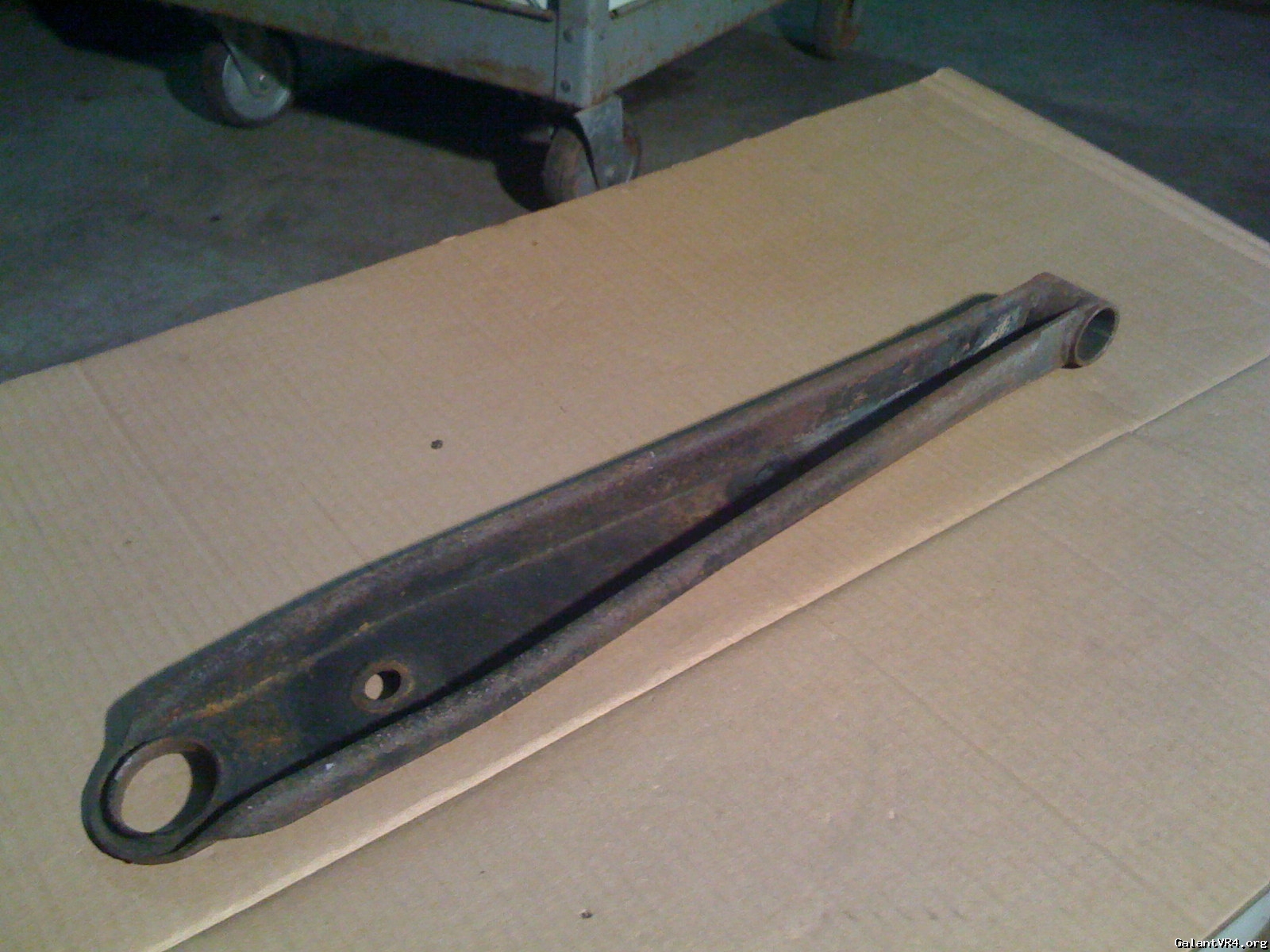

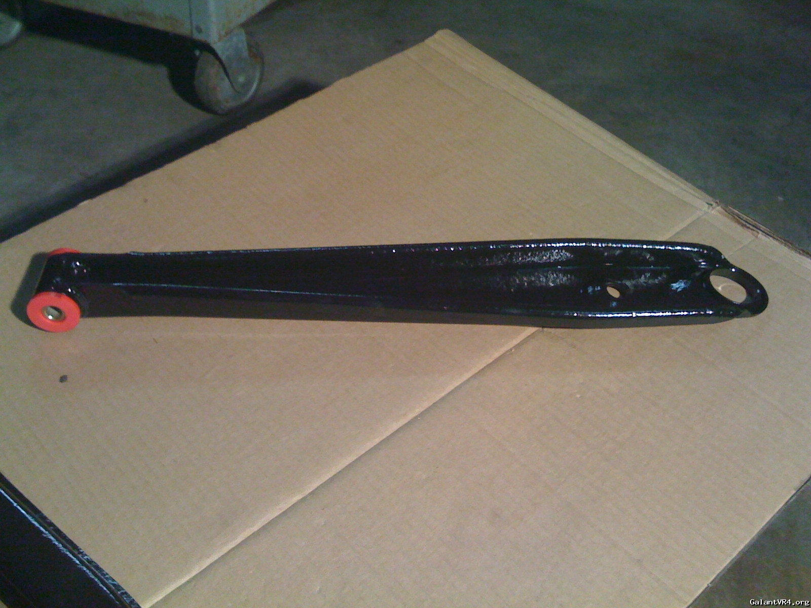

I have some of these pix in another post, but I'm gonna make a dedicated post to my work.

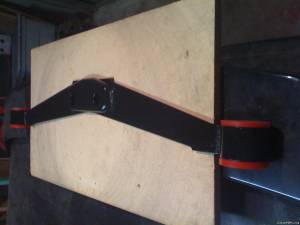

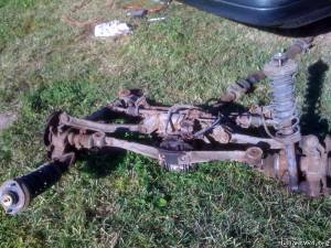

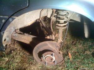

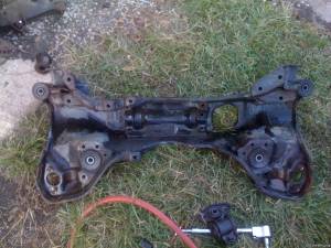

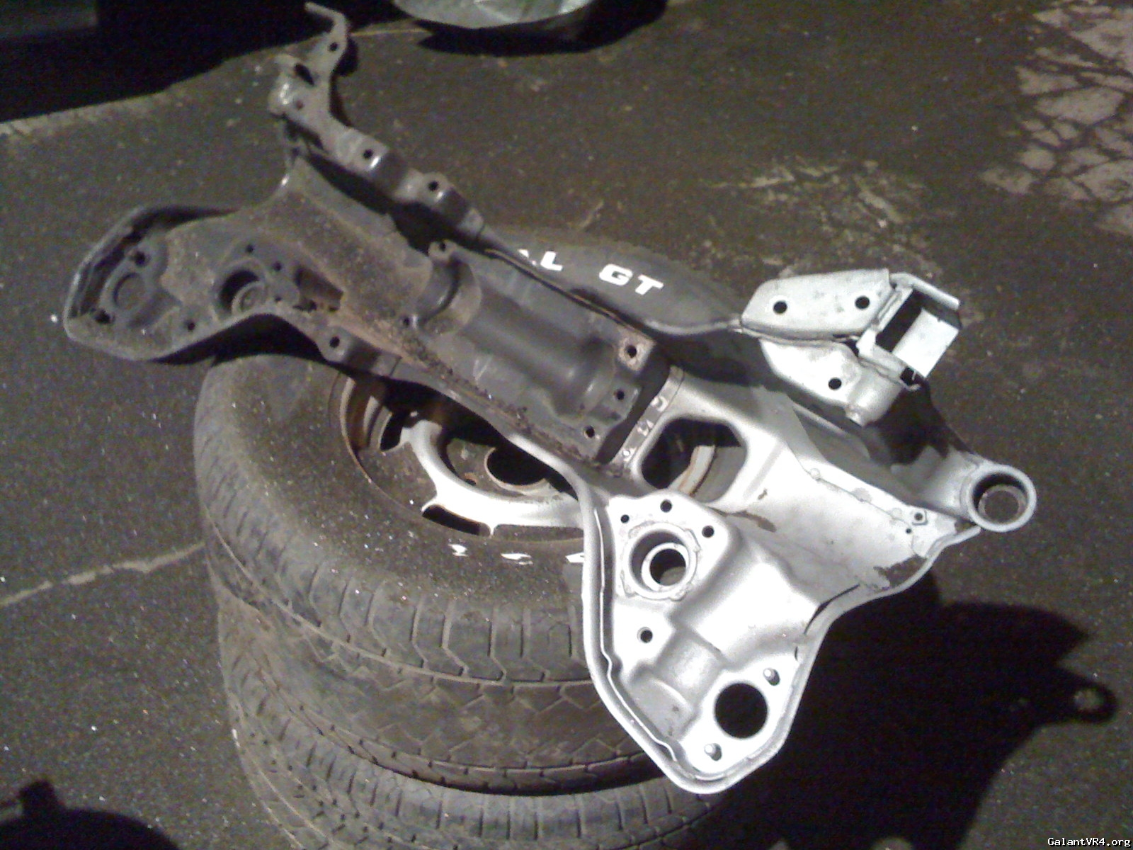

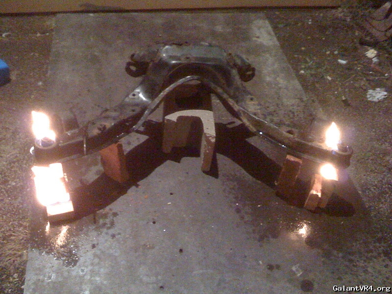

Everything is blasted, coated with Rust converter/Rust encapsulator/Chassis Black. Every bushing and ball joint will be replaced. New bolts where possible.
Before/After
Some During pix:
Misc:
random parts I decided to paint

I'm redoing all of 420's suspension/drivetrain, so that this summer I can buy a running car, swap it all along with a paintjob and have me an awesome galant. I'm just gonna restore and put together all the pieces on the floor till I get it. Already have all new brakes, have the 17's I like, and all the bushings. Just need to get balljoints and a suspension setup. /ubbthreads/images/graemlins/grin.gif
