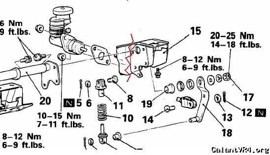

i am getting this popping noise everytime i push my clutch pedal in. i tried to look exactly what was causing it but its kinda hard to lay under the dash and push the pedal in at the same time. Any ideas what this would be and any fixes?

I had the same issue in my car. In my case, the bracket that bolts to the clutch master cylinder sheared off. The symptoms began as a popping sound everytime I pushed the clutch in and eventually worsened to a creaking sound. I attached a picture of the bracket and drew some red lines to show where it sheared off.
