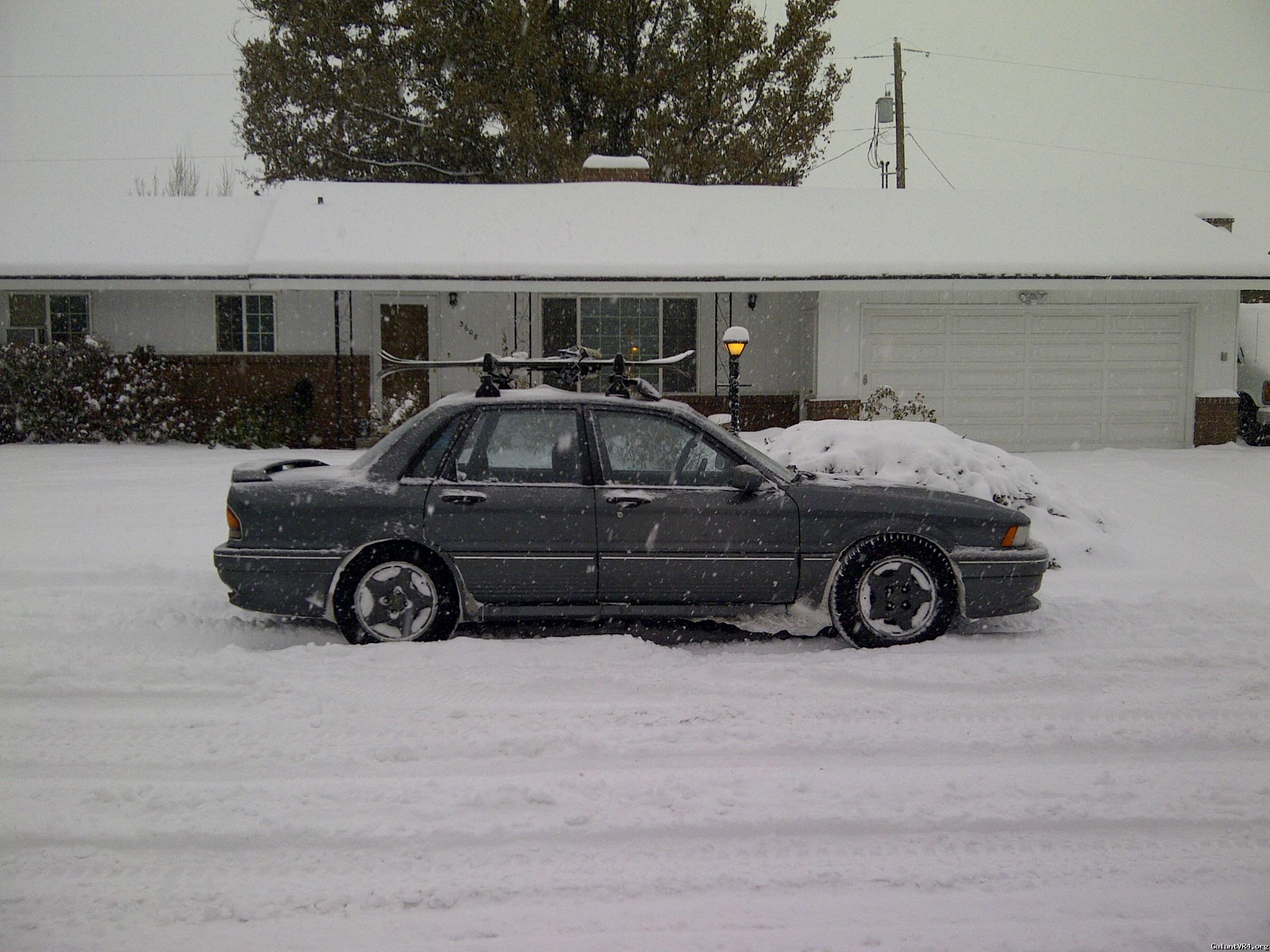

The Nokians and Blizzaks are awesome. I've had Blizzaks and Toyo Observes on 503 in the past, and put Blizzaks on my girlfriend's Audi. All are great. This year I had a set of General Altimax Arctics put on and they are the best bang for the buck studless snow tire I've run yet. I don't think you can go wrong with any of them.
Obligatory snow shot:
