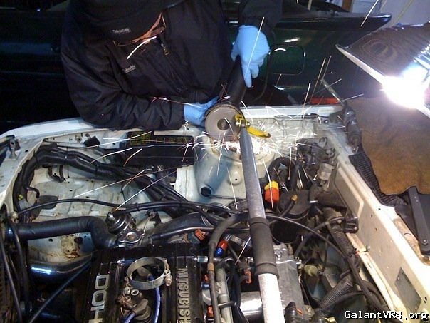

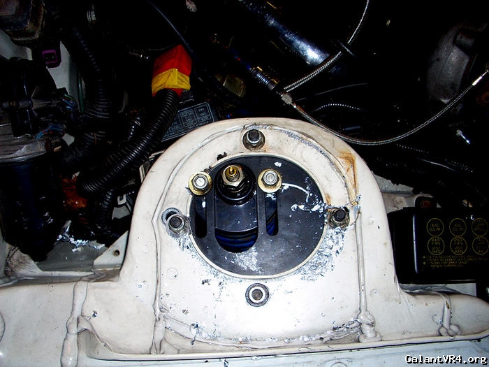

The biggest job the strut tower has is to keep the strut from going through the hood. Beyond that the side to side forces are there but they are not big enough to overcome a nut and bolt. Early on with my Eclipse I sloted the strut top mounting holes to gain negative camber. I autocrossed and road raced with them like that and they never moved. I also have cut the top of the strut tower to fit RRE's castor/camber plates and never had them move and that's autocrossing and road racing on r-comps. Here is what I did to our One Lap of America car. We're going to take that car down to Florida and back so just replacing a strut mount stud with a nut and bolt isn't going to be an issue for you. I don't event think you need to tack weld it in place.

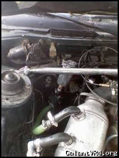

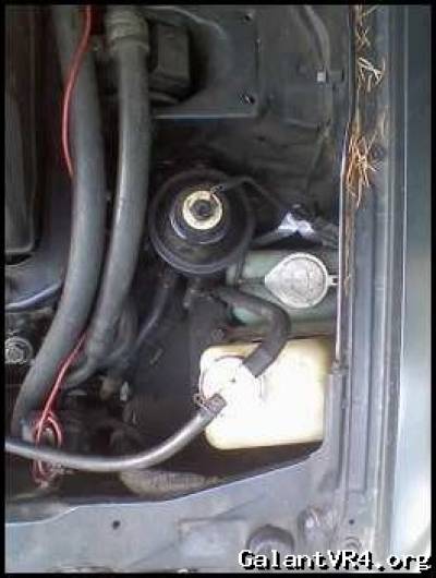

Well I think I'm decided that this is a totally viable procedure if it comes to it. For now I'm trying to relocate the Washer Fluid Reservoir as that seems like a less invasive fix and would allow me to turn the bar around. If that doesn't work then I'll get serious with the strut top.
11,983
Couldn't you have just moved the bar to the front half of the strut towers to clear everything?
belize1334
Nov 18, 2003
3,317
Bozeman, MT
It was on the front half. That caused issues with the Buscher AFPR. Moving the Washer Reservoir allowed me to move the bar to the back to fix the issue.
