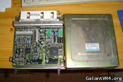

also funny enough this ECU has already been discussed on the .org before and I even replied to this topic click about three years ago showing what happened to the MD166267 in my very own E35A Eterna Sava a few years back. It appears this ECU is NOT EEPROM (which means electrically erasable programmable read only memory) - if it were EEPROM it would have an additional chip on the board like below:

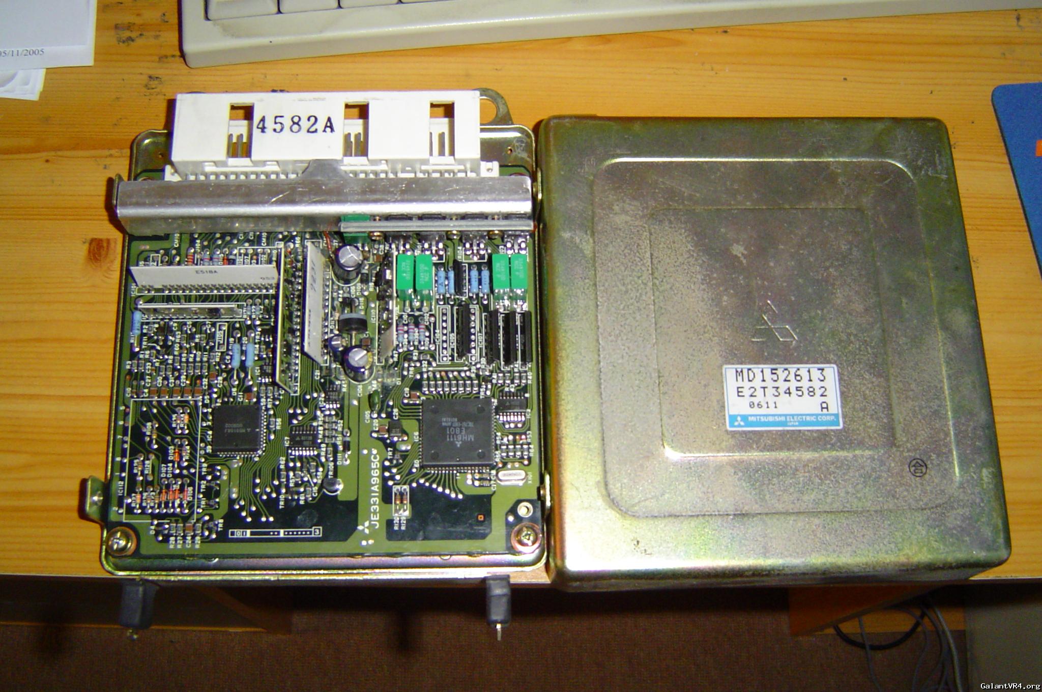

Here's the ECU I was referring to that I repaired. If you look in the centre just above the cap you can see the brown wire heading up under the heat sink.
I did the repair the simple way. I had a spare good ecu of the same part number, a meter and a pack of hobnobs and a cuppa or three and checked out all the traces one by one. If it was good on both then I moved to the next. Did take a while, and I got the car running ok and logging with it at the end, I think it's still in there now.
This one was a real mess. to start with. I did end up using an any old Mitsubishi ecu as a component donor for the surface mount stuff and the other parts that were nailed. Apologies as This was the only picture I took after it all went back together, but I remember there were about four jumper wires I put on to reconstitute the damaged traces.

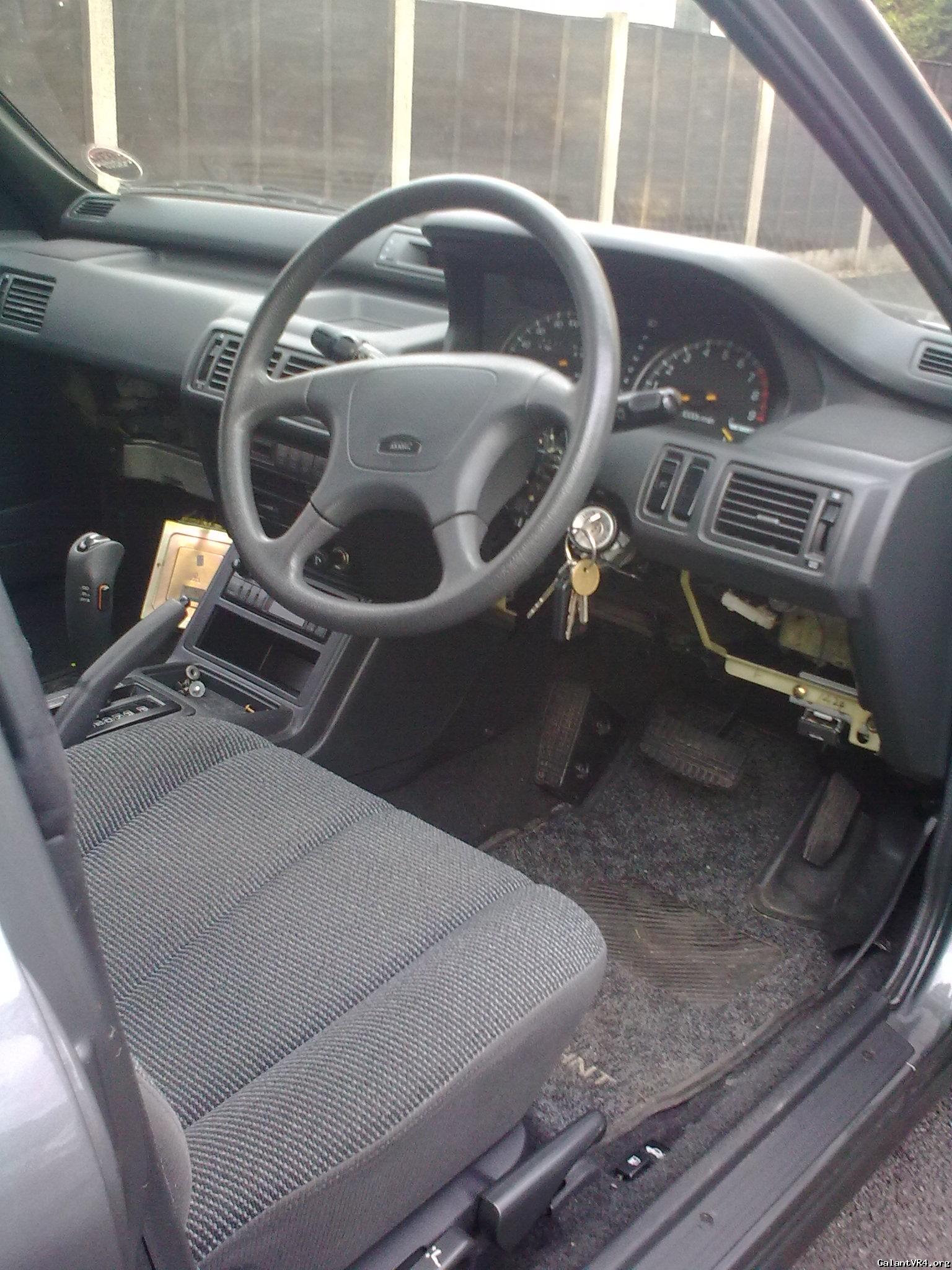

Some pics of the rascal. My brother lives and works in Tokyo, some 20 years ago my parents went to visit him there, he took them all around in this Mitsi. It is very comfortable, with aircon, climate control, folding mirrors etc and my mother raved about it so much that when he moved to a place without parking, rather than sell it for peanuts, he sent it to UK. It was registered here and lovingly cared for by my mother. It is exactly as imported apart from the broken glass on the front nearside foglight ( I looked on ebay but its not a type on UK cars), its done 98Km and drives like a dream
On the last pic you can see the ECU dangling in the passenger footwell, and the plastic taken off the steering column when I checked there was 12V leaving the ignition switch. Note also the original Galant floor mats.
