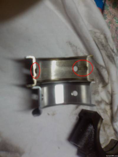

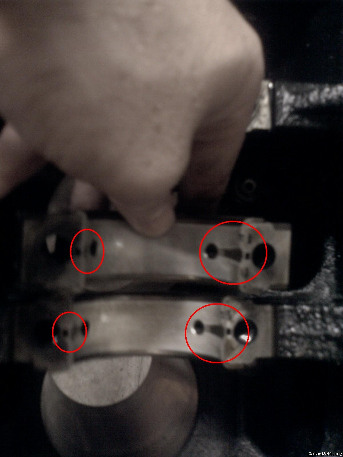

I've just taken the crank out.. and looking at the stock thrust bearings, I've noticed they have notches machined on the inner surface, where the two meet, while the Clevites do not. It seems i have heard that some Clevite resellers 'mod' the bearings (FFWDConnection). Is this what they are talking about?
Should I be concerned that the Clevites do not have these notches?
here's a few pics,
pulled from another post, notches clearly visible..
https://www.galantvr4.org/img.php?id=46775

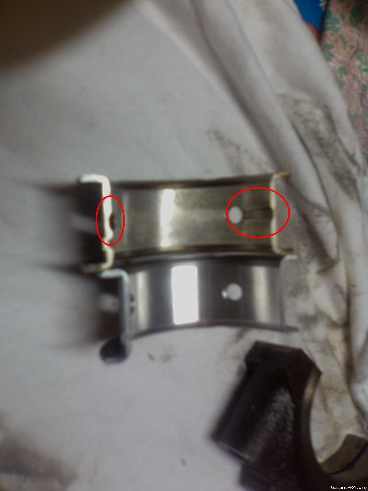

and here's pics of mine..
any ideas?

Both the bottom and top half-(circle) of the bearings have the two notches on the inner surface, right where they meet eachother. The bottom and top halves are both notched the same, as can be seen in my first picture in the post (not the link), where i am holding the top half of the thrust bearing next to the bottom half. . Neither half of the thrust bearing has 'a groove on the entire face of the bearing', as you suggested..
does that mean they are not stock?
is the purpose just for better oiling in this case as well?
Thanks for the info!

I'm not sure if it is stock or not,
I have an old motor @ home that I could check out.
Does the bearing have any markings on the back of it?
and brand name?
The main thrust bearing has the oil running via the back of the bearing. Where the other main bearings have the oil running via the front/groove of the bearing.
I'm assuming the groove is the manufacturers design to provide better oil flow??
