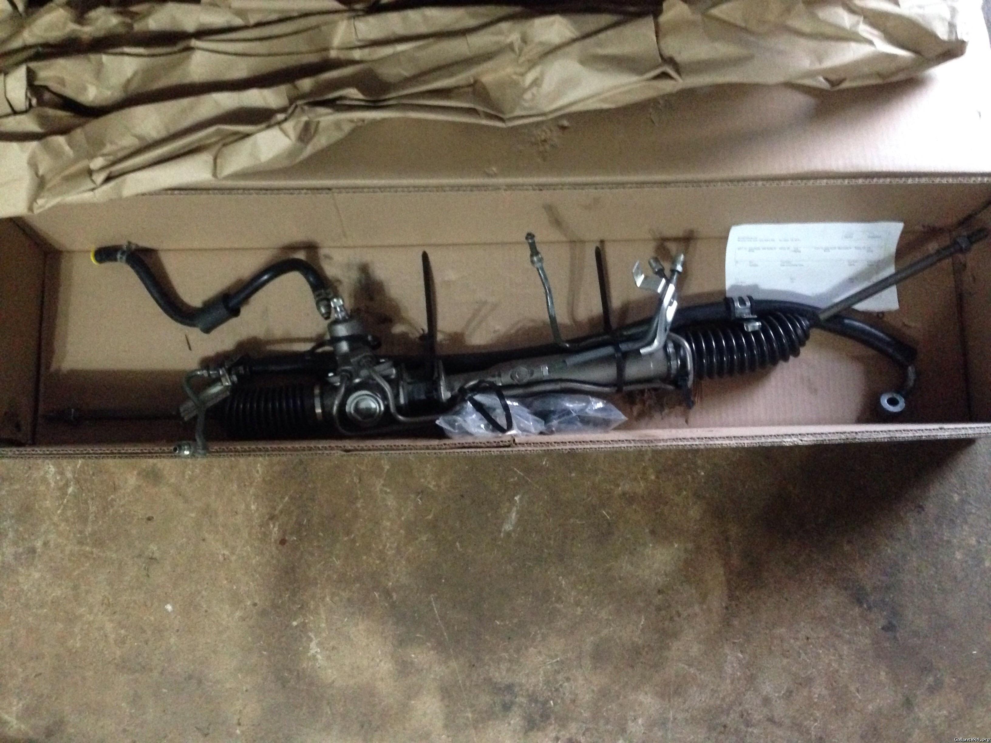

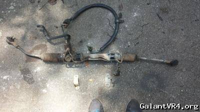

The problem is finding the correct parts for the rebuild. I thought I found a kit and everything looked good, but my rack leaks worse now lol. I'm pretty sure the kit was for a 2ws rack not 4ws and pretty sure there's a diff. Anyway I just sent a rack I bought on here over to buyautoparts.com. And they are having it rebuilt for me. They were the only place I found online that said they had them in stock and for sale. When I bought it I later found out they ran out of cores. But Matt worked with me and said I could send mine in or another and they would hook it up. I'll post the rebuild cost and pics when I get it /ubbthreads/images/graemlins/smile.gif Brian Terhune of Terhune racing can also rebuild them for about $300-350, just have to send yours to him.

Hey guys buyautoparts.com has a rack in stock if anyone is in need. I just got mine rebuilt by them and was told they had found a core. click
91GVR4BG
Apr 10, 2015
20
Kapahi, hi
Just got my rack today and all I can say is wow. They did a fantastic job in the r&r rack looks brand new. And they even gave me a 12 month warranty /ubbthreads/images/graemlins/wink.gif
After, , before,
