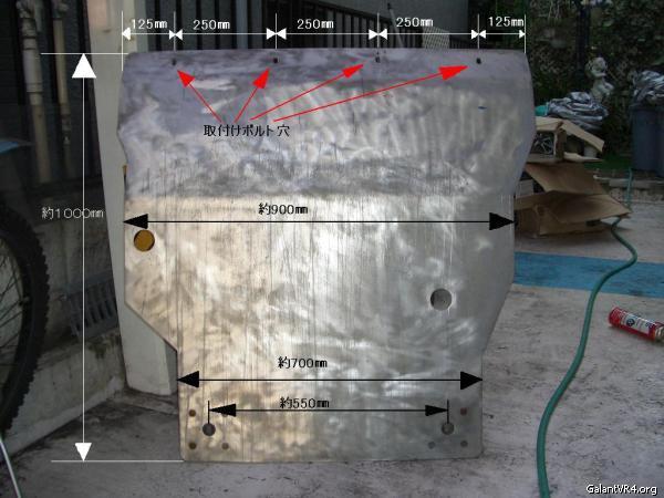

I want to know about those plates that are under the engines on some cars, i don't know if these are available from mitsubishi or if they are a ralliart edition but where can i get that thing? Does anyone have some pics of this installd on a VR-4?

Yes thats the one!! /ubbthreads/images//graemlins/smile.gif Also called skid plate!! /ubbthreads/images//graemlins/smile.gif
Was there something like this available for the VR-4?? I think that i was something like this for some time ago on the www but i can't remember if it was on a VR-4 and if it was a OEM think or ralliart thing...
Someone that knows something about this?? Can this still be ordered from somewhere?
aah those specs is what i need to make one on my own for my VR-4!! /ubbthreads/images//graemlins/smile.gif
That skid plate in that pic is VR-4 spec right?? How thick should this thing be? I was thinking of making one in aluminium!! /ubbthreads/images//graemlins/smile.gif

Yea now i found everything i need to know!! I think he he /ubbthreads/images//graemlins/smile.gif Found that Group N post where it says 5mm alu on the engine plate and diff plate and 3mm for the gas tank!!
I have to contact Wolfy about this so that he can help me make these things!! /ubbthreads/images//graemlins/grin.gif
