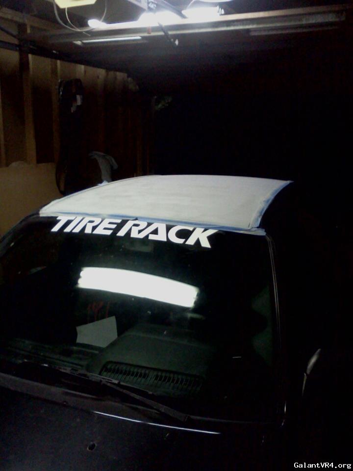

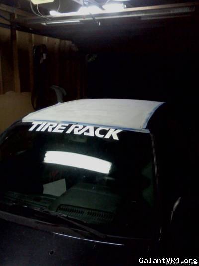

So tonight I finally decided that 619 is too ugly for how fast it is! So tonight I cracked open a couple beers and started getting her prepped! I'll post pictures as I go! If anyone has any tips hit me up! I think I spent about 3 or 4 hours sanding down the rear wing and roof and rear trunk tonight! I feel like I could be sanding forever! Learning to use bondo has been.... interesting to say the least!!!!
Lukefraizer
Jan 3, 2011
157
Fort Collins CO
So the roof didnt turn out so hot so I just ended up putting some primer on her and than painting it up. I'm planning on getting a new roof soon anyways so I am not too worried! The worst thing thus far has been the clear bra and that is finally off thanks to some help from some buddies! Next weekends project is the hood!
