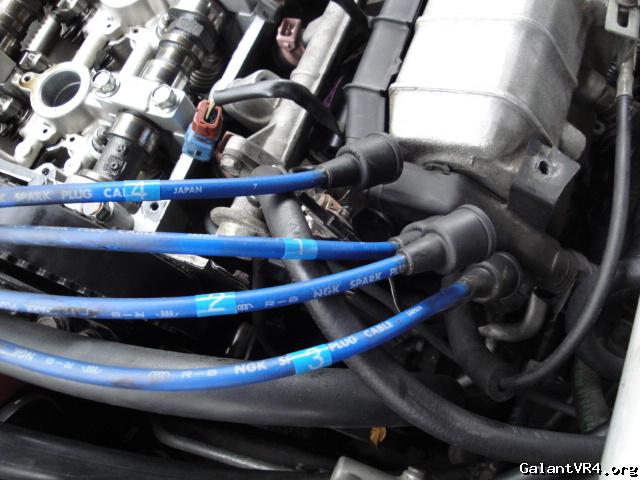

ok so i had to put in a new coil pack, but i forgot to mark were my plug cables plug into the coil pack, my cables are marked 1-4 and i was just wondering if anyone knew what cable plugs into the coilpack

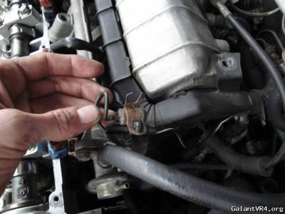

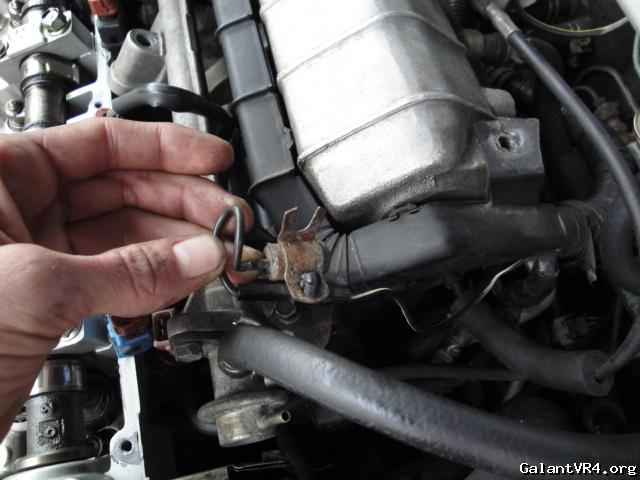

and another question i have is where do i connect this ground cable below? does it connect to the coilpack b/c i remember discnnecting this to tae out the coilpack.

The numbers are printed on the coils themselves. The noise suppressor just needs to be hooked to ground. IIRC its hooked to the intake from the factory.
11,983
That empty hole on the back corner of the intake in the pic is where the noise suppressor mounts.

If the numbers aren't visable on the coil pack, the order is 4,1,2,3. In your picture you have the wires laided out the way they plug into the coil.
ok i hooked up cables 4,1,2,3 to the coil pack, gt new NGK bpr7es, re did the tube and spark plugs gaskets, but she still dsent want to start, im really hoping its nt my cam angle sensor /ubbthreads/images/graemlins/banghead.gif bc what else could it b? /ubbthreads/images/graemlins/confused.gif
