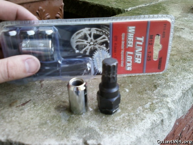

Well, I found the answer. Right at my local Autozone. Cost is under $12.00 for 4 nuts (only need 2) and the adapter.
Works great, have spares, tapered to self center the downpipe and really bites into the flange.

Takes 15 seconds a nut to tighten. Worked great and 3 weeks later, came apart great and went back together easy, just like the first time.
The ONLY thing to warn you about is that the adapter stuck in one of the the nuts and when I pulled the ratchet away, the damn adapter fell and it me between the eyes. /ubbthreads/images/graemlins/banghead.gif Had a black eye for a day and a lump for a week.
