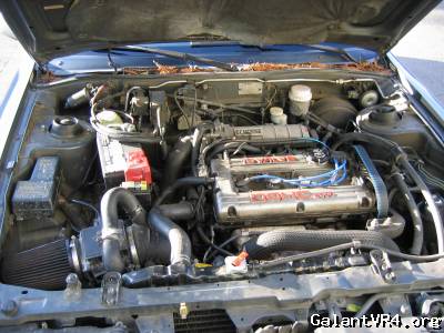

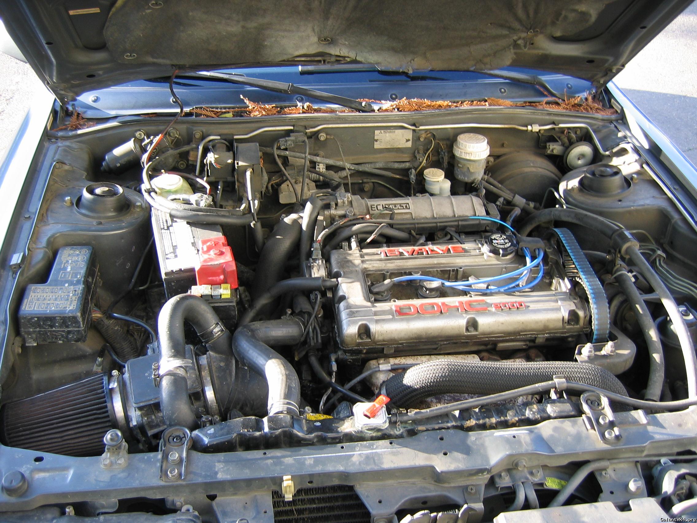

Quoting troyatWORKS:
Nice, could you tell me where the switch is located on the tranny? What it looks like and how many wires it has? THANKS!
It's between the battery and MAS in this picture, you'd have to remove one or the other, but probably not both (depending on how your battery is mounted). There is a bundle of wire that run over the top of the transmission, one wire pops out of it onto the top of the transmission to a black plug, that is your reverse sensor. Unplug it, remove it, add washer, re-install.
LOL I wish it was sunny today. I live out by the coast so we get rain and drizzle all the time today its not raining like I thought it would though, just some sprinkles. Battary and intake have been removed and work is being done... we'll see.
Transmission is fixed, 5th goes into gear like a hot knife through butter. Thanks to all of you who offered their assistance with fixing the issue. It was the switch, it was over tightend and the ball in the switch could not move, locking out 5th gear. Added a washer and its good to go. The ball was not damaged but the area around the ball was mushroomed out so I bought a new switch from SRM today and will be picking it up tomorrow. I did look inside the hole in the tranny where the switch goes and did not see any further damage.
