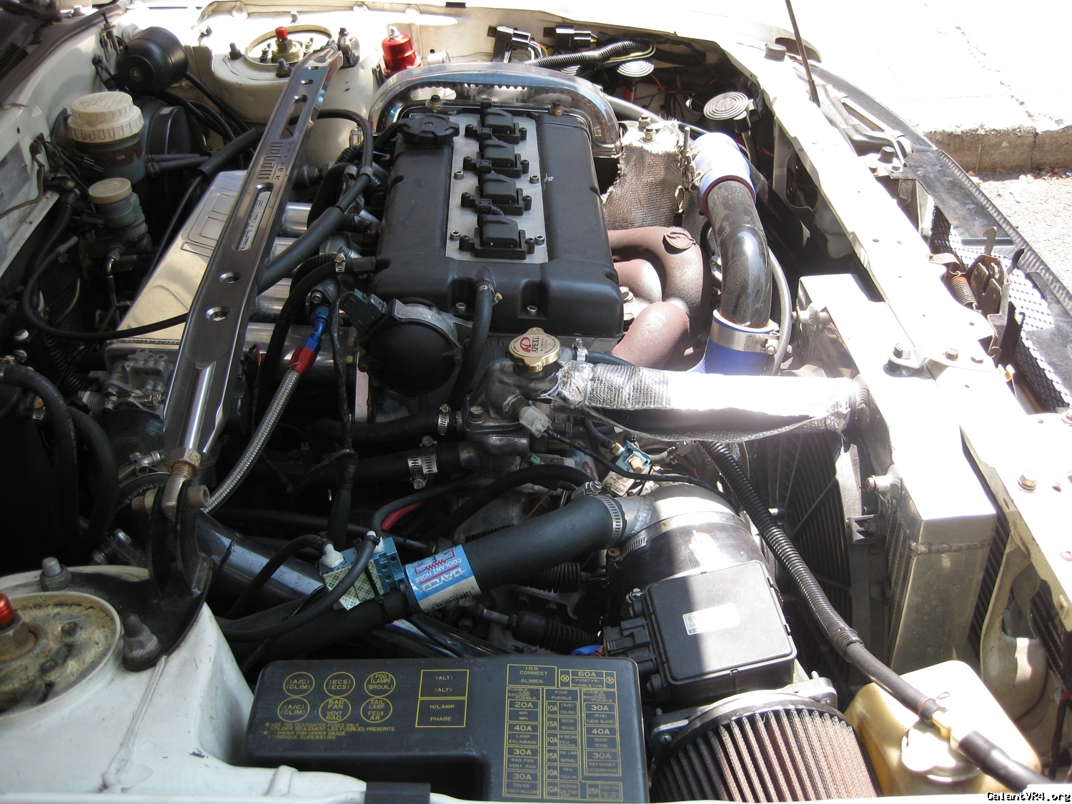

ya brent its the vw scirocco is the one we were talking about. it fits under the rad support, here is a pic of alpha males setup.

Here Is a thread that contains pics of a GVR4 with this particular summit racing "small" type racing radiator. You can even do more searching around the site for more examples but this about sums it up. I'm using the exact same radiator and it does fit perfectly under the core support where the condenser use to be, this is a perfect radiator to use to save space and enable short route I/C pipes to be used with ease.

I use a half size civic radiator. Mine didn't come with a hole to mount the coolant temp sensor that turns the fans on. But since I don't have A/C anymore I moved the sensor to the thermostat housing.

If you look in the pic below the sensor is mounted below the radiator cap slightly to the left. I'm using a 1g dsm thermostat housing and I cut off and welded shut the flange on the civic radiator.
