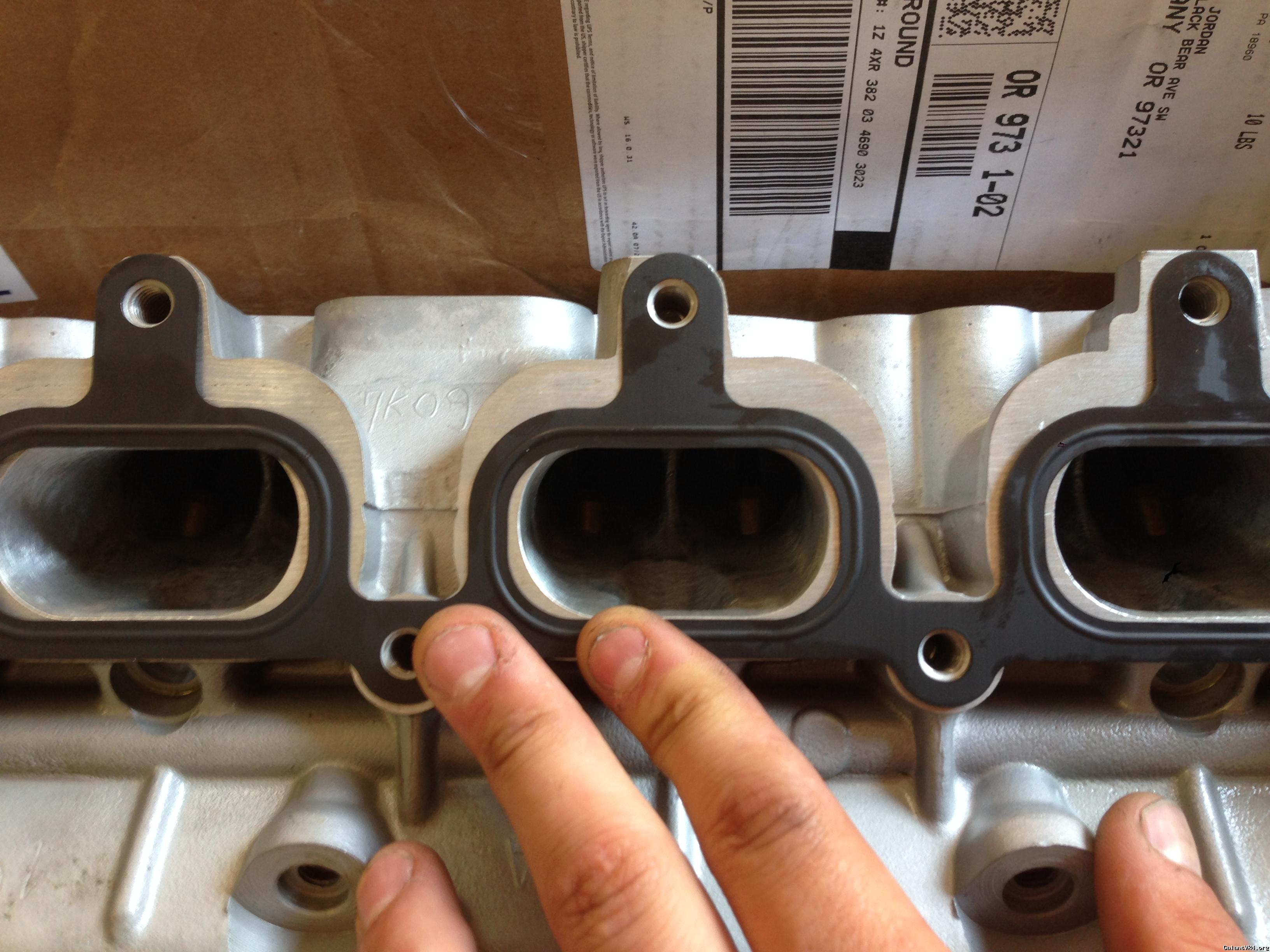

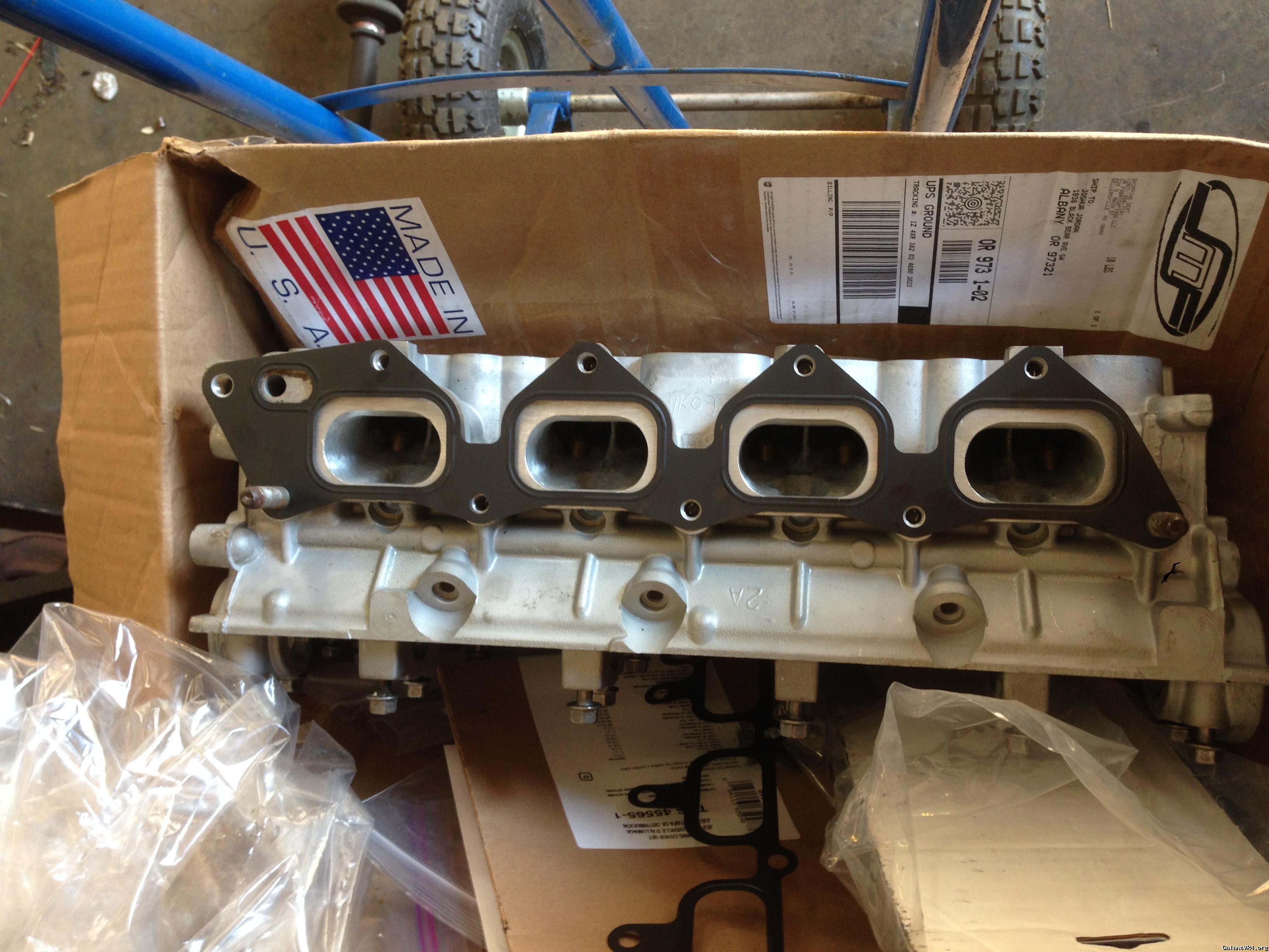

Second part of my problem is that I was mocking up all the parts that I have for the head (2g SMIM etc...) and noticed that the port match on the head didn't match the gasket...problem. I checked the part number and it is definitely a 2g gasket. I check against my manifold which is a 2g, and it matches that perfectly...So basically, I paid for a 2g head to be built to fit a 6bolt motor, and didn't get that either....I got a ported 1g head.

7Bolt Gasket on my head
6Bolt Gasket on my head

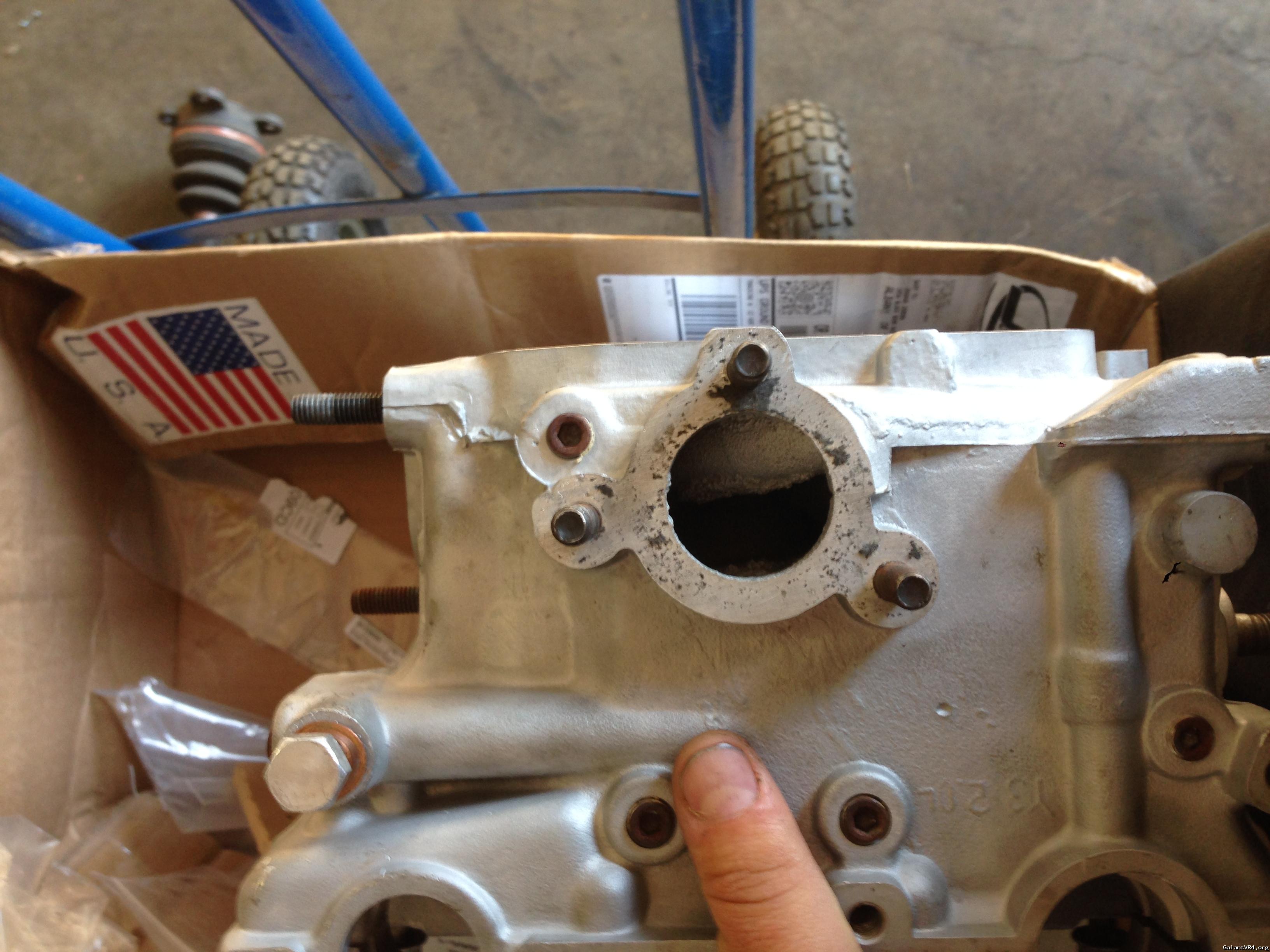

6Bolt style Thermostat housing.

Looks like it's from a gen 3 Sonata with the 2.0L DOHC 4g63. Small intake ports like a 2g, 1g design thermo housing, will have the smaller 8mm outer exhaust manifold studs (unless machined larger) and should have the 12mm head bolt holes like a 1g.
